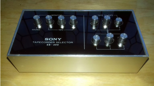

    Great question, I don't know how many work arounds there are if you don't have a monitor switch. Send the signal to another set of RCA inputs (and switch between the source and tape deck to monitor) or listen through the tape deck's headphone jack? Good luck, hopefully he's giving you something cool.

    Simple answer, yes you need a tape loop. The unit linked above by Mister X, allows you to link up multiple tape decks but it still needs a tape loop to work in the first place.
