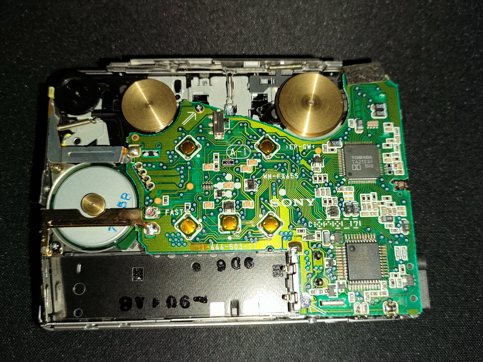

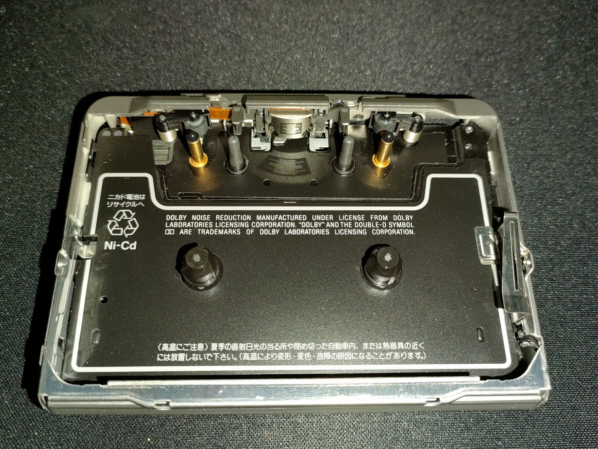

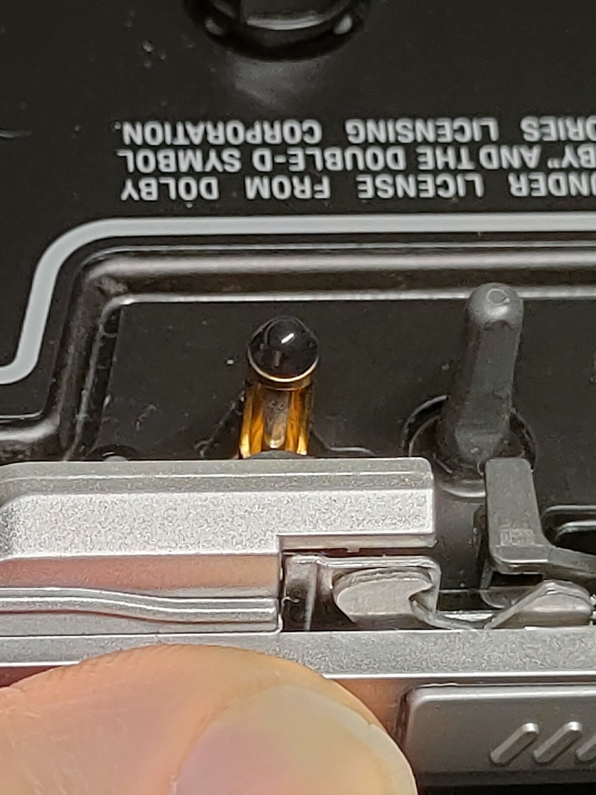

    Dear forum members,
    I had purchased a Sony WM-EX655 which I was told was in much better condition than it actually was. As part of the repairs to get the walkman to work I have completed the following:
    - Replaced the rubber belt with "FixYourAudio" brand replacement for this walkman
    - Reattached one of the pichroller springs (the black one near the centre of unit)
    - I had to bend back the playback head brackets as it was causing the unit to not close properly (I do not know how the previous owner bent it)
    - Cleaned the playback head and pinch rollers
    - Cleans pots/switches with contact cleaner
    - Calibrated the playback speed using Digital Oscilloscope. It seems to fluxuate -0.025KHZ to +0.025KHZ out of range (or possibly even more). There is is also alot of amplitude variation and when I listen to the tone on the calibration tape (3.15kHZ) I can clearly hear this wobble as I can when listing to any tape
    My question would be, what should I try next in order to try eliminate this wobbling noise?
    The DC motor seems to spin freely so I havent taken off the magnet to clean as it seems ok.
    The slipping take up reel clutch shouldnt really be able to cause a wobble as far as I know unless it was not slipping consistantly at the correct torque? What do you think?
    I have not 'demagnetized the head' by the way as I have seen some debate on how useful this actually is to the playback quality.
    Im not sure if it could be something wrong with the pinch roller or capstan. I'll include some pictures.
    Any list of suggestions for me to try eliminate the wobble noise?
    I have also noticed when playing the B-side via auto reverse it plays the other side of tape but with no high end. I only hear low frequency end of spectrum. Im not sure if this is related to the wobble issue or not.
    Its become clear to me now that this high end cut off would most likely because my playbackhead isnt perfectly aligned. It would not be picking up all of track 3 and track for (left and right of b-side) completely. At least I'd assume this. What do you think?
    In the meanwhile I will try process the signal of each side in XY mode on oscilloscope to look for perfectly diagonal line on each side
    After playing around with it some more and bending back playback head I've noticed a repetitive cutting in and out sound about 500ms apart. On closer inspection I think theres a flat spot on the b-side pinch roller. That would explain it I think. Edit: actually the pinch roller seems okay so I dont know why its doing that. I'll clean capstan and pinch roller while in play mode to clean all sides with door sensor forced down tomorrow at work. I just cleaned thoroughly, still clunking. Anyone know how to remove the pinch rollers on this model? I was going to swap them around to see if it moves the fault to the other side

    Demagnetizing the head won't solve the lack of HF, as it's a problem that exists only on one side so it's a tape path problem.
    Head azimuth is non-adjustable on these units, lack of HF can be caused by: head wear (unlikely), bent head bridge (you mentioned you straightened it) or tape curling at the roller (most likely).
    Assuming you don't have a mirror tape, try to observe the tape at the capstan/roller (remove the frame if necessary), see if it moves up or down after the roller engages.
    Swapping the pinch roller with other side is a good test, but keep in mind alignment problems (roller not parallel to capstan on vertical axis or at an angle on horizontal axis) can also cause the same problem.
    The high W&F may or may not be related to the tape path problem. Given the high W&F/speed variation exists on both sides, it would seem not related.

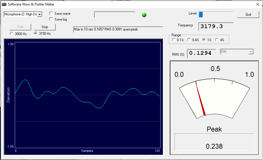

    Do you have a WFGUI screenshot of the measured W&F ? 25Hz speed variation is high.
    In regard to potential causes of W&F, on these series are:
    - cracked clutch gear: https://stereo2go.com/forums/threads/wm-ex-series-tac-tac-sound-repair.7108/
    - wear on the motor bushing; fact motor is spinning freely doesn't tell much, you need to check lateral play;
    - wear on capstan bearings;

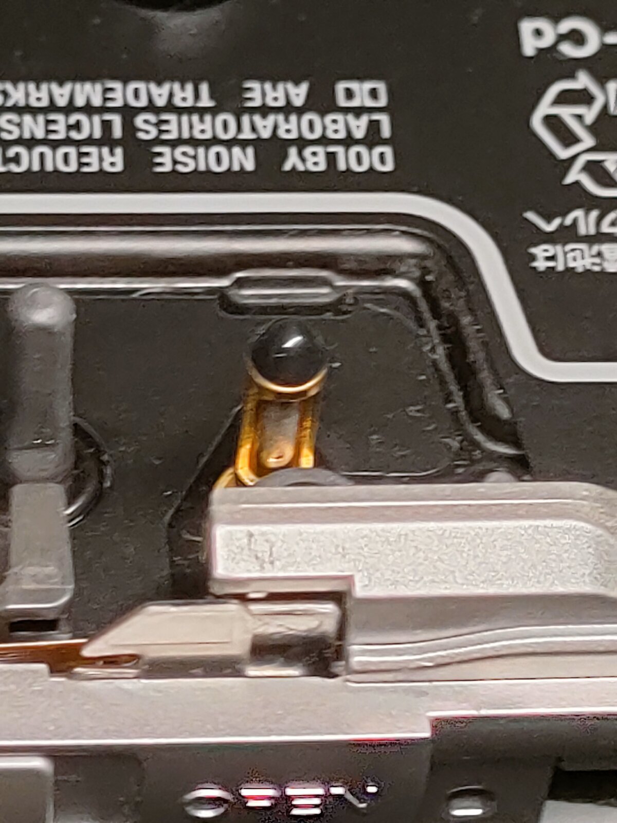

    Hi Valentine. Thank you for the advice. For the pulsing noise problem on only the b-side auto reverse playback, I have taken the plastic frame off for a good inspection and I can clearly see the pinch roller is bopping back and forth during playback the with b-side capstan. I feel no play on this capstan pully so I think it may be the pinch roller. I have another EX655 so if I can lift up pinch roller bracket, I'll swap it with this other one I have to rule out faulty pinch roller. I'm not 100 certain the other ones pinch roller is healthy but it doesnt bop back and forth like that
    This is a video showing the bopping and if you turn on audio can hear the pulsing along with the tone on the test tape
    Update on pulsing noise issue: Switching over pinch roller (with bracket) from my other unit solved this so its definenly the roller.
    For W&F analysis (on common a-side and b-side playback), I've been using my Siglent Oscilloscope on normal waveform mode and also XY mode. Its not producing a linear line on XY mode so somethings not right. The gear does not seem cracked but I haved ordered a new one and when it arrives I'll be able to rule out the clutch gear (this is assuming the clutch internal mechenism is still ok as I only ordered the outer plastic gear teeth. On the motor it spins freely and I see no lateral play at all. Simmilarly I see no lateral play on the capstain flywheels. This confuses me to what the problem could be. Perhaps its the clutch
    Im going to spend some time learning WFGUI and then I'll upload some screenshots
    Update WF screenshots from WFGUI
    - A-Side
    - B-Side (auto reverse) Capstan 2
    Deviation seems to be around around 20hz max on A-Side and 13hz max on B-Side. (Assuming I calculated it right. 3150hz * (deviation (0.006% max for A-Side, 0.004% max for B-Side))

    As far as the W&F goes, figures are pretty typical of this mechanism. FWD side has higher W&F because it also drives the geartrain.
    The clutch gear, as long as it's not cracked, don't replace it.
    Things you can try to improve the W&F are: lubricating the capstan bearings, motor (have a tutorial for that, but keep in mind it's tricky) and eventually try a DeckTech belt instead of the FixYourAudio one.
    But at the end of day don't expect getting a 0.1% WRMS figure on this walkman, it just won't happen.
    Question is: do you hear W&F with music ? Fact you hear it with test tone doesn't mean much, as with a constant tone it will be audible even at very low values like 0.04%.

    Sorry for the misunderstanding. I wasn't testing for azimuth anymore as when I bent the playback head back I no longer am hearing a noticle cut off on the high frequency end. I also do not have have a 10khz test tape unfortunently (but only the w&f 3.15khz calibration tape)
    Regarding the XY test I was conducting on the oscilloscope: I was not only really looking for any phase shift between the left and right channels also any ampliitude imbalance between the channels.
    - if there is a phase difference between the 2 channels it will show a tilted ellipse on the scope which points to a azimuth alignment issue.
    - if the channels are in phase but the is amplitude imbalance it will show a horisontal or vertical ellipse apparently
    I think I will leave the azimuth alone for now like you said as the auto-reverse side is playing nice now with the new roller.

    Regarding Lissajous curves, there are many patterns depending on phase and frequency difference between 2 signals (in case of test tape there is only phase difference): https://en.wikipedia.org/wiki/Lissajous_curve
    For azimuth, the amplitudes need to be maximum and also in phase. But a full-track (recorded with a mono head) tape is required for that, otherwise the recorded L/R signals may not be in phase to begin with.
    Check if head is parallel to the mechanism chassis visually (with door removed). If that's the case, it's ok.
    Some amplitude variation is normal at higher frequencies, it's analog tape after all. Not sure how much of a variation there is to tell if it's normal or not.
    The black caps on the capstans are just cosmetic and for the tape not catching in sharp edges, there is a split washer underneath that holds the actual capstan.
    Make sure to lube both bushings and clean the capstan thoroughly after otherwise your tapes will get contaminated with oil.
    You can try replacing the pinch roller on FWD side, although given that's what drives the geartrain, the higher W&F is more likely related to that as previously stated.

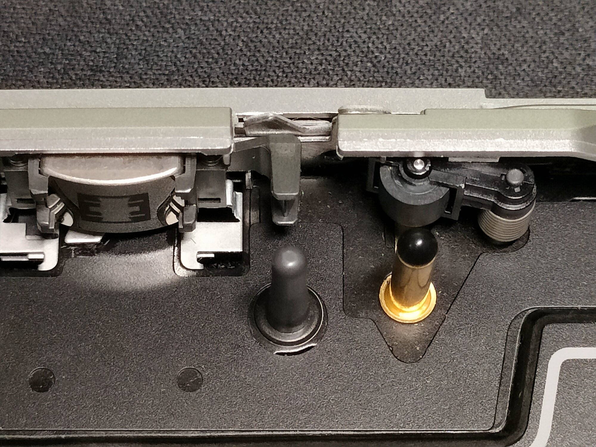

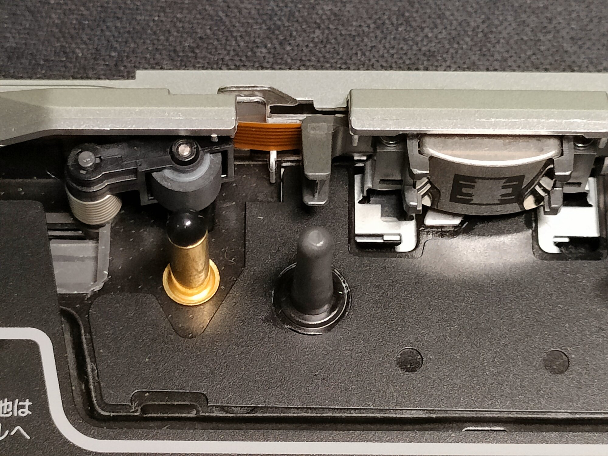

    He playback head surface was not completely parallel with mechenism chassis and capstans. I've straightened it a little more. The first tape I put in got tangled up. Im not sure why that is lucky it was a tape I didnt really like. the subsequent tapes have been fine.
    I've made some videos on oscillscope playing the 3.15khz tone:
    Voltage / Time Forward
    Voltage / Time Reverse
    XY Forward
    XY Reverse
    My observation on the xy forward is that I see a near perfect circle and for the xy reverse I see a tilted ellipse.

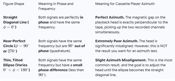

    Based on what google gemini has regergitated to me this means the following: (I know gemini is not as accurate as a pro such as yourself but interesting to see what it says)
    Based on it's response, it sounds like my bench mark should be a straight diagonal line. So my forward playback is currently extreamly bad and reverse playback is a little better. I think I must have it bent back too far.
    I had another look and noticed it still wasnt perfectly parallel so I bent it some more. This has definently helped as I am now getting a tilted ellipse in a much less circular form. Or better way to put it, im getting closer to a perfectly linear line.
    XY Forward 2nd Adjustment
    XY Reverse 2nd Adjustment
    I'd say if I kept bending it it would eventually be close to a linear line (perfect azimuth)

    Yes, as stated in previous post in phase --> 45 degree line, but:
    1. You need a full track test tape (meaning recorded on mono head);
    2. On such a unit you won't get a perfect measurement anyway;
    For this reason I would bend the bridge to look visually perfect.

    Replacing only the rubber tire I do NOT recommend, because almost always such roller assemblies become eccentric.
    Generally speaking, don't recommend replacing the original rollers unless it has a problem like indentation mark, it's not round, rubber is hard as a stone, etc.
    You can try the FixYourAudio ones, like this: https://fixyouraudio.com/product/sony-wm-ex560-pinch-roller/. They're not listed for each individual model, but are the same.
    Or if you want to search more options, the dimensions are 6 x 5 x 1.5mm (outer diameter x height x pin diameter). Note height is the total height, including the hub.

    Today I recieved watch oil so i removed the forward capstan, cleaned bushings with ipa and lubed them. Interestingly in the software W&F metre it seems to believe things have made things alot better. I recalibrated the speed and now the forward and reverse is about 30hz apart. There is also much less variation in pitch and it seems to start up fairly consistantly each time so a huge improvement! It seems to have been the problem
    Thank you very much mate. Some of my tapes like my very old personal recordings have a bit of W&F but it must be the tape stretched.
    I have one question: how do you usually remove the slit washer that holds the capstan on. I used a flat head screwdriver and bent it out but it doesnt seem like the best way as i bent it a little bit. It didnt come off nearly as eaisly as the clutch slit washer for me.

  18. Valentin
    1,956
    30Hz difference can be considered in spec. Even the manual gives +/-1.5% REV speed differnece, which means 45Hz. 30Hz is just 1%.
    Yes, W&F can be caused by the cassette itself: if hubs are warped (and tape doesn't spool evently) or slip sheets are worn, you will have ecessive friction.
    It also depends A LOT on the music you're listining to. That 0.13% figure shouldn't be audible with any music, while the 0.22% will be noticeable with some genres (which have long note decay), but not so much with others.
    As for removing the washers, I usually press on one side with a fingernail, while pullin on the opposite side with a pair of tweezers.
    However it's hard to remove them without any bending, if it bends just bend it back before re-installation.
  19. TP86
    TP86 Member
    49
    Melbourne
    I just read the manual and found the part your refering to. Yep thats true so it seems like the variation between forward and reverse is all good now. I would say the W&F 0.22% is not desirable but not all that bad. I'll think I'll leave it for now. Thanks mate! Oh it sounds like I did the capstan slit washer removal as good as possible then. I was a bit concerned they bending may damage it. I eventually got it to click back in
