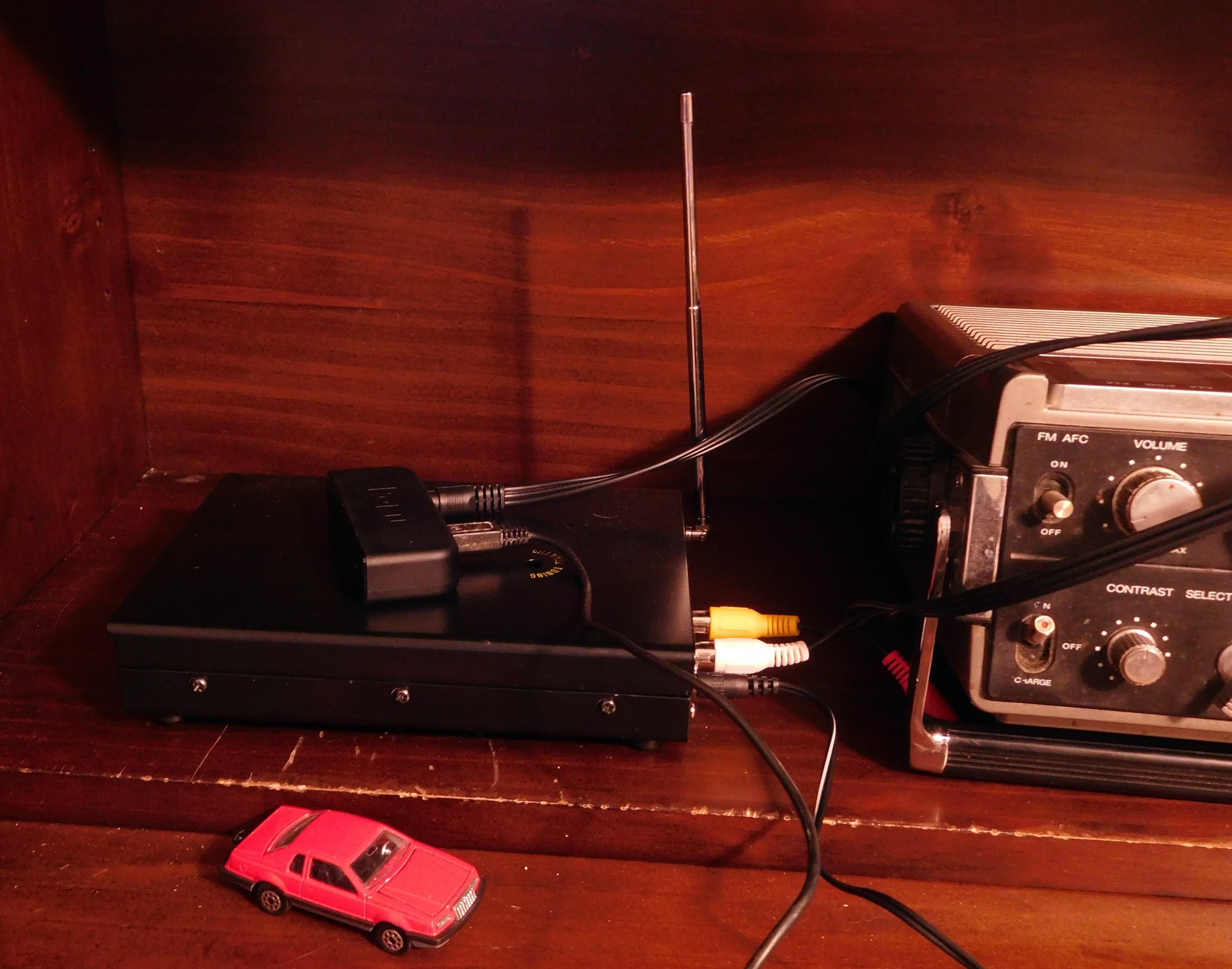

    I jumped the shark with the Zealous Unit (hopefully) and moved onto a Blonder Tongue Agile Modulator Stock # 59414, Model # AM60-550A. I read about this on Phil's Old Radio Website https://antiqueradio.org/HomeTVTransmitter.htm
    I don't have it hooked up yet so I'm a little premature, the unit has a threaded cable coax video in so I had to order an adapter which should be here any day. This unit is much larger and rack mountable, the company is still in business and I think they sell these to companies that used to broadcast TV throughout buildings (just one channel). I haven't heard what the range is but there is a jack for an antenna and some internet sites say they can broadcast about a city block. Someone really creative could power this in a vehicle and then broadcast to a portable TV set without anyone else knowing, I'd love to walk into the local water-hole with a game on my Watchman.
    nickeccles and SantiOriginal like this.
    14,305
    The RCA to cable coax arrived and I hooked up the Blonder Tongue and it works great. At first I wasn't getting any signal but I found an old set of rabbit ears and hooked it up to the RF out coax connection. The nice thing about the Blonder Tongue is that you can put in any channel using the DIP switches, I choose channel 6, hopefully my neighbors aren't getting Cinderella Videos from YouTube on their TVs. While the picture is same quality as the Zealous, the sound is 10x better. There's some tuning screws on the front of the modulator for video and audio, by tuning these you can fine tune the signal. There's also a tuner for video to audio strength to help balance the sound. Now I just have to build a bigger antenna and see what this thing can do.
