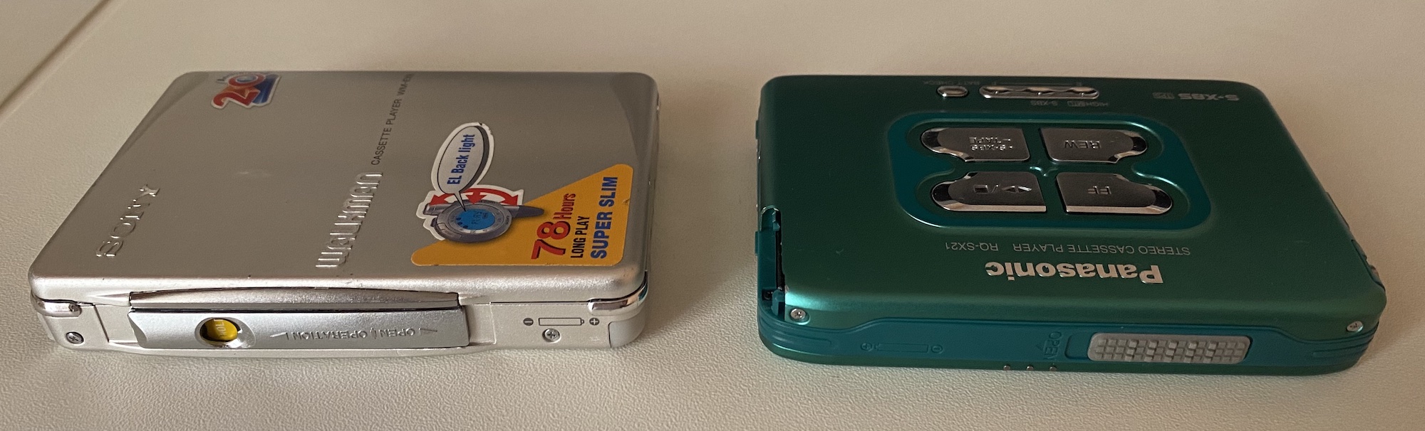

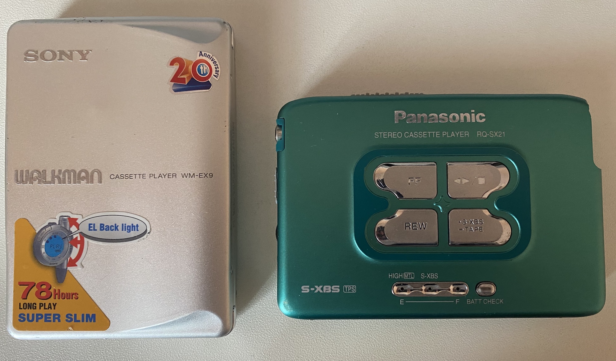

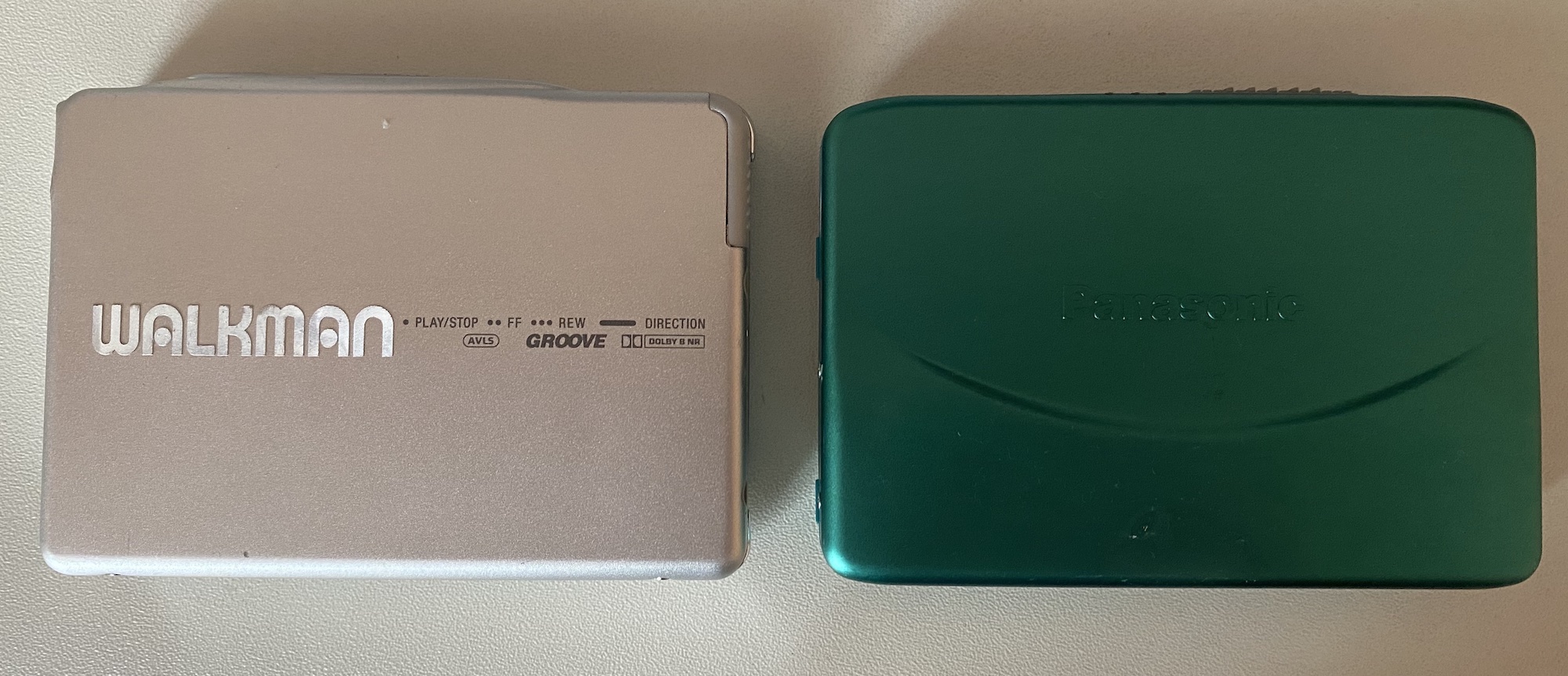

    Todai I think I got a good deal and bought a Sony WM-EX9 and a Panasonic RQ-SX21 ("as is", "condition unknown", no accessories) for 20 EUR total.
    The WM-EX9, to my total surprise, just worked: I open it up to check and replace the belt but indeed the original one is still perfectly ok. I just connected a battery holder and it started right away. Unfortunately this model originally came with a fancy remote with LCD which allowed to set Dolby and XBS/Groove. The main body has a single button which act for the usual transport commands; it works also with a standard walkman remote, but I do not have a compatible one which allows me to enter its menu and set Dolby or XBS. I tried minidisc and discman remote with LCD but they do not work. The main body is also missing a volume knob, there is just a switch with three positions (low, mid, max), very odd design.
    The RQ-SX21 has the usual problems of this kind of transport: needs new belts and the clutch retainer is cracked. On top of that it also has the capstans with the rubber bands to improve grip: the rubber seems still fine, but I had a vary bad experience with that in the past and the bands might disintegrate any time soon. It is a mid range model, with no Dolby, I am not sure it is worth spending the money to fix it. I really like the colour though ... (The battery door cover is not missing I just removed it when I took it apart).
    Both walkman's have signs of wear on the body, both have signs of corrosion in the gumstick battery terminal, but overall nothing too extreme, and nothing is broken.
    Some pictures of the two units
