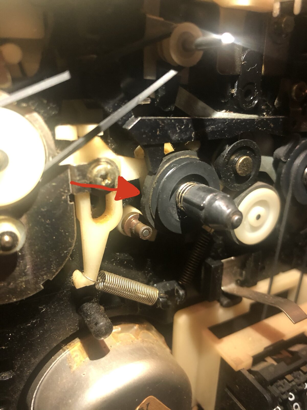

    Plenty of torque. Same with the pinch roller.
    I did find that one wheel had some dented rubber. See photo. Not sure if this is an issue?

    Did you check DC voltage to the motor? It should be 9V. Motor running too fast does not sound like a burned motor to me, but who knows...
    Do you have any working cassette player to compare with TRK5190? What you described does sound like a simple mechanical problem.

    If there’s any residue on the belts, could that cause an issue? I’ll check the voltage of the motor, not entirely sure how though?
    I have a Marantz 5000 cassette deck that I used to compare the speed. That and streaming.

    - What I meant was to have one working cassette mechanism to watch what happens when it works properly. Another option: you need a 'sacrificial cassette' (select carefully, because it Will Be damaged and do not blame me afterwards!). Disengage pickup reel, the one with dented rubber... how you do it is your choice. Play 'sacrificial cassette': before it gets all bearded and jams the mechanism you will have a chance to listen if capstan/pinchroller do their job without extra pull from the pickup reel. If you are quick enough (say 5-10 sec) then cassette won't get chewed too badly
