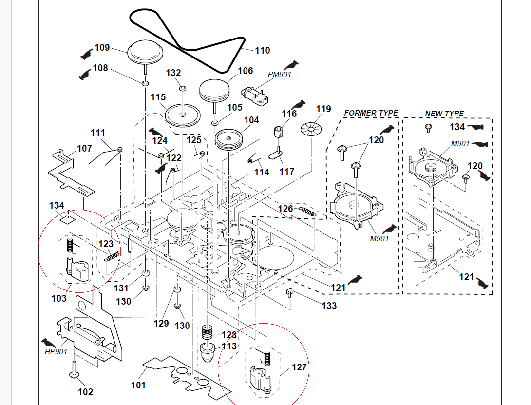

    I've been trying to figure out how to remove the pinch rollers on the EX655. Has anyone experienced by any chance serviced one of these? If so could you please let me know how I can detach it

    After watching a few videos on this unit, none are changing out the rollers. Nonetheless, on the bottom of 127 and 103, you can see the outlines of c-clips. Remove that tiny c-clip and the roller should slide out.

    Pinch roller backets simply pull up, but there is a bit of force required.
    Use a flat screwdriver underneath the bracket to pull the roller bracket up.

    Thanks guys. After taking frame off it lifts up very eailsy! I just used plsatic screw driver to prevent scratching anything and it worked
