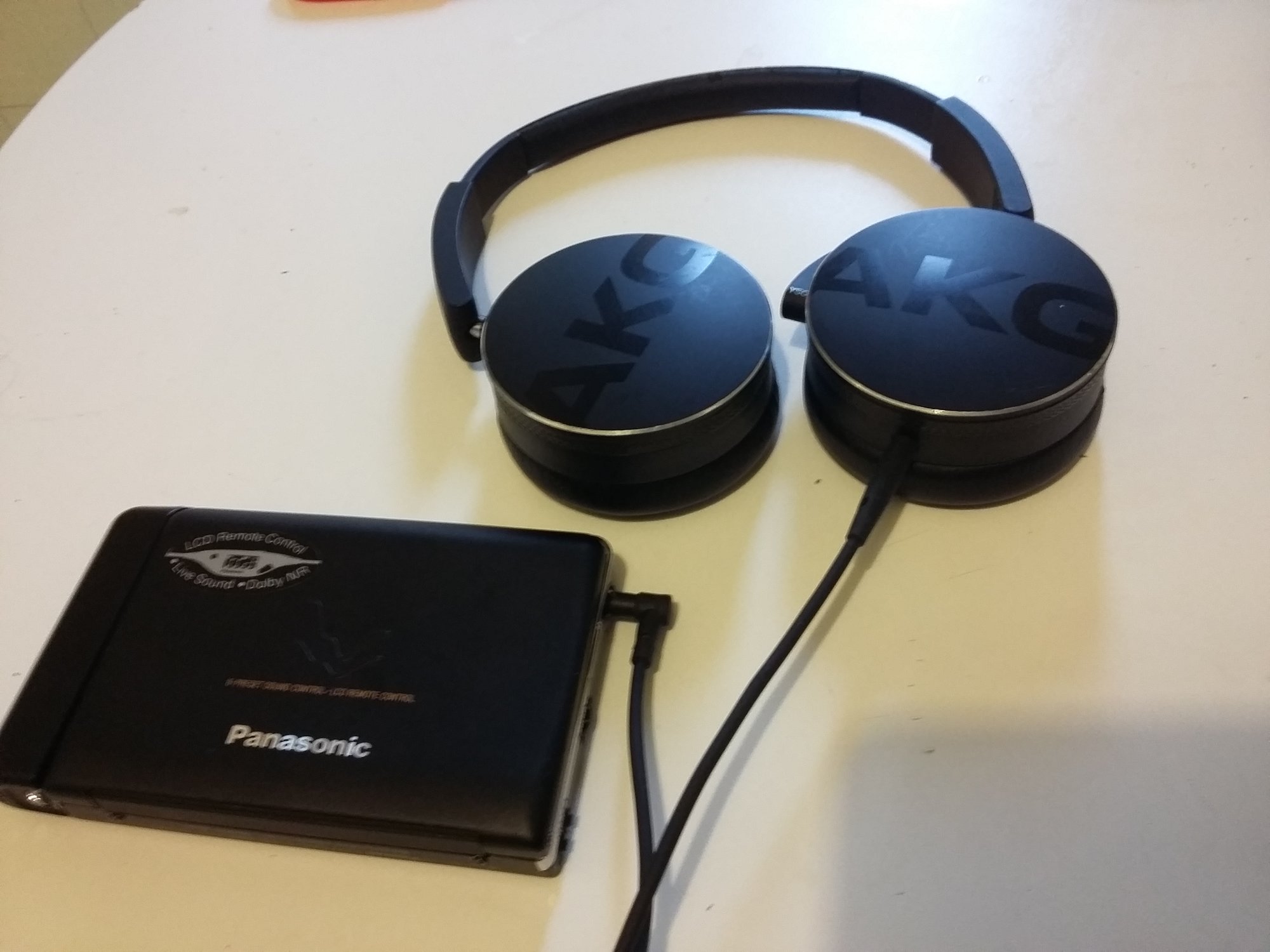

    Good news, i received the panasonic <3 it sounds amazing with my AKG Y50's.

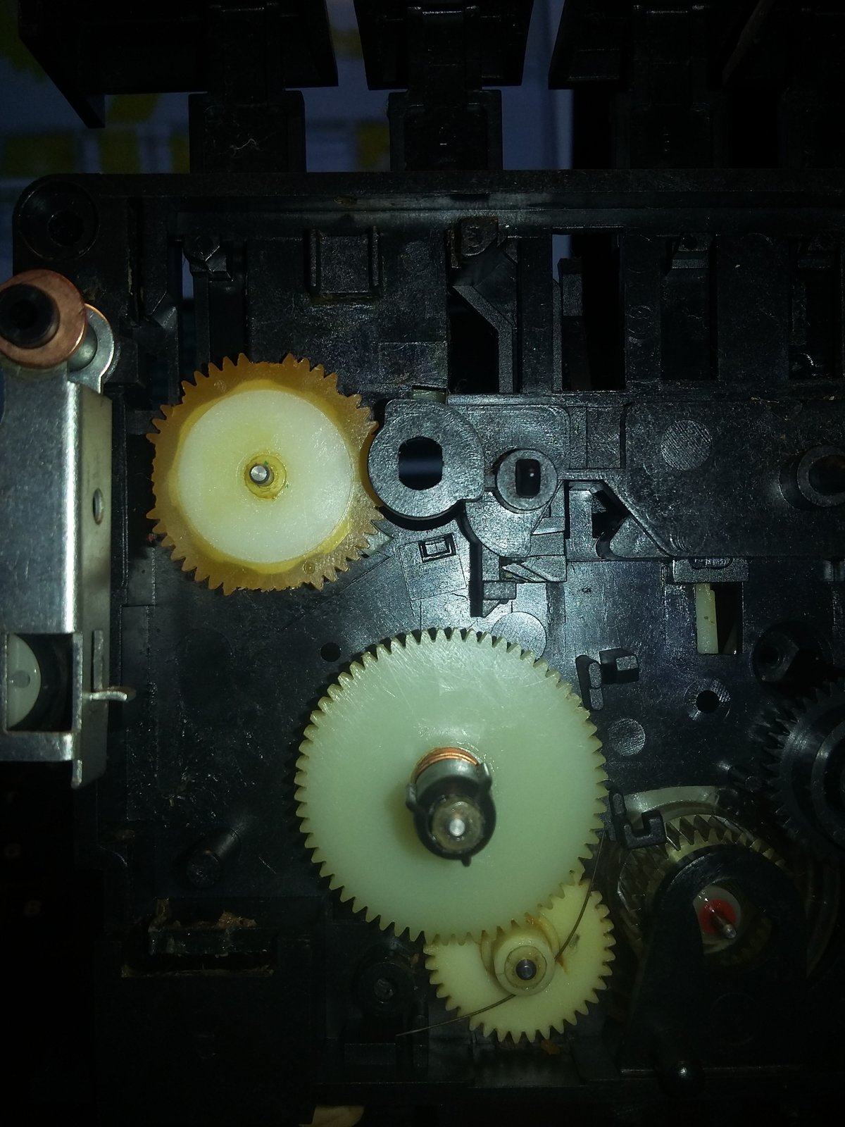

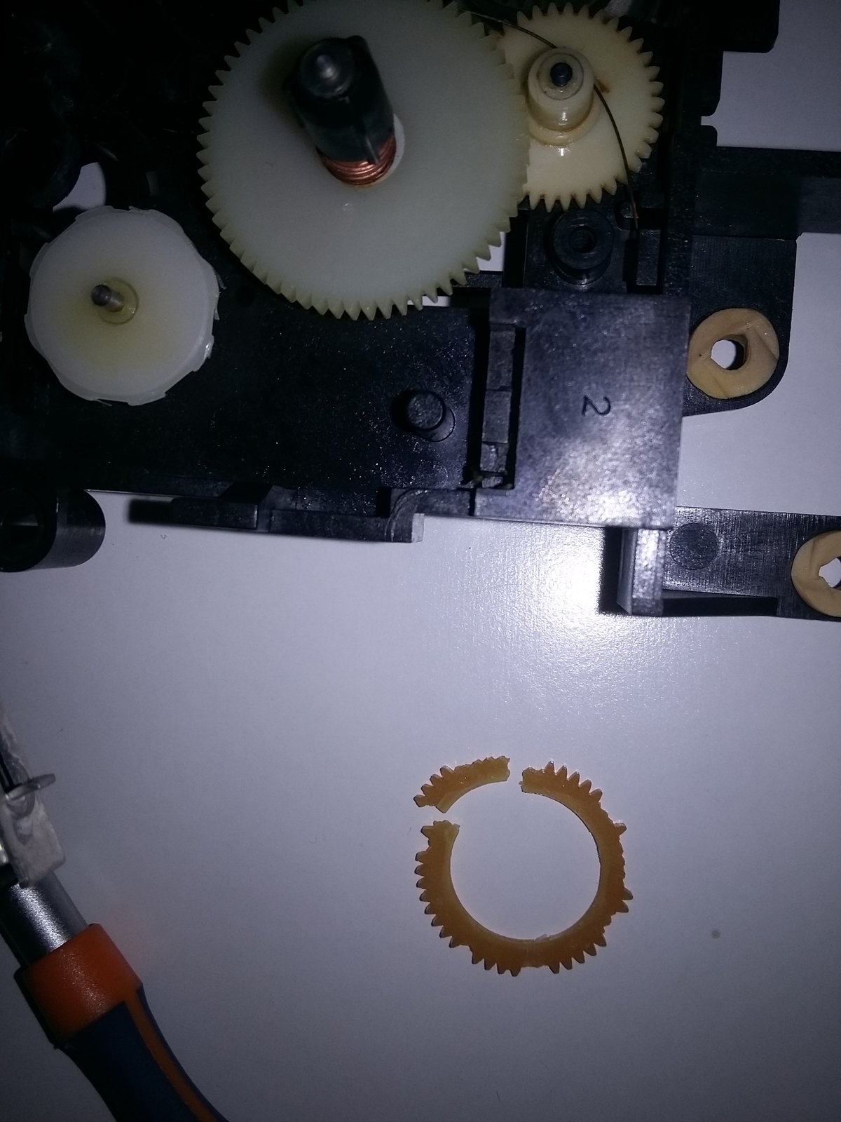

    Hello everyone, I hope you all had a merry Christmas and a happy new year. It took me a while but i finally disassembled and got to the bottom of the problem with the phillip. as you can see in the pic related the gear has deteriorated.
    if anyone knows where i can buy or make a replacement gear, please reply.

    Analog Audio is much better than digital. You will realize it when you listen to higher end analog divices. MY DD9 or DC2 sounds much better than my Ipod. There is a video clip compared a DC2 to CD player done by Hugo and i hope you watch it to compare it yourself (imagine that a CD sounds much better than MP3 files).
    anyway, It is a big disappointment by looking at the broken gear of your walkman. How can a gear get these kind of extensive damages? for a small damage i would think about getting a broken walkman and replace the gear but sounds like this part is not very sturdy and you might think about a possible 3D printing option. It is just my personal opinion and i hope to hear a better suggestion from other members

    Not sure if it is related, but it looks like a similar problem. Many Philips tape deck's have a bad reputation due to a failing gear: regardless of how you treat them, with time the gear will fail rendering the tape deck's useless as spare parts are no longer available.
    My Philips CD player too had a similar issue with the tray mechanism where a gear broke to pieces for no apparent reason. At least for the CD player I could find an ebay a third party replacement and it has been working flawless ever since.
    Maybe it was bad material engineering or deliberate planned obsolescence, but it looks like several Philips devices have faulty gears.

    from what i can observe the material of the gear isn't hard plastic like every other component but rather a rubber like element, so I assume planned obsolescence, i could be wrong since this is the gear that transfers the kinetic energy from the gear powered by the belt.

    the gear only broke when i tried to get it out. I think they used resin. I had to get it out since every test play a teeth was coming out. Ill try to explore 3d printing, luckily my university has a room full of dedicated 3d printers.
    I did my research and was able to find the mechanical part number from an exploded drawing.
    4822 522 10138
    are there any search engine where i can find this exact part and buy a replacement?

    Exactly like the tape deck's, it's a sort of rubber that over time deteriorates until it breaks. Maybe it was intended as a fail-safe element but indeed it is making several 90's tape player from Philips very hard to repair or service.
