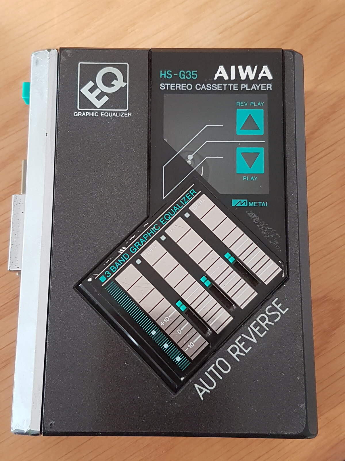

  7. RTB
    RTB Member
    46
    Berkshire, UK

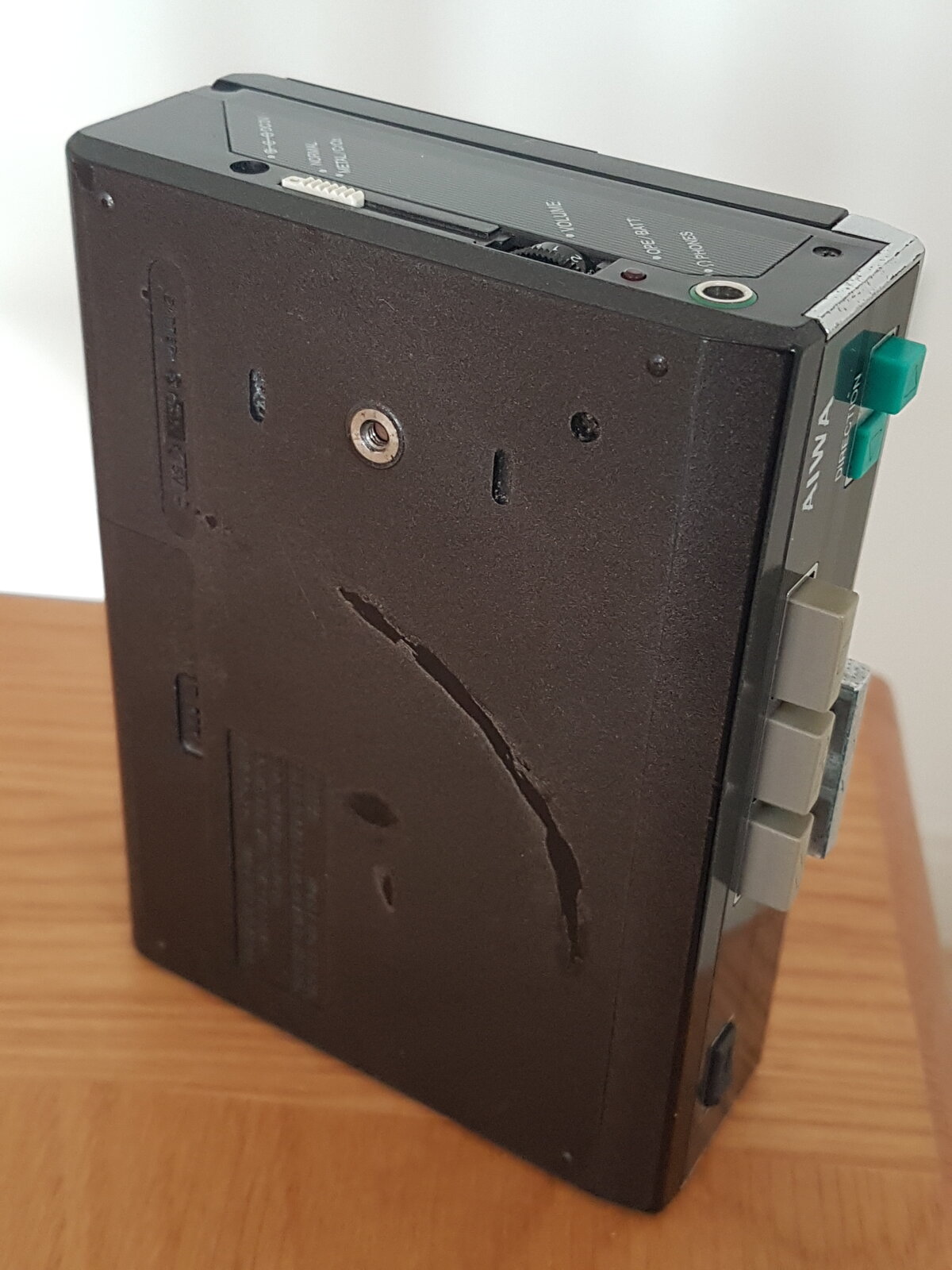

    Hi @syndicalex
    Do you have any update on what you did to your HS-G35?
    I recently bought one in working condition but it does have a few marks on the back of it and the paint has worn away - probably from the now missing belt clip.
    Has anyone got any advice on how to repair / paint the back case - or just leave it and try to hide it with a belt clip:thinking: Or just sell it on :) 20210118_120921.jpg 20210118_122320.jpg 20210118_121038.jpg
  8. Boodokhan
    2,477
    It is almost impossible to paint the scratch sign of gray color plastic plate (black metal plates are ok), It will be visible no mater what you do. You can still paint it and make it less obvious.
    The only way you can make it perfect is if you use airbrush and paint the whole back plate with the right color.
    RTB likes this.
  9. groundlessfears
    groundlessfears New Member
    9
    lahore
    You can fill this part with some good filler, I used to fill these with Epoxy, or use any Good A+B Glue which dries fast, then file it with sandpaper to make the surface equal, and then spray paint it. i have fixed many damaged plastic parts like that.
