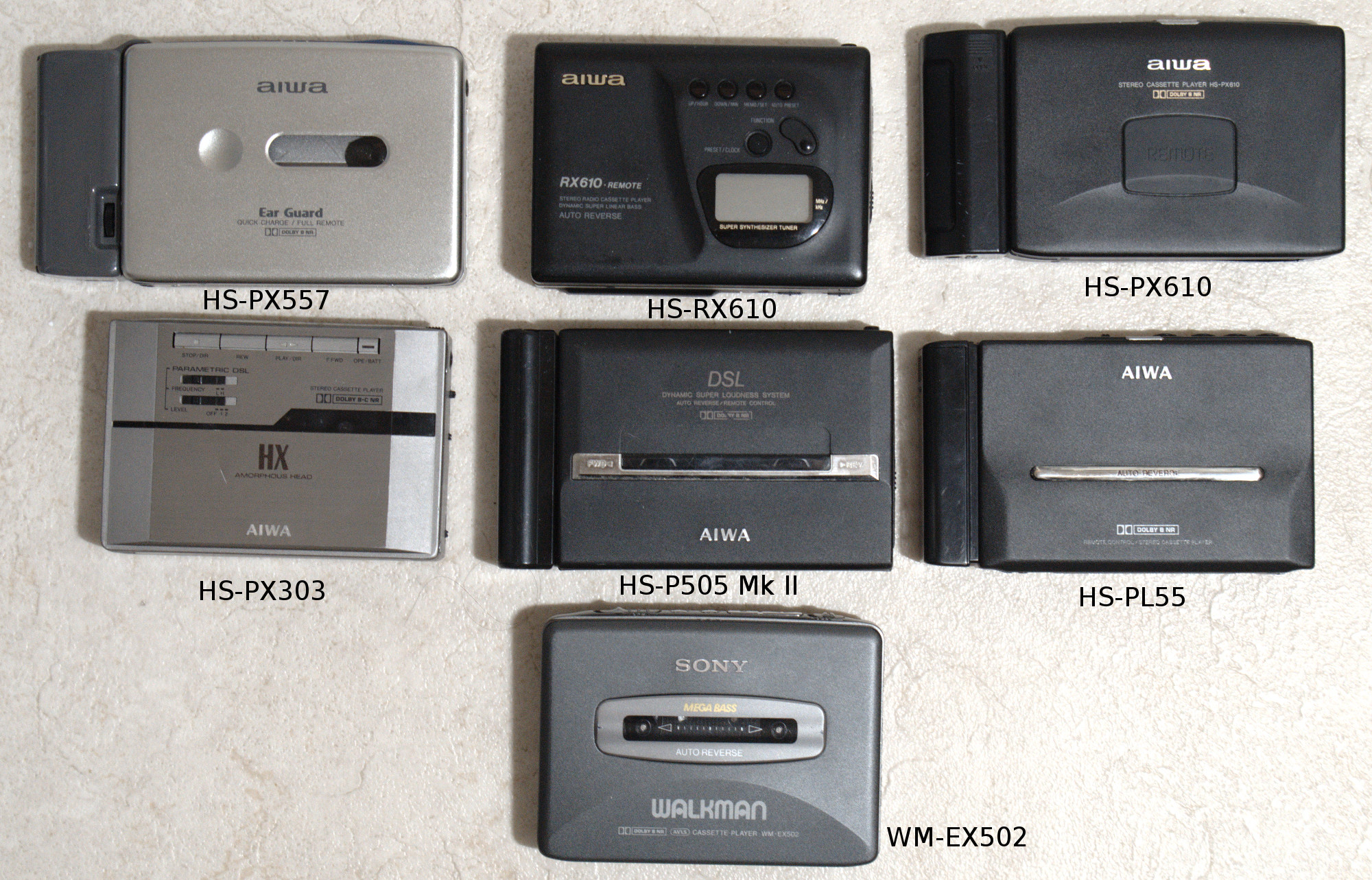

    So... this is what we're dealing with...
    HS-PX557 - Unit is working, but likely needs a recap and acid clean. Also azimuth and speed checks I wouldn't mind betting.
    HS-RX610 - The radio works, but the tape doesn't. I suspect the belt. Also, the usual caps, acid, azimuth and speed.
    HS-PX610 - Sold faulty, tape stopping, so it's going to be caps, acid, azi and speed, possibly belt while I'm in there.
    HS-PX303 - Currently de-capped waiting for the order to arrive in June. Has been acid cleaned.
    HS-P505 Mk II - Has been acid cleaned, re-capped, belted and is currently working nicely. Sadly, I used tantilums in there for the rare caps, but they'll get changed out most likely when I get others working well.
    HS-PL55 - Working, but needs the usual acid, caps, azi, speed and a belt if I can find one.
    WM-EX502 - Working, but sounds muddy. Will throw the usual at it and that should bring it out.
    I have the service manuals for all of them. The PX610 is just waiting for me to assemble the images into PDF format and that will also be on the forum service manual collection in a day or two.
    Of course, there are two other HS-PX303 units currently under the care of Marian. Only time will tell on those units now.
    Next step will be to take them all apart and see what caps they use.

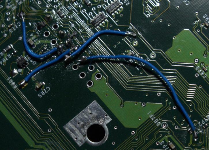

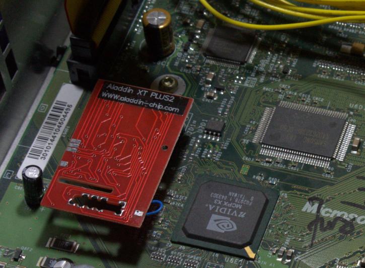

    So, I've been quiet... but I'm not doing nothing... I'm hardware modding three backup Original Xboxes while I can still get the parts, and when that's done I can safely overhaul my original, original xbox which desperately needs cleaning and a CPU paste change. Once these are out of the way, then the bench will be clear to look inside the walkman collection to see what caps are needed. If you want to know more about that, I created a small blog post here - http://msknight.com/technilife/?p=832 - but next post here will be back to walkmans in a week-ish, at a guess.
