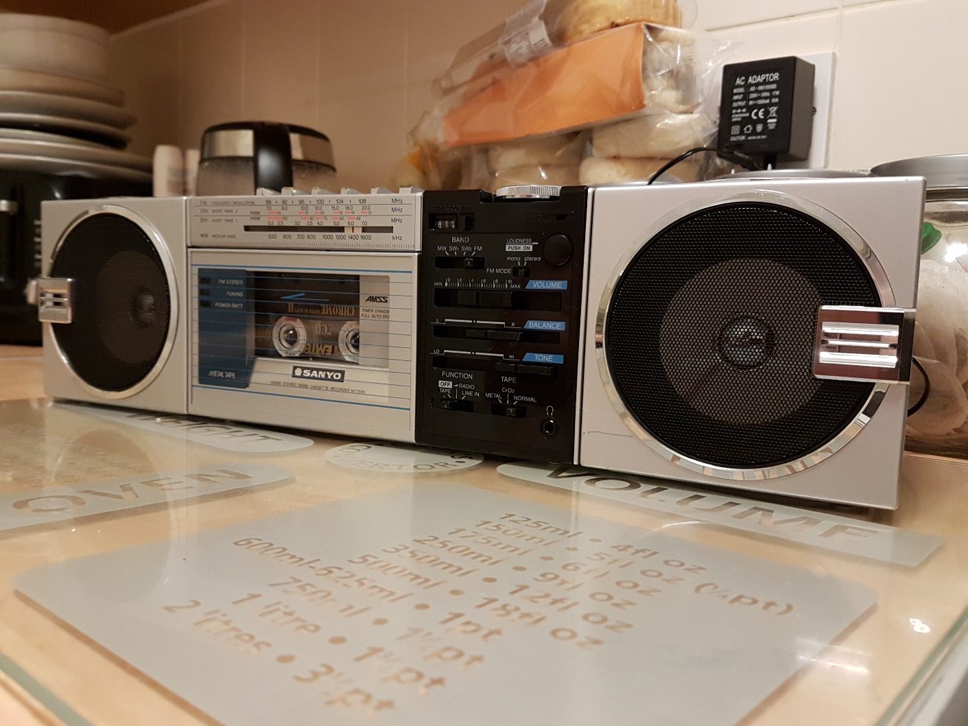

    Arrived well packed & as seller stated it was crackly on volume & dirty!!
    Well I didn't need to open it up, just Servisol in the sliders & switches, cassette door removed to polish up the heads & pinch roller (very yucky) & a really good cabinet & speaker clean up!!
    Time to test on headphones while Big Tits cleaned the speakers up - I was very disappointed with the tape playback, very dull & woolly with a poor frequency response :( :(
    Now when you repair these things as long as I have, you usually have an idea what the problem could be :iconconfused:

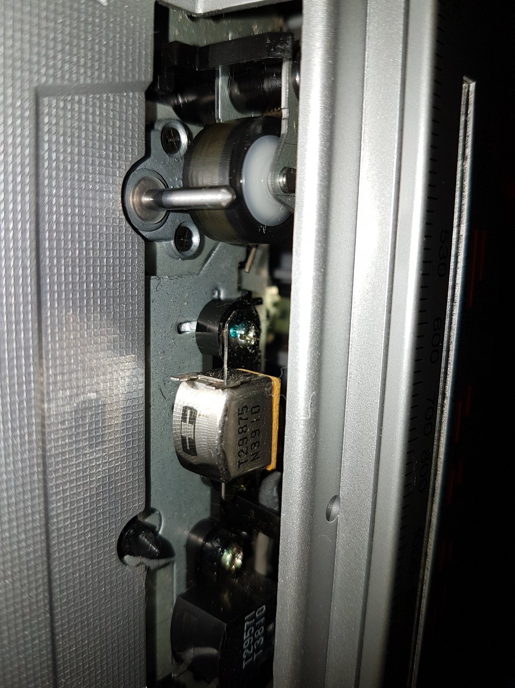

    I thought surely the azimuth can't be as far out as to produce these symptons???
    It was over 4 full turns out, the locking screw received a tiny dab of locking glue after adjusting & cleaning the head again!!
    So far an easy Saturday I pondered as I refitted the cassette door not realising the best was yet to come!
    These stereo's are simply stunning, not only does it look gorgeous now with only 1 tiny scratch on 1 speaker, it sounds f**king amazing :headphones: :headphones: :headphones: How did Sanyo make such amazing mini's?? This is simply breath taking for such a tiny machine!! Both tuner & tape are above excellent performers
    If you spot one going, grab it!! Seriously you'll be glad you did!!
    So it turned into an amazing day for me - I can't stop looking at it & smiling.............It now lived on my computer desk right in front of me :biggrin: :biggrin: :biggrin:

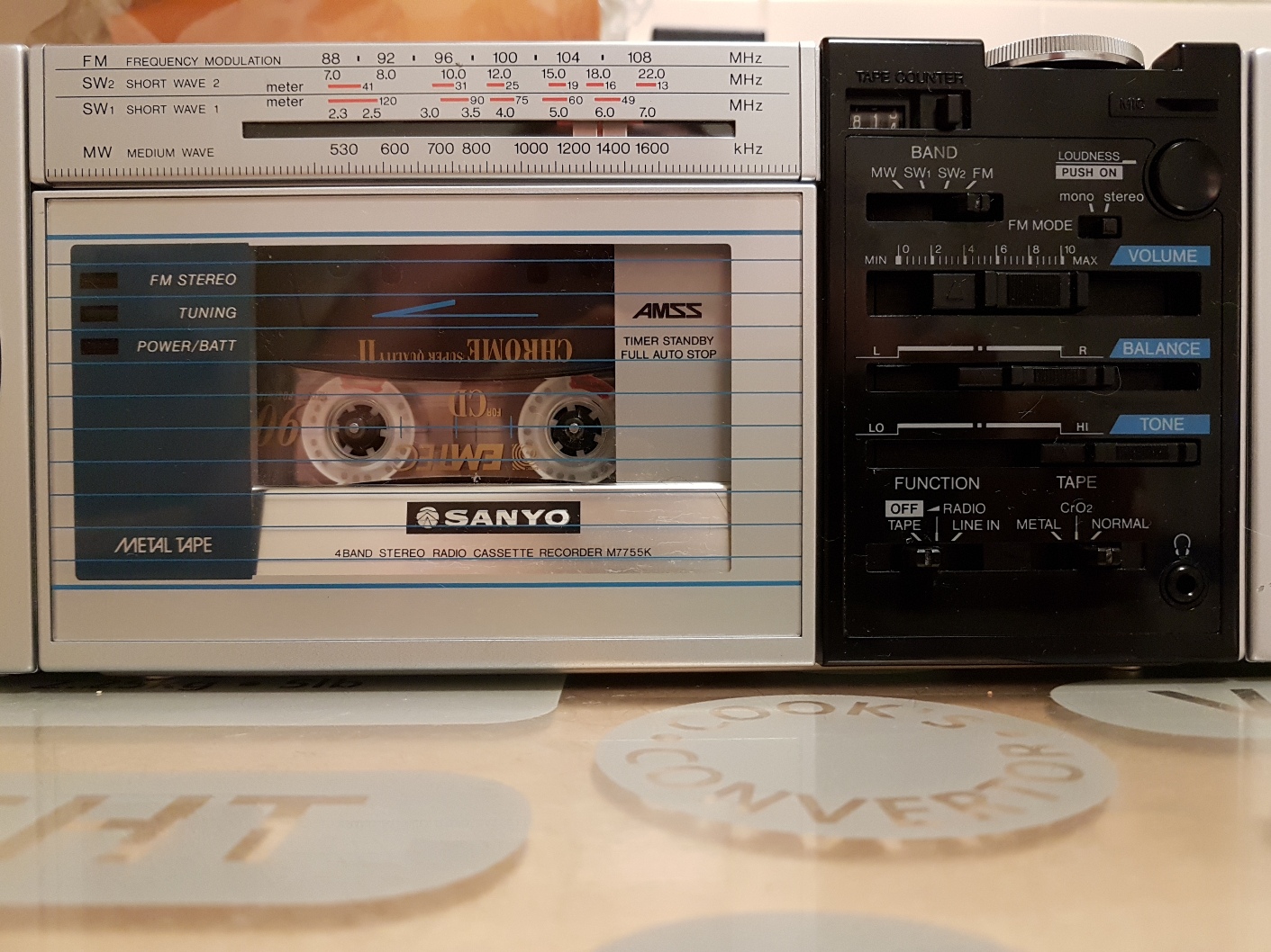

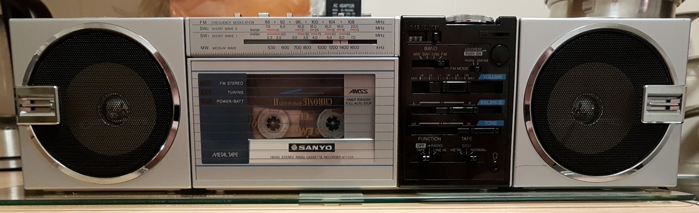

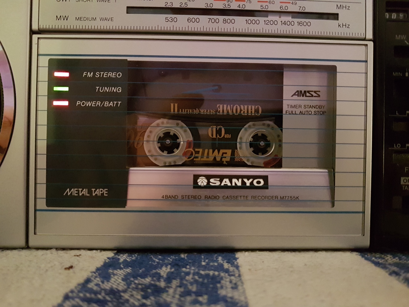

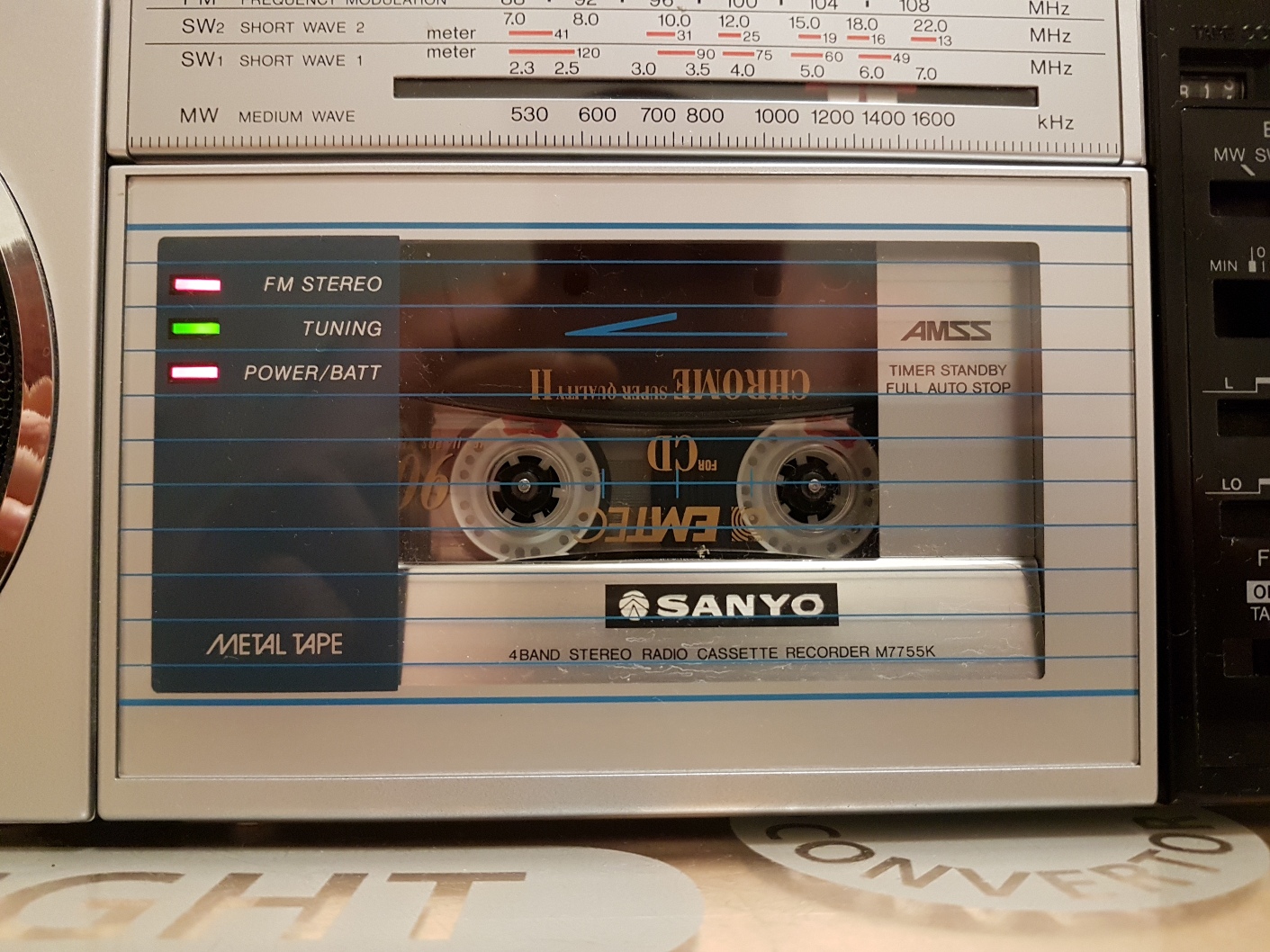

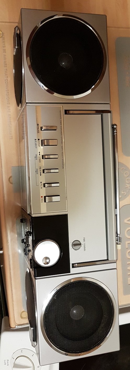

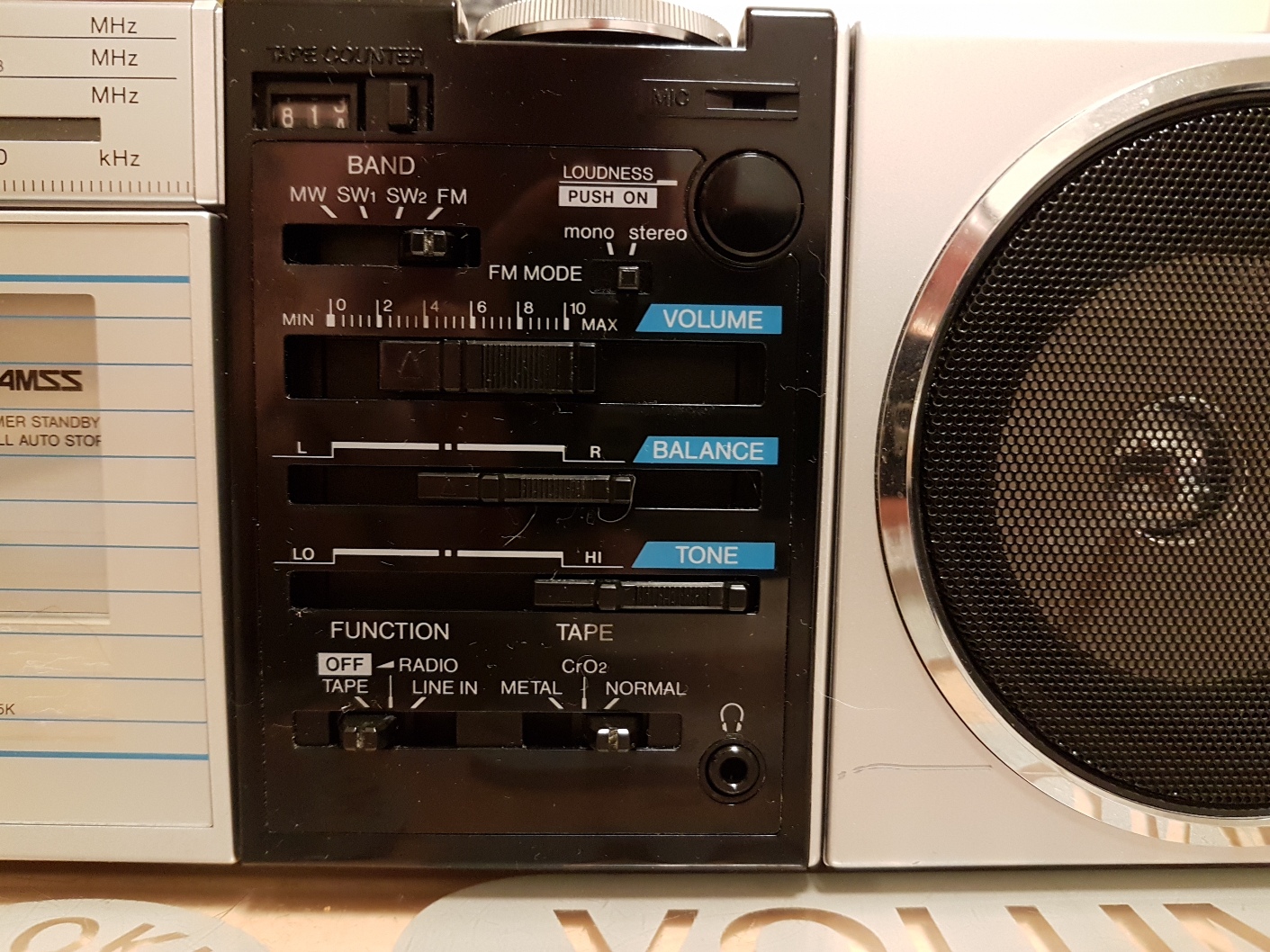

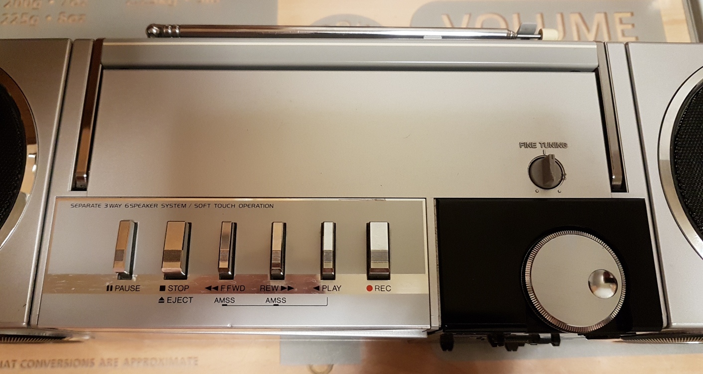

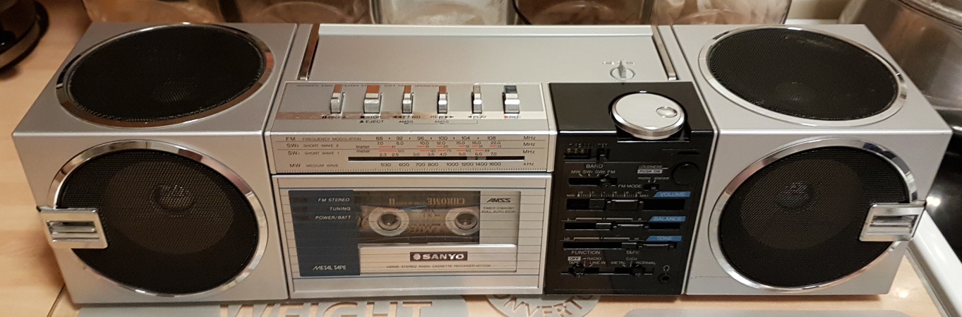

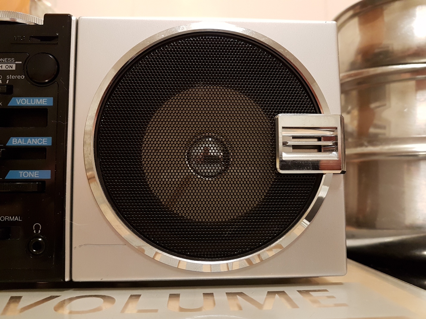

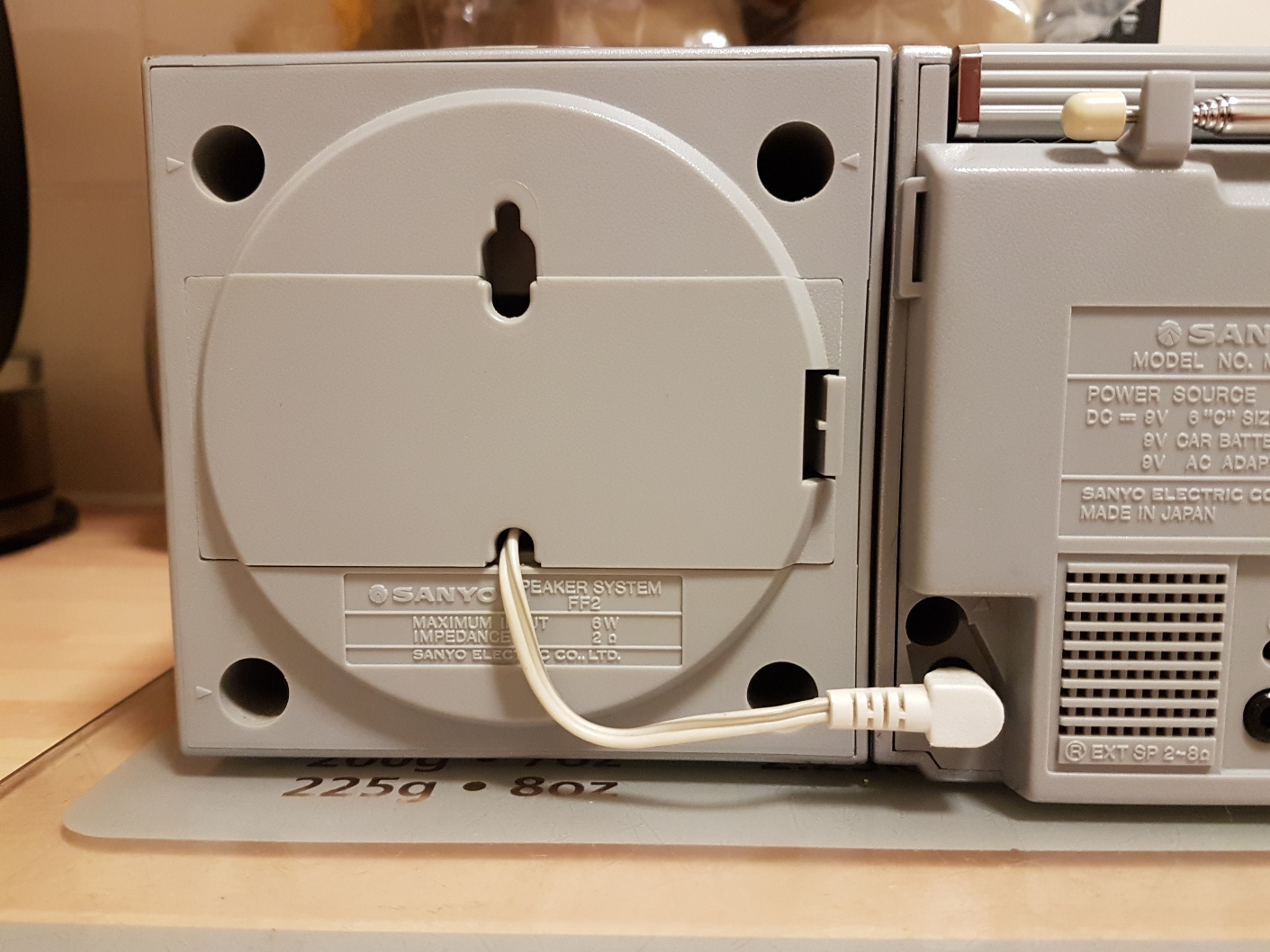

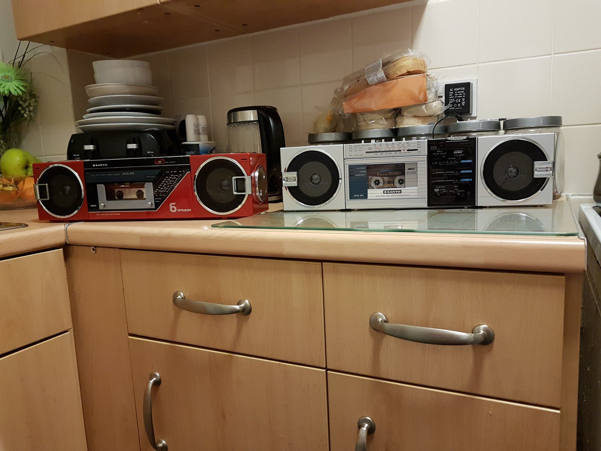

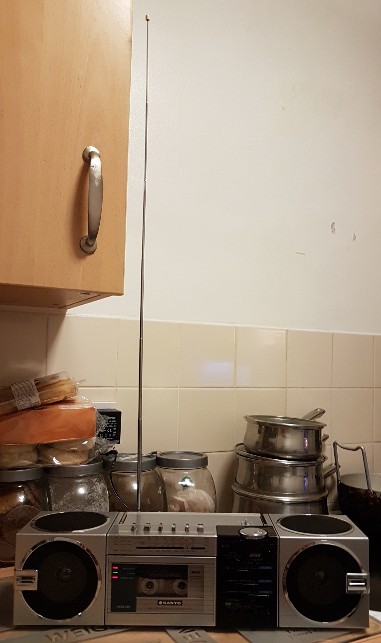

    Ok so here she is:
    Sanyo M7755K Radio Recorder - February 2017 (1).jpg Sanyo M7755K Radio Recorder - February 2017 (2).jpg Sanyo M7755K Radio Recorder - February 2017 (3).jpg Sanyo M7755K Radio Recorder - February 2017 (4).jpg Sanyo M7755K Radio Recorder - February 2017 (5).jpg Sanyo M7755K Radio Recorder - February 2017 (6).jpg Sanyo M7755K Radio Recorder - February 2017 (7).jpg Sanyo M7755K Radio Recorder - February 2017 (8).jpg Sanyo M7755K Radio Recorder - February 2017 (9).jpg Sanyo M7755K Radio Recorder - February 2017 (10).jpg Sanyo M7755K Radio Recorder - February 2017 (11).jpg Sanyo M7755K Radio Recorder - February 2017 (12).jpg Sanyo M7755K Radio Recorder - February 2017 (13).jpg Sanyo M7755K Radio Recorder - February 2017 (14).jpg Sanyo M7755K Radio Recorder - February 2017 (15).jpg Sanyo M7755K Radio Recorder - February 2017 (16).jpg Sanyo M7755K Radio Recorder - February 2017 (17).jpg Sanyo M7755K Radio Recorder - February 2017 (18).jpg Sanyo M7755K Radio Recorder - February 2017 (19).jpg Sanyo M7755K Radio Recorder - February 2017 (20).jpg Sanyo M7755K Radio Recorder - February 2017 (21)).jpg
