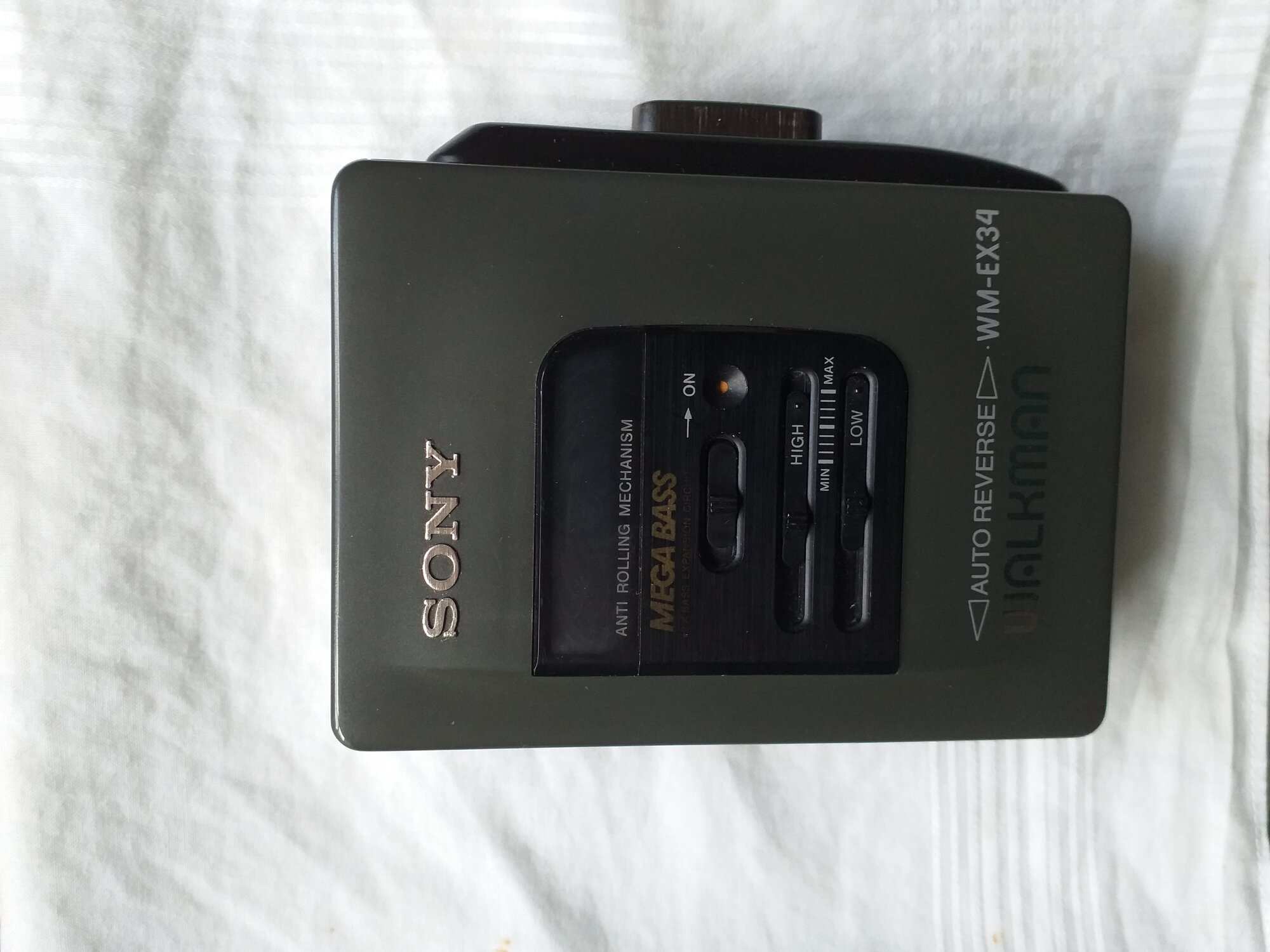

    CDV/Emiel. This is the only cheaper Walkman I have. Picked up in a charity shop last year. .ade the mistake of fast forwarding, reminding tape which resulted in the belt(s) going. I think about 1989-1990. Cannot find much information on this model on the net. EX-36 yes but not the EX-34. My brother -in- law ordered a new belt from Marion who sent one belt but have heard that there are two belts. Anyone know please. As you say Emiel no screws so my brother in law not keen on trying to open it up. Sounded quite good when working.

    @Derek marshall all these plasticky models made around 1990 to 1999 (give or take one year) use just one belt, and it is the same belt for a single-direction models and for autoreverse models. There is a newer lineup from around 1994 with metal frame, they also use one belt, but single-direction and auto-reverse models have different belts.
    Here I am taking one apart to replace the belt. This is a very early model in this lineup, it has black plastic gears, and they have been greased. When I took it apart I saw that the grease all dried up. Later versions have white gears from PTFE or something, they are more slippery, so there is no grease on them.

    CDV. Thank you so much for all the information. The video will be very helpful. May even try myself now.

    I guess the idea is, when you push the inner "claws" in, they should disengage, then you unlock the outer ones. But after opening several of them, only one inner "claw" usually disengages successfully, others keep holding. So you should rather start from the outside, force open one end, keep it slightly open (stick something in the slit), then go in and push those inner "claws", especially the one that is closest to the end you half-opened, and after they click, continue with the outside. Yeah, I broke some of these "claws" (tabs, whatever). I broke two of them, they were nearby on the same side, on one of the walkmans, so had to tape it outside to keep it together :) If you don't care about the looks, but just want to make it work again, I say go for it :)

    CDV. Possibly something like bank cards could be used to gently pry the parts open. I have several of those. If a couple get brocken so be it. Just like to get the Walkman working again. Some black insulating tape may be called for. The Walkman is in very good condition considering it was just on a shelf. Nothing else with it but that's no problem. 3 volt aa supply so enough power. I never fast forward/rewind on any of my units, never have. I use my boombox for that. Thanks again for all the useful information.
