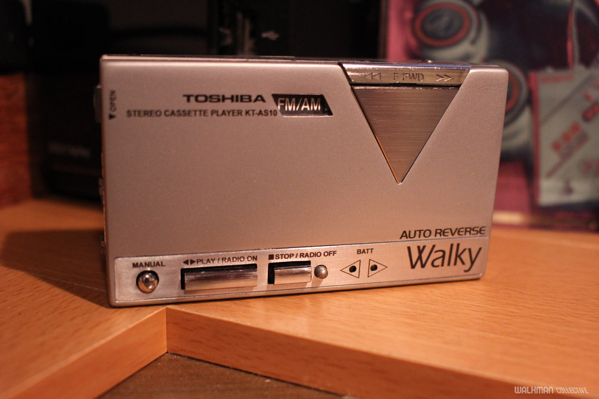

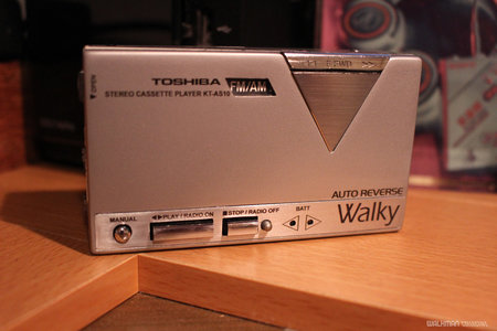

    So couldn't help myself when I was at the hobby shop picking up the aluminium sheets for the KT AS-10. A nice little turntable :)
    Antoni and Boodokhan like this.
  4. buzbox
    buzbox Active Member
    461
    Australia

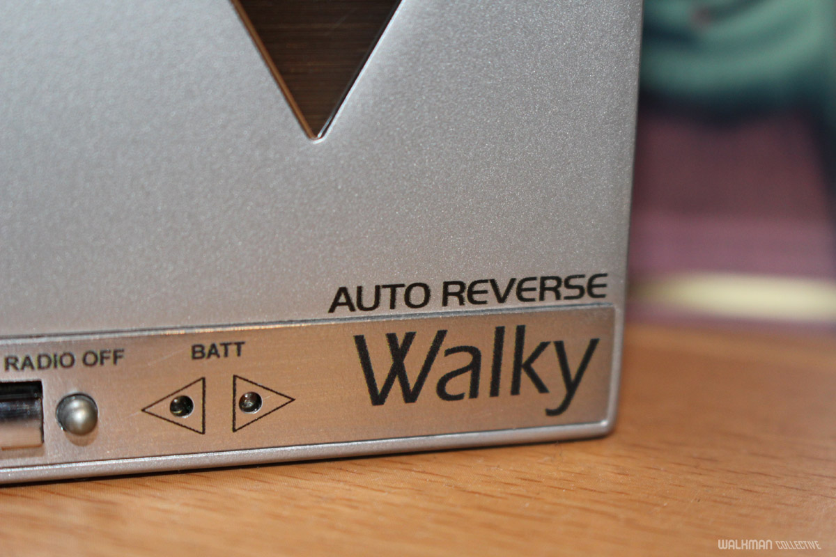

    All done with the controls panel aluminium overlay!! I had to cut and drill the holes by hand then carefully file the holes to size. Sanded lightly with 1200 grit sandpaper and polished with some Autosol Metal Polish. Added a clear coat to protect it from scratches and also to help prevent the lettering from chipping away.

  5. PHILIP[
    PHILIP[ Member
    139
    Birkenhead
    Very well done . Wish i had such talent
  6. matt
    matt Member
    51
    stockholm
    One of my favourite units lovely (but if I would buy one I must have it original and not reprinted even though) I think it’s beautifully done. :thumbup::hi
  7. buzbox
    461
    Australia
    I agree on it being original but was in bad cosmetic condition especially the front. Took the opportunity to revive it as close to original as possible.
