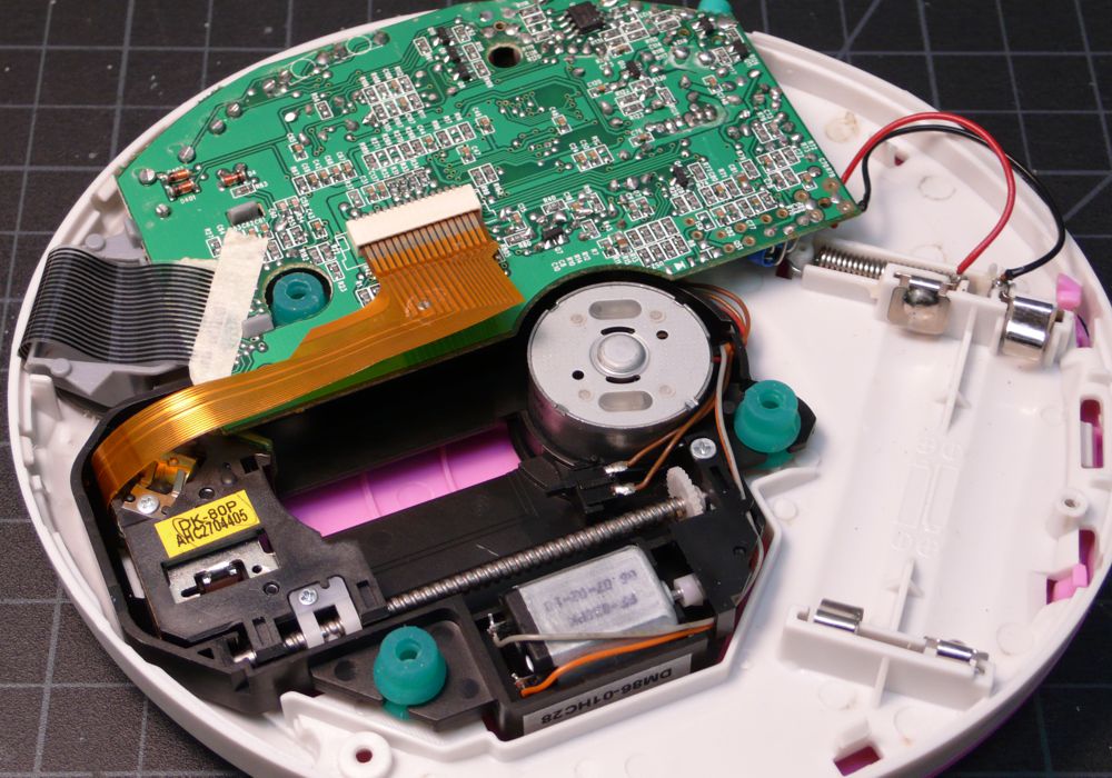

  3. Jorge
    1,785

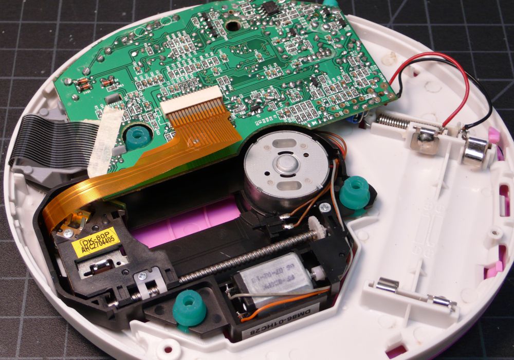

    Do you have a photo of this flex connector? Absolutely ALL Discmans use them for their laser mechanisms, and you can buy a box of broken Discmans from mid-nineties for the price of shipping. As a Discman collector, I have quite a few "parts only" here, will send you flex board (for free, of course) if any fit your specs

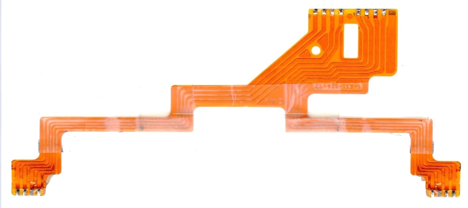

    Very kind of you to make the offer, Jorge.

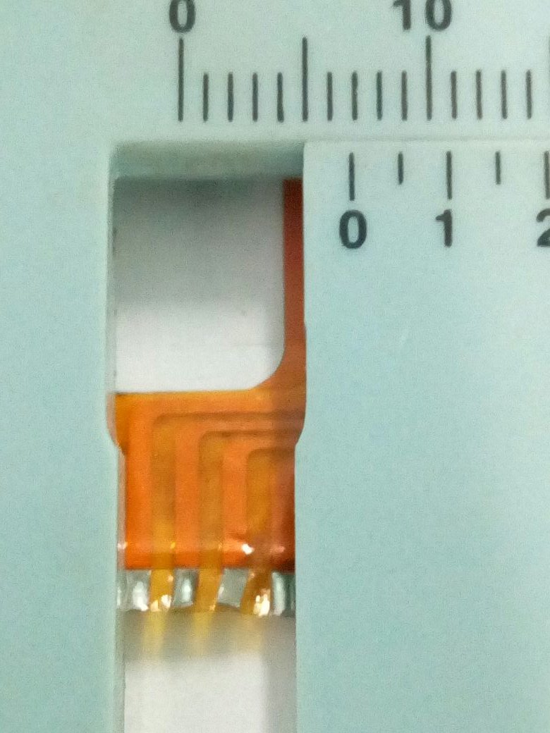

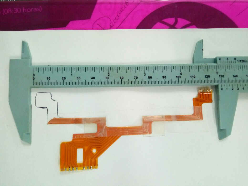

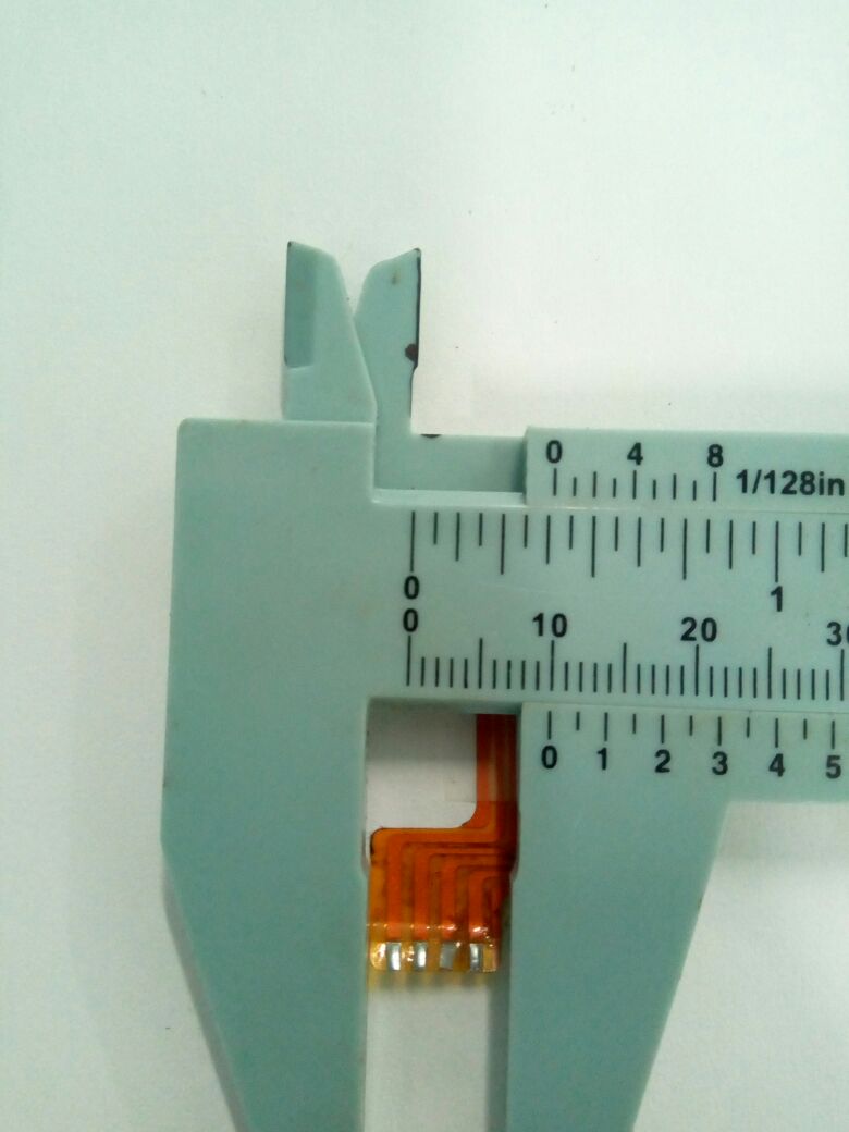

    Yes, I have a picture of the flex connector... but I kind of doubt there will be one that matches the design... Of course a small part of a flex connector that resembles the missing part can be cut and adapted, but the flexibility can be seriously compromised if the solder is aplied where the flexing is expected. You can see the missing part on the left (drawn).
    The flex measures roughly 125mm from side to side, and the missing section is 10mm wide by the exposed copper terminals, (with connections being 1mm apart from each other for a total of 7mm wide, counting all four of them - check pictures of the opposite side, which is a "mirror" image of the missing part, please)
    I'll try to get my hands on the raw materials and reproduce the circuit, if that proves to be too difficult, I'll adapt as you suggest and get back to you.

  7. Sergio Salinas
    Sergio Salinas New Member
    26
    Mexico

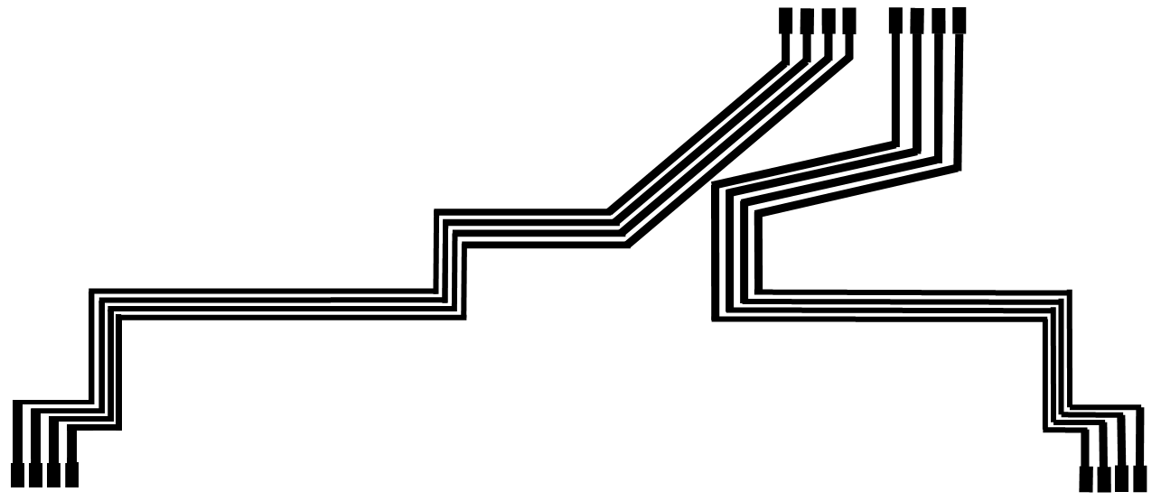

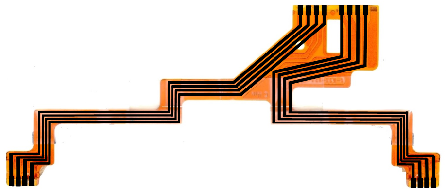

    Making some progress today: Scanned the connector, fixed the missing part (digitally) and traced the tracks on top. Will buy the material later on. It will not be the exact same layout, but same electrical function.

    Thanks... These companies sure do a more professional job than what I can ever come up with, but I guess the charges for creating the digital version of the PCB alone (so called "gerber" file) are around one hundred bucks, once you have that file, the cost per ribbon must be in the cents to a few dollars, the most, depending on quantity ordered.
    I could download a PCB design application and learn how to use it and create the gerber file myself, but I'm afraid the learning curve is at least some ten hours (or more), I don't think I want to go that route, especially since I only neeed one of these.
    If anyone in the group already knows how to digitalize the circuit and cand send the file to me, I can get the copper clad flex material, etch it and mail a few ribbons in exchange. At this point I'm in the middle of some other DIY proyects that demand a lot of time from me, can't afford sitting to learn the software for a long time and/or the cost of having them made for me. Maybe if this was a very common problem, I'd look into making a group buy or something of that sort.
