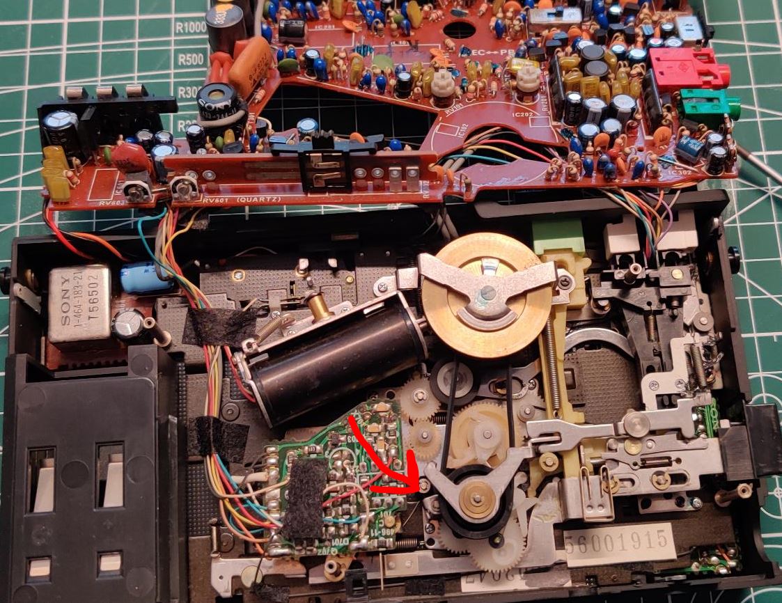

    Hello community. I was lucky enough to get into this hobby not to long ago by getting myself a very nice WM-D6C, unfortunately it's a little problem child.
    The latest of my woes is that tapes I play through it sound like they are sent through a lowpass filter or have the "underwater" effect on them. The magnitude of the effect is cyclical i.e. it gets stronger and weaker with some regularity, though at least from what I can tell this cycle doesn't correspond to the rotation of the tape spools. However, it also doesn't seem to be a problem with the tape, because playing around with FF/REW and PLAY/PAUSE a little I can make the "peaks" of the effect appear in different parts of the song. Though to be honest it's a little hard to tell if that's really the case or I'm just losing my mind, so take this part with a grain of salt. I'm pretty sure I was able to do this earlier, but trying to replicate right now doesn't seem to work. EDIT: I've just played through this tape back to back (the sample provided is from the beginning of Side B) and the pattern has clearly changed. The very beginning of the song was crystal clear and the muffled sound only came in a second or so after. So there is definitely something funky going on here, but I don't know enough about cassette players to understand what.
    Unfortunately this is the only tape player I own, so I can't verify how that tape would sound on another device.
    I've provided a sample of what it sounds like from a tape I've recorded yesterday. It's Type I, though I've also had the same happen with Type II tapes, all recorded and played without any Dolby NR. Also I could have sword this sometimes happens with tapes that are fine the day I record them and and then this issue crops up a day or two later.
    In addition, it feels like it only happens at the beginning of the tape and after a few minutes it becomes weaker and weaker until I can't tell if it's still there or not, but I would have to do more testing to really confirm this.
    The only things I did to the player so far, is clean the tapehead, capstan and pinch wheel with IPA. As well as open the player up (after it ate a tape and started making a rattling noise when playing) to replace the two rubber belts, the rubber ring around the capstan, the rubber wheel pressing against the capstan (sorry I'm not well versed in the technical terms yet, I believe it's the wheel responsible for FF/REW) as well as putting some oil/grease on some of the components and cleaning the motor. I've skipped replacing the wheel hidden under here, because it looked very hard to access and I didn't want to break anything.

  2. Deb64
    296
    Leicestershire, England
    It sounds like a tape path problem, especially if it is mostly happening at the beginning of the tape. The tape is probably riding up or down on the pinch roller. You will see this if you check with a mirror cassette.
    There are a few possible causes including:
    • A bad pinch roller;
    • Pinch roller pressure too high or too low;
    • Take up reel tension too high or too low;
    • Supply reel tension too high or too low;
    Some tapes are more prone to this problem than others, especially very thin tape.

  4. Deb64
    296
    The ridges on the tape may have been caused by tape bunching up between the pinch roller and capstan. This can happen when the take up spool is not turning. Low take up spool tension could cause this.
    Were the ridges caused by this machine or by another tape deck?
    The two things I would do first are replace the pinch roller with a new one and replace the larger belt, which drives the take up spool.
    I cannot say for certain that these will fix the problem but it is a good place to start. Both parts can be bought from www.fixyouraudio.com
    If the pinch roller and belt are original they will need replacing anyway.

  6. anhuhn
    anhuhn New Member
    7
    Germany
    Hard to say with certainty, since I did buy these tapes second hand. But the fact that so far I only found them on the tapes that I played on the D6C doesn't sounds like a coincidence.
    Sounds good, that's probably what I'll do. In fact I already did replace the belt with a spare from fixyouraudio after having problems with low take up tensions. For some reason it just didn't occur to me to order a pinch roller from the, while I'm at it.
