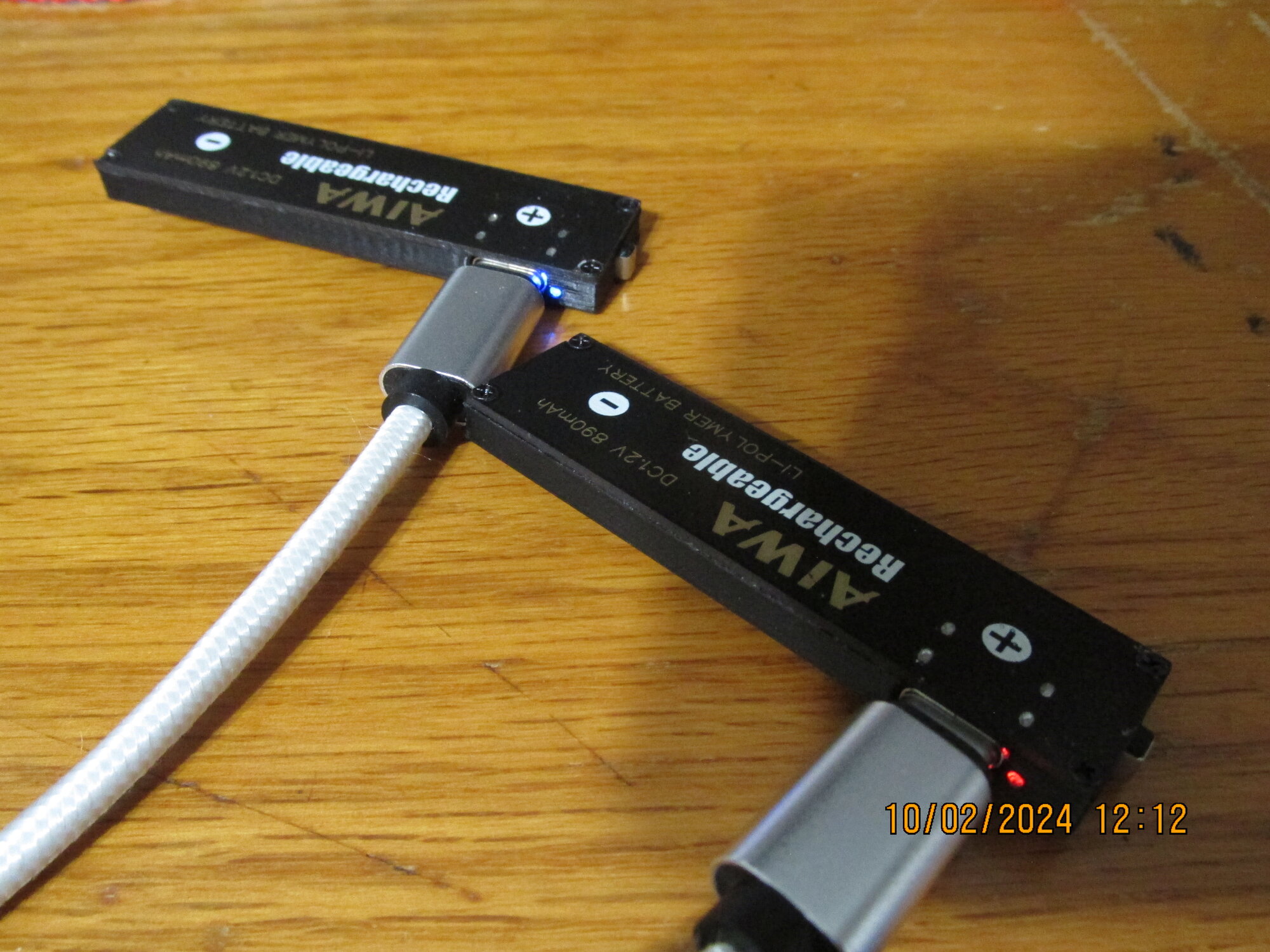

    I Bought 2 of these from China https://www.aliexpress.us/item/3256805200442093.html
    Each in USD $22.28 Expensive and they took one month to arrive.
    09 February 2024 I used my cell-phone to
    IMG_9683 Blue=Charged Red=Charging Li-polymer C-USB rechargeable walkman gum stick battery.JPG
    go live in facebook and also used a Canon cam-corder to upload a video about unboxing and trying these in my Sony WM-GX670 Walkman Auto Reverse Radio Cassettte.

    These look very familiar, I think the 860/890mAh marking is not really relevant or accurate.
    Happy to see the long gone NiCD-NiMH batteries can be safely discarded.
    A while back I posted findings about the 800mAh variant, spoiler alert: I like it.
    Easy to charge, works well. One issue though that @Valentin mentioned: there is a chance to short the Walkman with the Li-ion voltage (3.7V+).

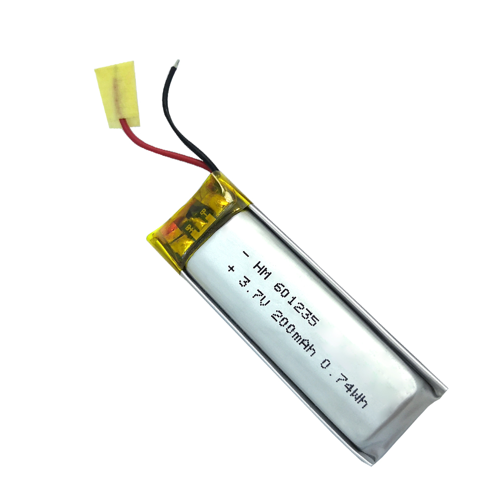

    If I assume they are using a 200mAh 601235 type cell (picture attached) and a Buck coverter efficiency of 90%, the assembly's capacity at 1.2V is 554mAh.
    In this case, the Vapex can do significantly better even in the worst case scenario of not being fully discharged.
