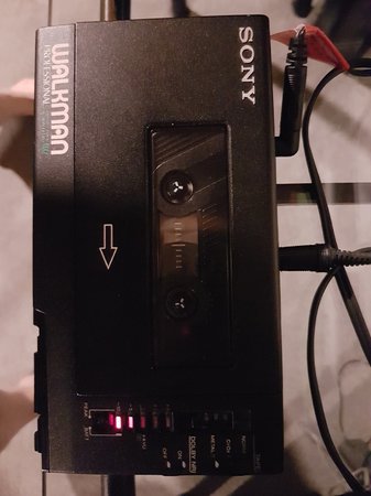

    You've probably got the answer now about the CG kit for your DD's and by way of completing my saga of the D6 the journey ends. Finally after an IC (CP602) rebuild from a friend the speed problem is fixed, output cranked up +4VU over specs too and it's humming. $50 and 50 hours labour but it lives on!
