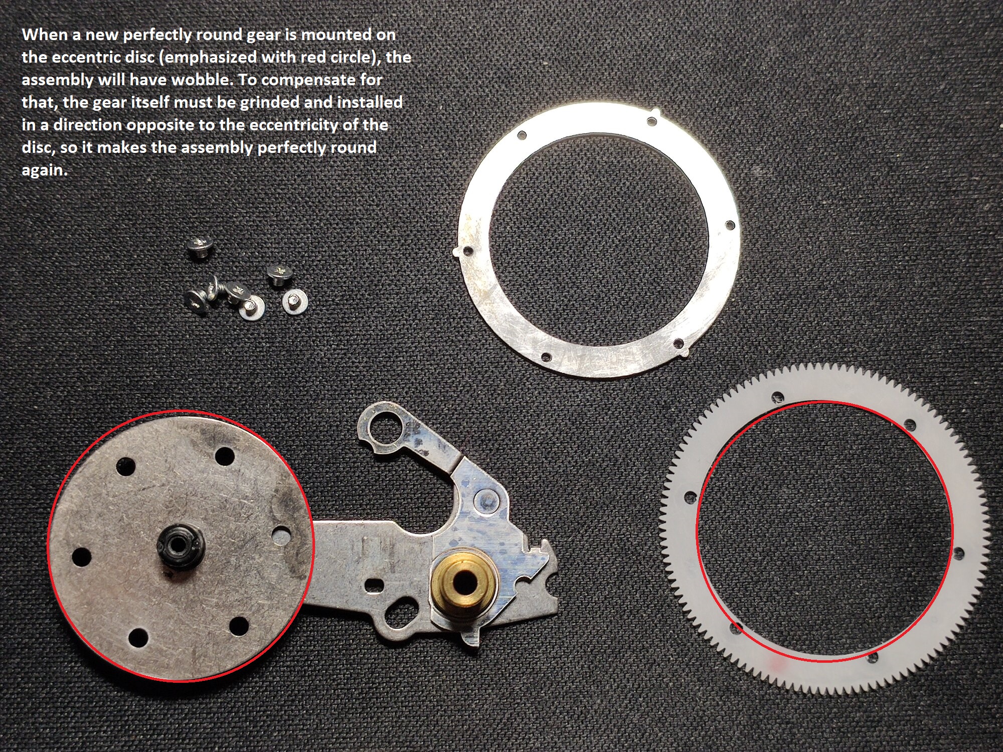

    The center gears that I make are perfectly round. The problem is not in the new center gear design, it is pretty concentric. When the center gear was produced originally, the metal disc was inserted into the mold and then it was filled with POM plastic. Sometimes it happened that the metal disc was not inserted exactly into the middle. Normally, it was not a problem, because the plastic center and outer gear were always concentric. Only the metal disc was shifted a bit. But the new center gear design relies on this metal disc concentricity. Approximately, 1 of 5 gears have this problem.
    It means that none new center gear design can be used successfully in such a case.
    You can compensate for this original metal disc eccentricity by making the new gear a little eccentric, too. I used to grind it from the inner side using the Dremel tool and then place it in such a way that the eccentricity of the final assembly is removed. If you position it correctly, then the eccentricity of the final assembly will be eliminated.
    The advantage of my design is that the gear ring is pushed to the metal disc by six screws. The metal disc is perfectly flat, which means that the result gear will be also flat. Producer of the new center gear design sent me this gear for testing. At the time when I was testing it, the gear was little small and it didn't fit well. It was very difficult to install and after I succeeded, it was wavy. I sent my feedback to the producer and I think hey fixed it. So I believe this design is very good, now, based on your feedback.

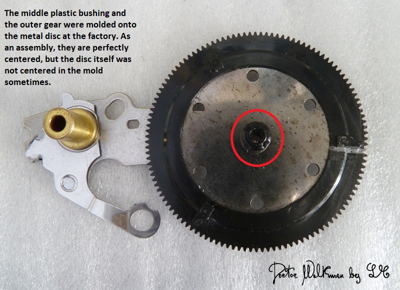

  8. Valentin
    2,049
    @CDV I put 2 pictures explaining what is happening.
    The idea is the middle plastic bushing (with the center hole on which the gear rotates on) and the outer gear were molded onto the metal disc.
    So in this scenario, even if the disc itself is not put perfectly in the middle of the mold, it doesn't matter, because the assembly will be perfectly centered.
    However, the problem is the disc will be eccentric on that middle plastic bushing.
    Of course the eccentricity marked in red is exxagerated, in reality it's very small, like 0.1mm.
    EDIT: In the second picture description, by "opposite to the eccentricity of the disc" I mean as far as outer part is concerned.
    The inner part of the gear should be matched on the same side, meaning the grided part of the gear should go where the disc is eccentric.
