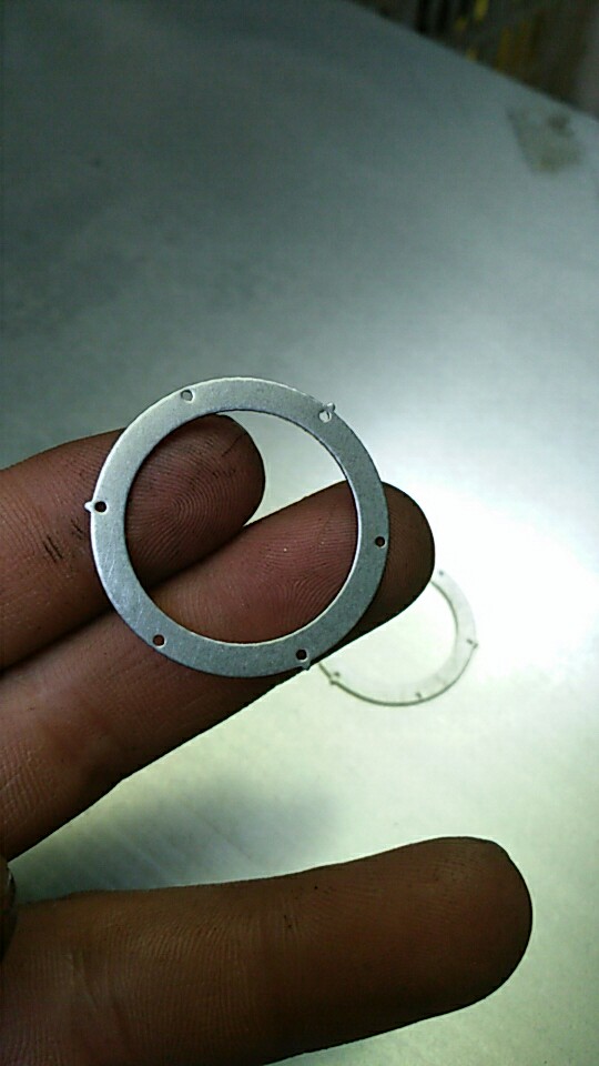

    Here is small update.
    I just got the image of the new version of support ring from my producer. I think it is OK, final production can start.

    Adding 3 screws (6 screw version) will help fit gear and support ring very tightly and accurate to the original metal disc. I expect smoother run.

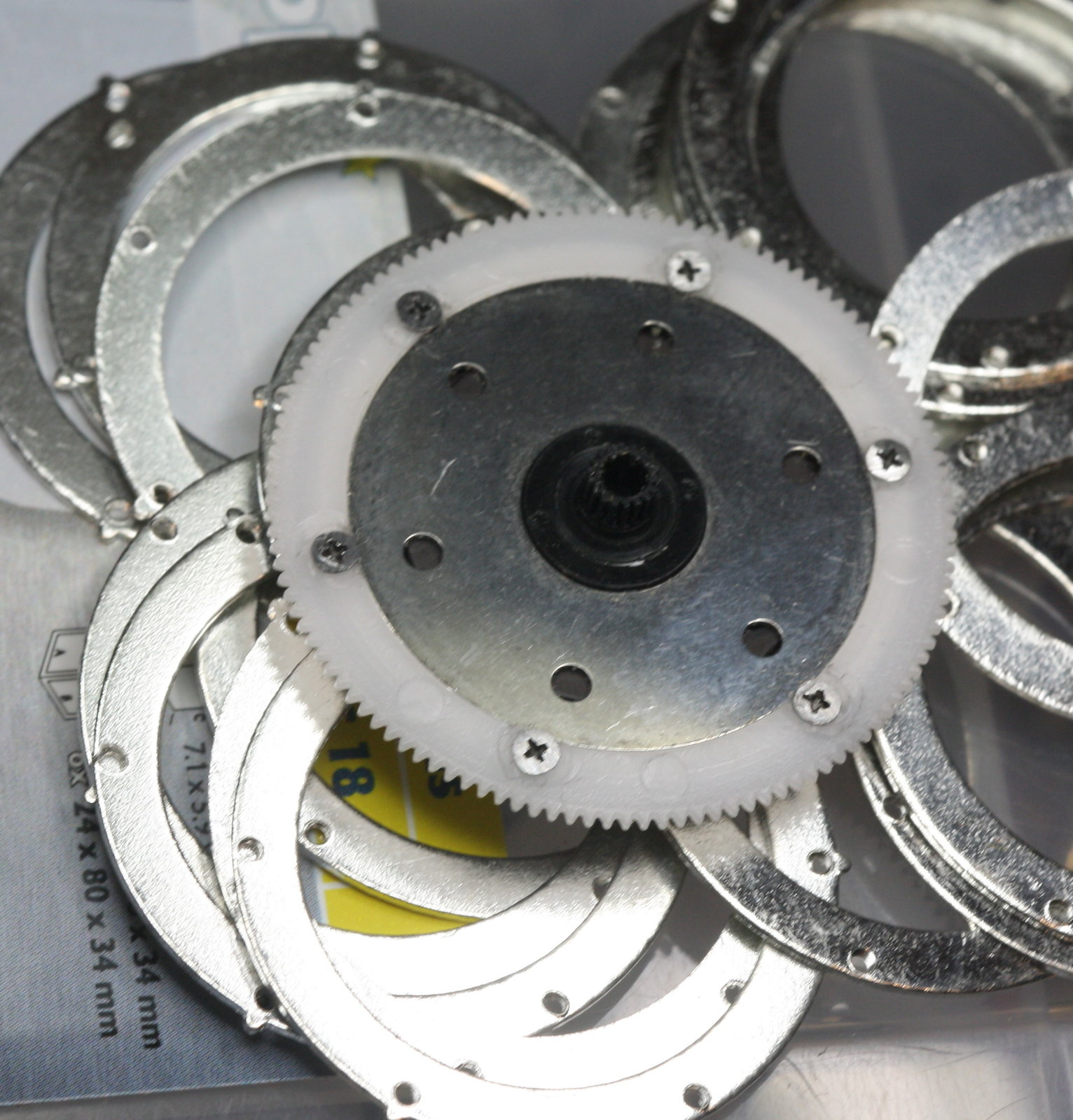

    Another small update: support rings were produced and were shipped to my address today, using DHL express. They should be here at the beginning of the next week.
    Then I'm able to test them in at least four DD walkmans, to confirm final gear design and dimensions.

    Upper rings are here. I think they're done very well but I need to test them.
    Next step:
    I will prepare/check final technical drawing of new plastic gears. I have to test old version of plastic gears with new upper rings. I need to put them to several walkmans. New design has to work well in all of them.
