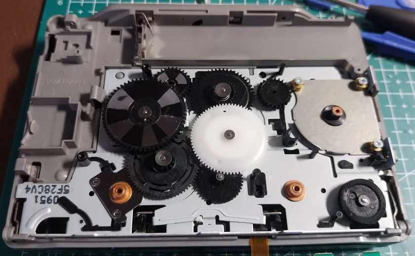

    Hi All,

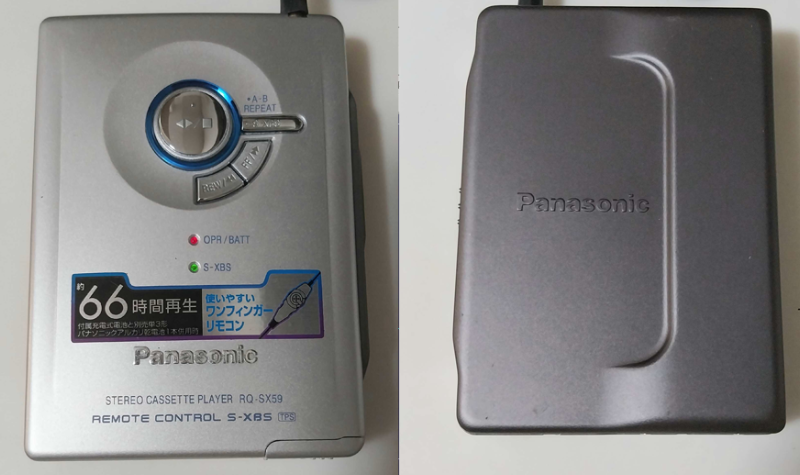

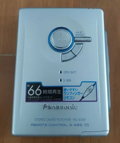

    Recently I got my hands on an RQ-SX59, Panasonic's last logic control model released in 2005, with the AR21 Mechanism.
    With this model, Panasonic improved battery life to 66 hours (gumstick + AA battery), about 6 hours more
    than its older brothers with the same mechanism, the RQ-SX46 and RQ-SX47.

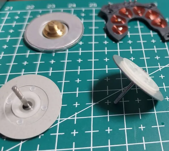

    Pictures of the AR21 Mechanism after disassembly.
    Residual belt goop was cleaned up, and capstan and motor bushings were lubricated with Chinese watch oil 702.
    This unit had some dust in it, so I just used a small hand pump blower to clean the insides.

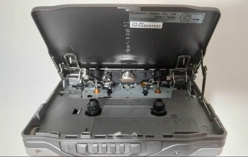

    Here's the cassette compartment with everything re-assembled. The pinch rollers looked fine, so no replacement was necessary.
    It's apparent that Panasonic reduced manufacturing costs by using more plastic. Compared to AR10 mechanisms, the size of the metal frame
    holding the tape transport mechanism has been reduced, with the plastic body now housing the gumstick battery compartment.

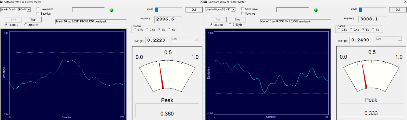

    With the re-assembly done, below are the wow and flutter results for both FWD and REV sides in wfgui, using a 3000 Hz test tape from FixYourAudio.
    Tape speed was a little off, so I adjusted it via the potentiometer.
    WRMS was well within factory spec of 0.28%, something that's nearly impossible to achieve on AR10 mechs (which had a looser tolerance of <0.3% WRMS)!
    Belt replacement used was from FixYourAudio.

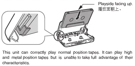

    I also noticed in the user manual it's indicated that Type II and IV tapes can also be played in this unit, but their benefits wouldn't be fully utilized.
    That's why there's no tape type detection switch and only a tape detection switch.

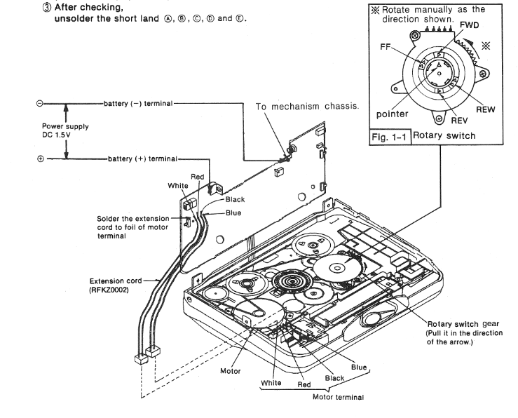

    The AR20 mech used in the RQ-XV30 was probably AR21's predecessor.
    It also didn't use a solenoid to operate, according to the service manual it uses a rotary switch to switch modes.

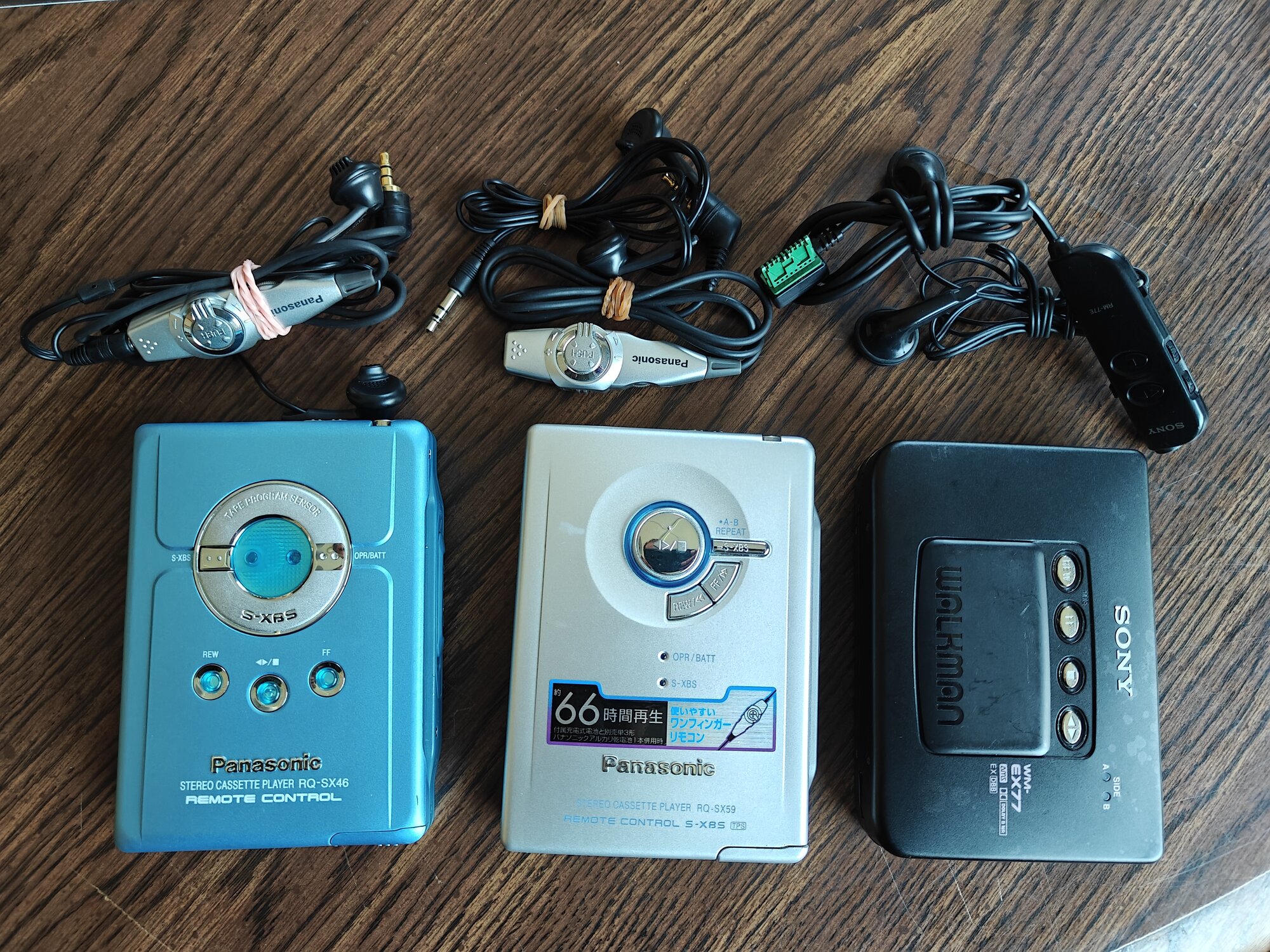

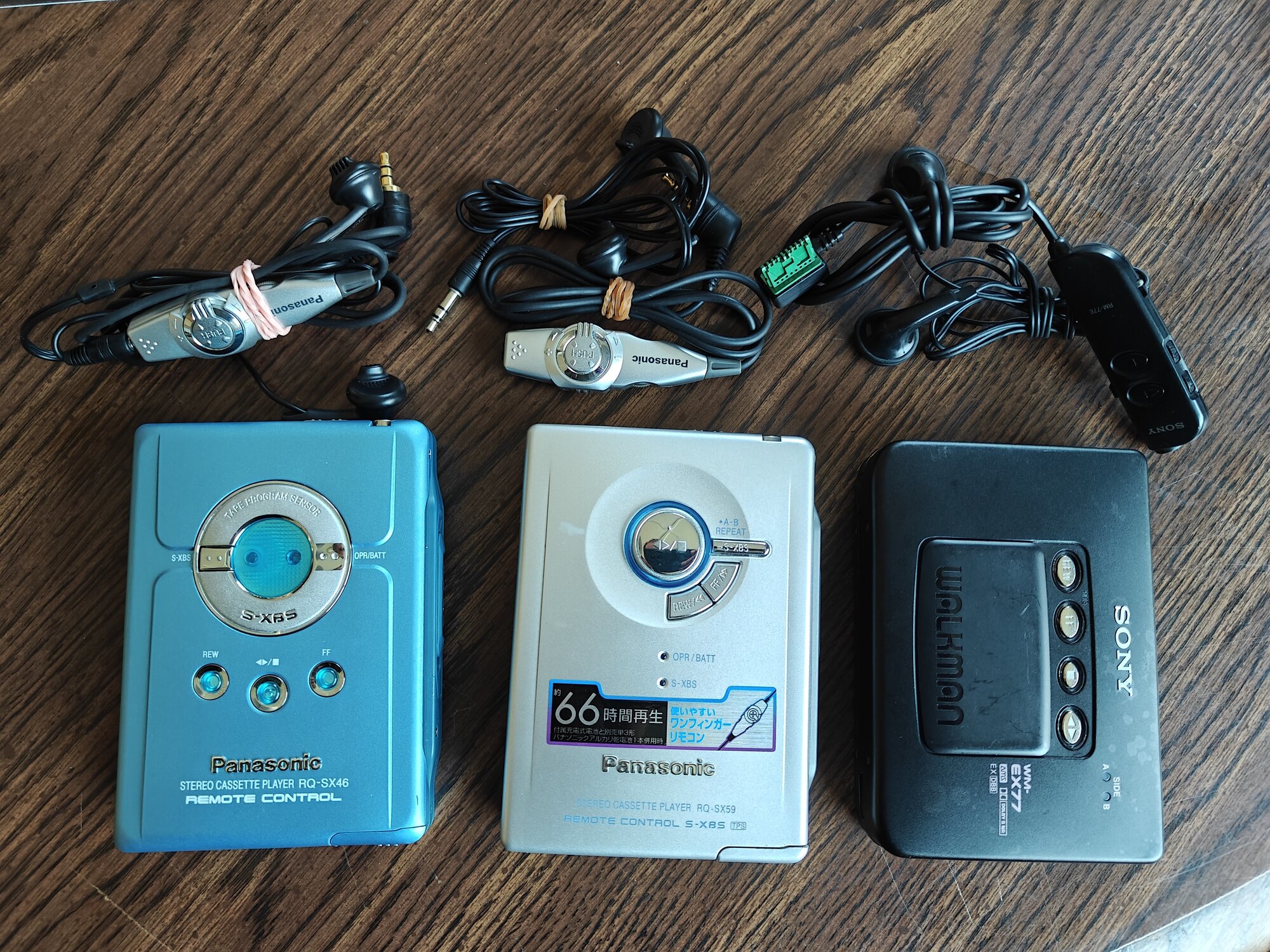

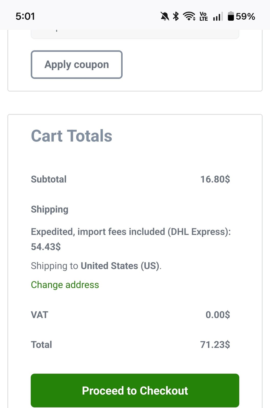

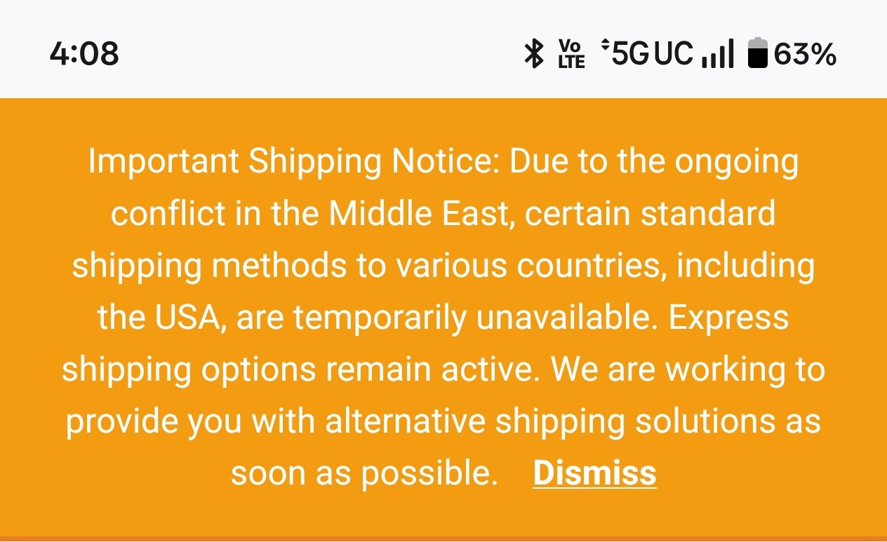

    Thanks to this thread, I recently purchased an rq-sx46, rq-sx59, and a Sony wm-ex77. All have remotes, all have rotten belts, and varying levels of battery compartment corrosion. The rq-sx59 had a dead gumstick still in it, which I didn't know until it arrived.

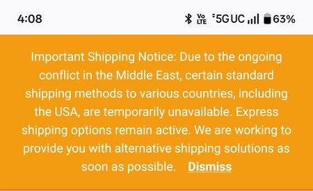

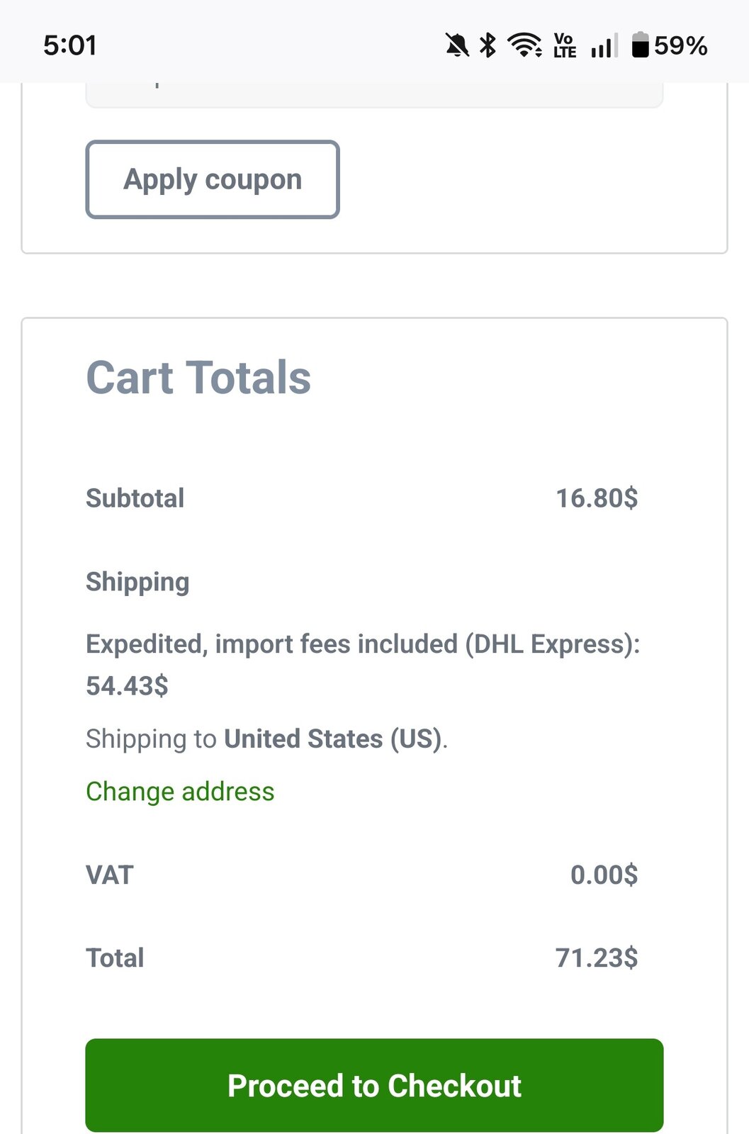

    Much to my disappointment, it looks like fixyouraudio won't be an option for me for the time being. I may take a chance on some belts on eBay
    Recaptcha likes this.
  9. Recaptcha
    Recaptcha Well-Known Member
    356

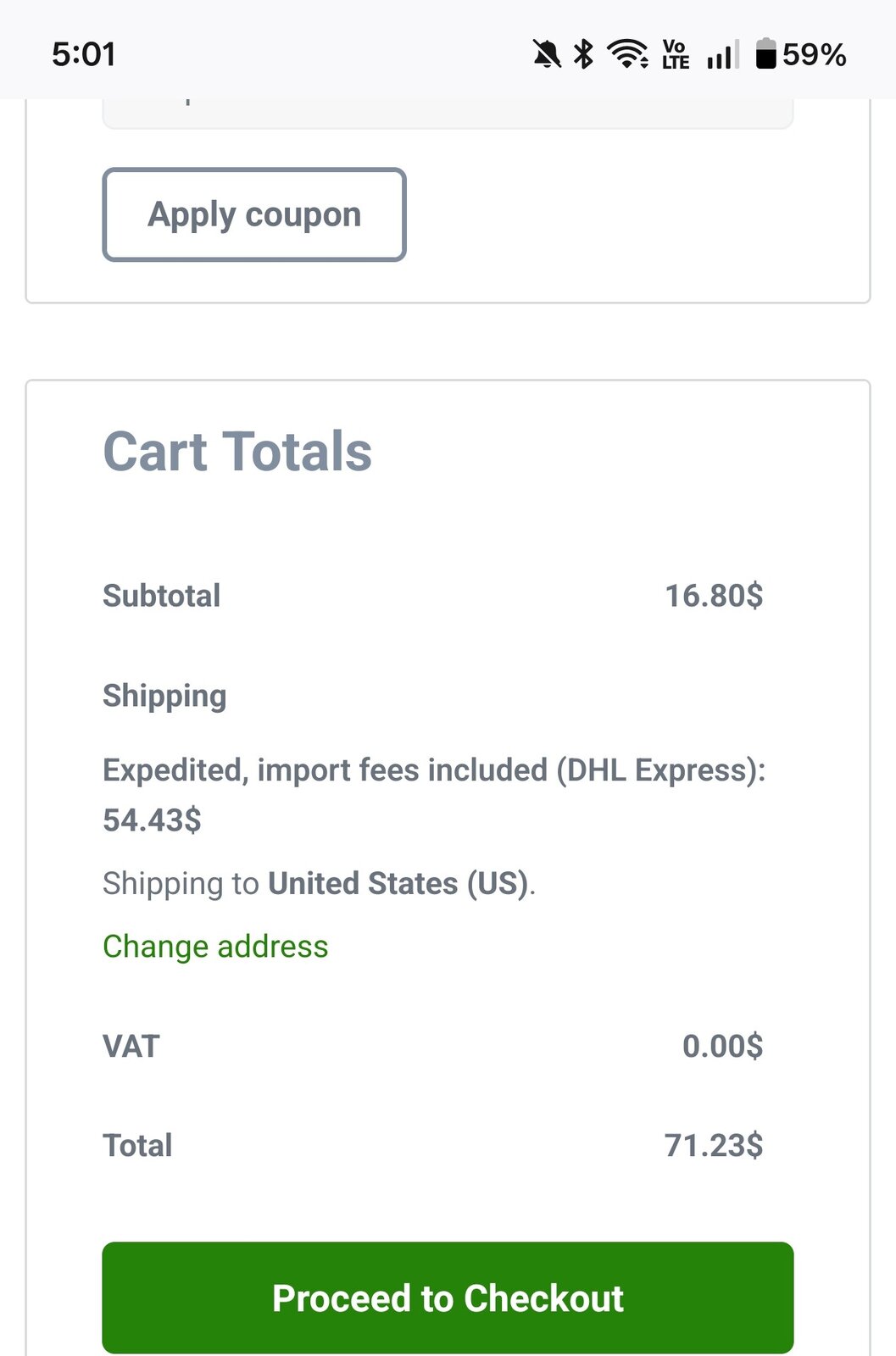

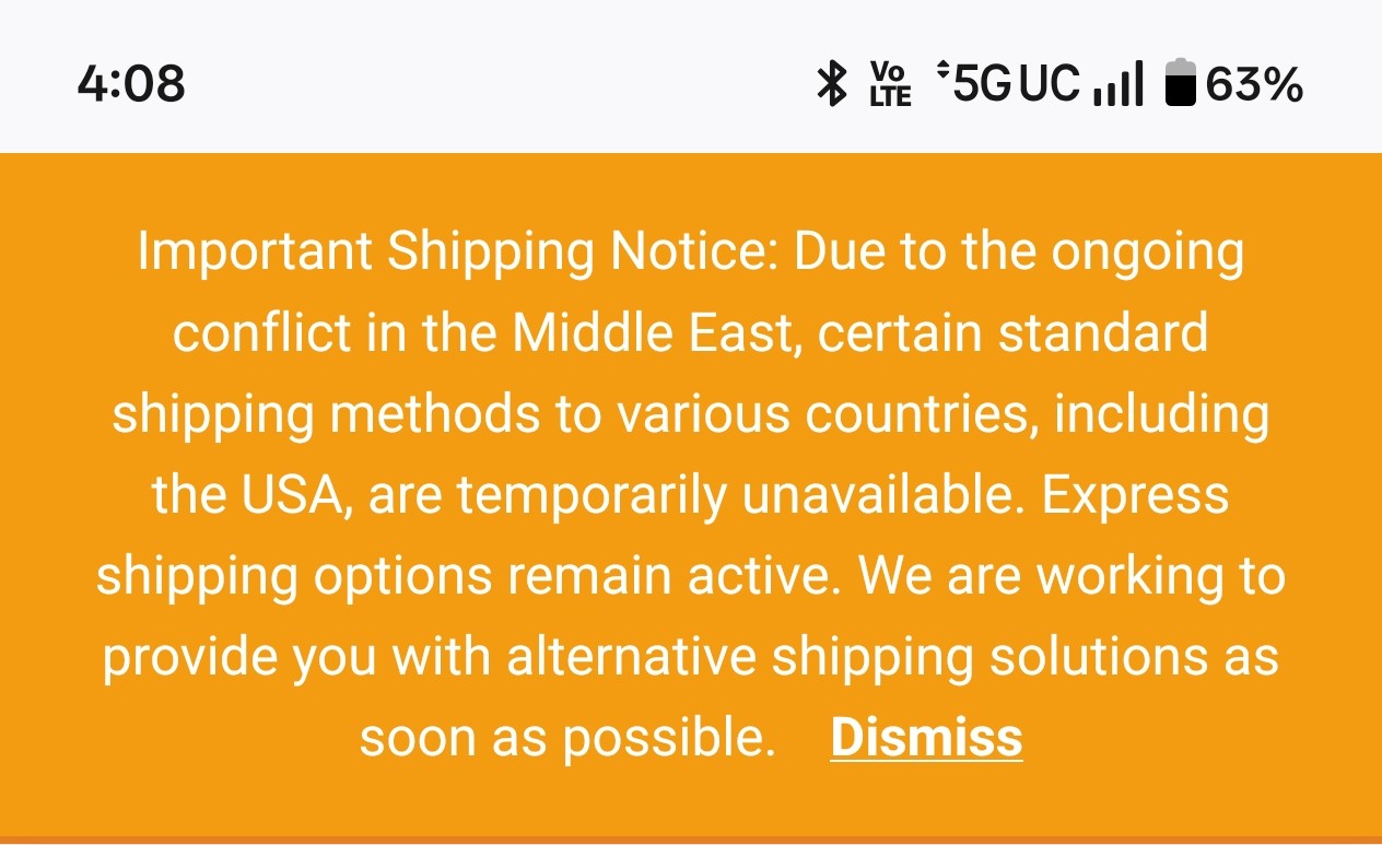

    Wow, those shipping prices are insane for fixyouraudio. I had a feeling sooner or later all of the craziness with current events would catch up to us and impact even these small hobbies we enjoy. If it’s any consolation to you, I’ve found that eBay Walkman belts have gotten much better in the last few years. I don’t think I used mihokim to get my last SX up and running…
