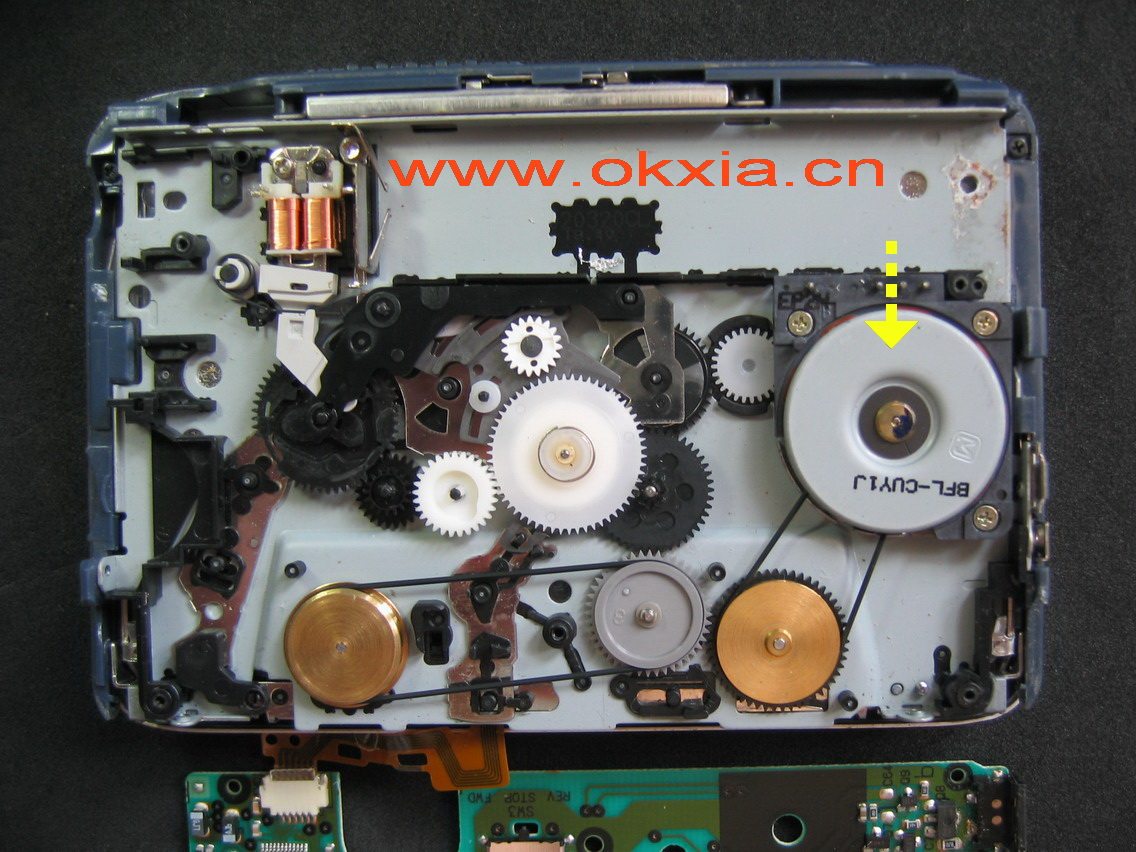

    Anyone know the Belt formation for a Panasonic RQ-SX30 or point me to the service manual with it on.
    Apparently there's 2 belts for this model.
    Thanks in advance

    you can buy both from @mihokm here
    Belt 1: Internal Diameter: 22 mm, thickness 0.5 mm, square shape
    Belt 2: Internal Diameter: 30 mm, thickness 0.5 mm, square shape
    I bought quite a few belts from @mihokm , they are of the highest quality!!!

    Yeh - I use him : ) - could do with a diagram of where they go in the machine , as the old ones were disintegrated , although I'm sure ill work it out.

    I had once a Panasonic similar to this, but the belts I got were not top quality and W&F in side B was terrible (side A was "tolerable"). How does it sound with proper belts ?
    In any case W&F on side A will always be better than side B; I never understood the engineering motives behind the two belts system, the single belt is simpler and more performing.
