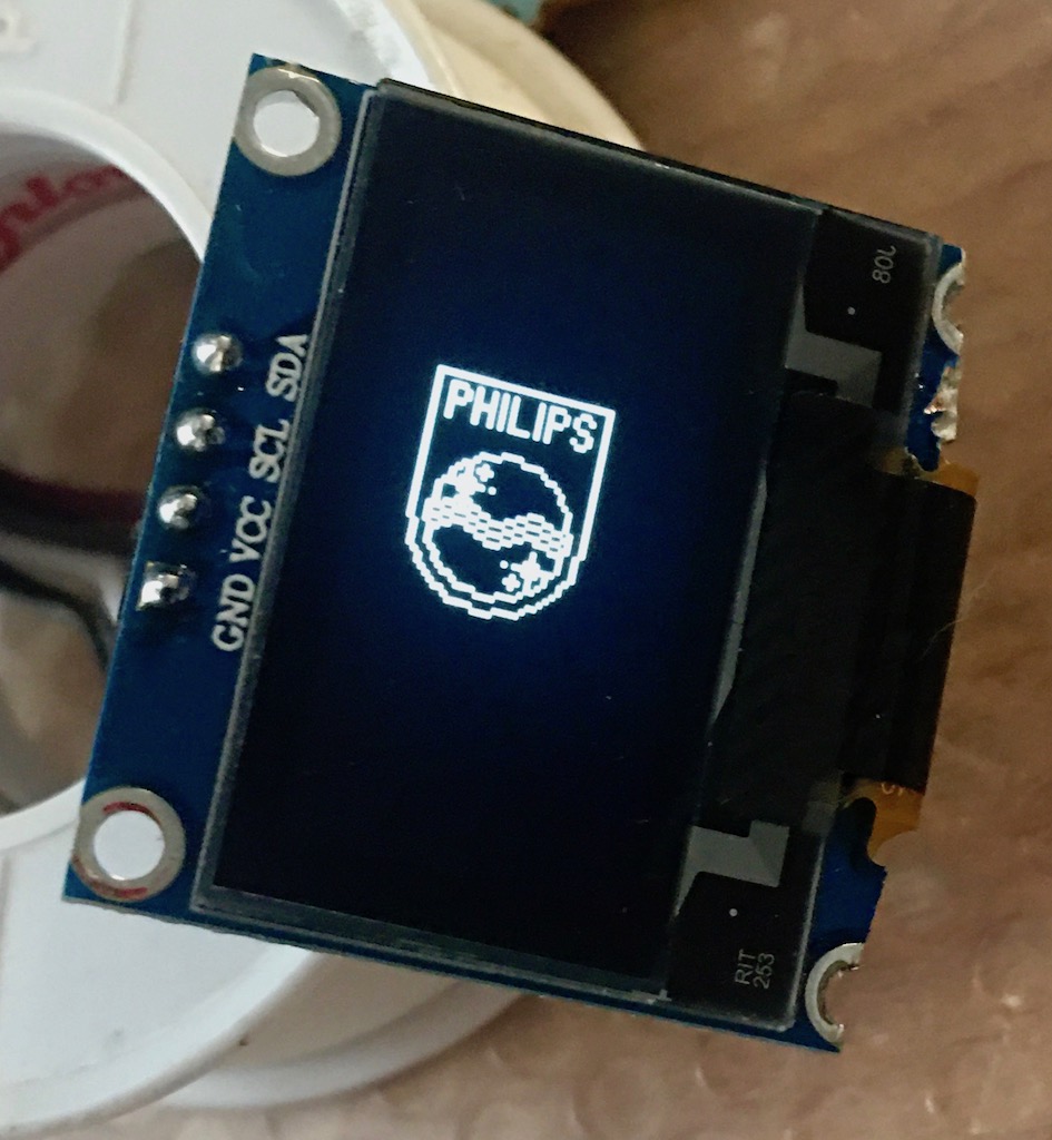

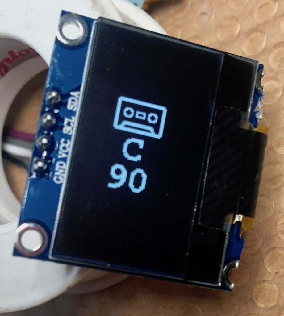

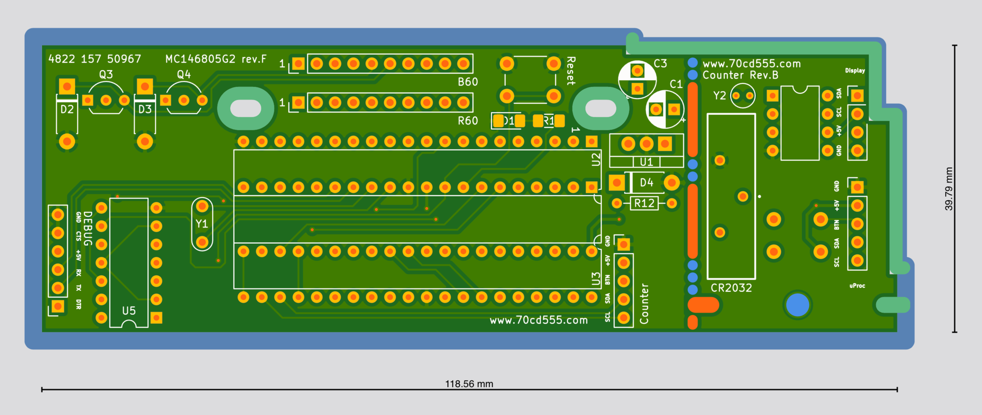

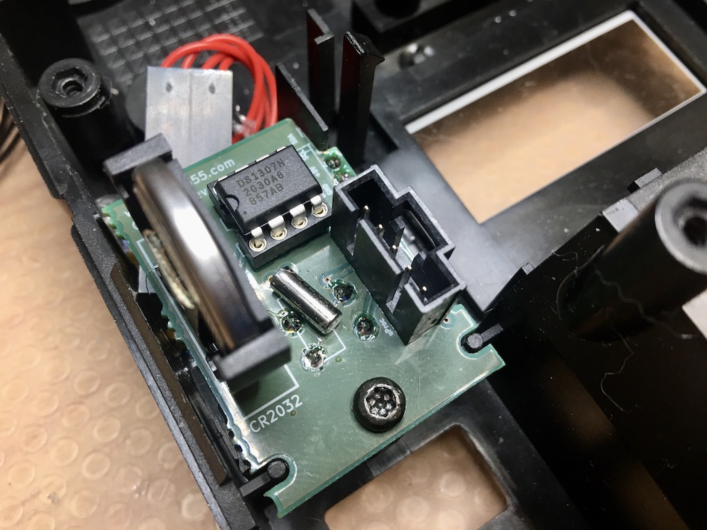

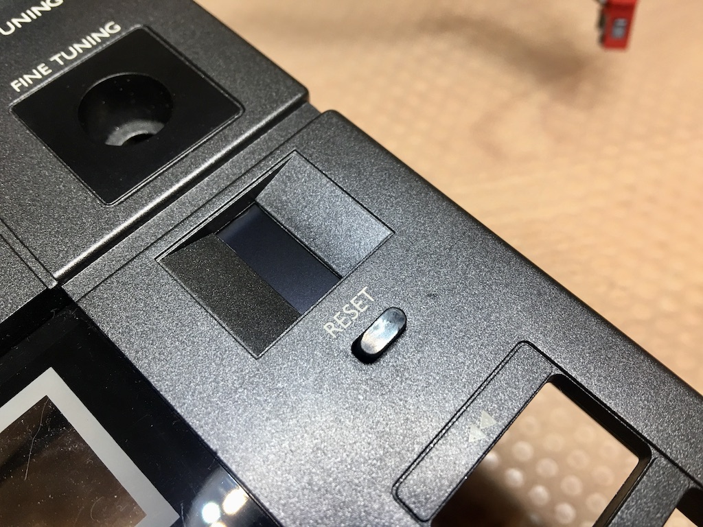

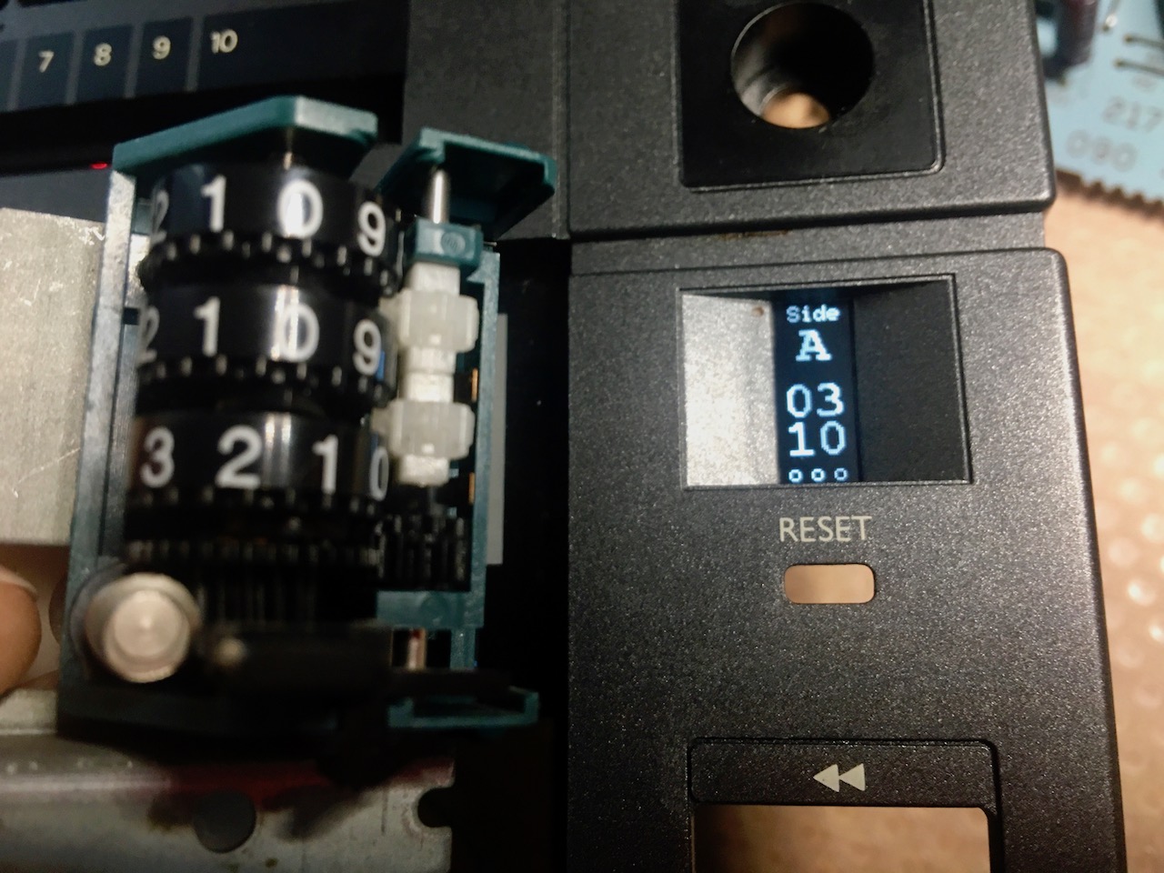

    I have been recently thinking of another modification... to replace the analog tape counter with a digital one. Would add the possibility to automatically jump to zero or to a specific position.
    And well, here it is -> LINK if you want to read more
    Not finished but added a small OLED display with a button to reset or program the counter. Through the previous and next keys it is possible to jump to a position.
    The only thing which was hard to calculate was the elapsed time in minutes and seconds on the tape during fast forward/rewind.

    I decided to go the easy way. A real calculation of the elapsed time would need some sensors and right now I have not idea where to place them in the SER1 mechanism. It is very compact and there is basically no place to add them. If I am bored and I need a challenge I am going to do implement it. Found a patent which describes what to do -> LINK. Sorry, it is in German, but I think you get the idea based on pictures and formulas.
    As I said I am going the easy way. The rotation of the motor is fixed for play and fast forward/rewind. That is what I need to work with when there is no other data available. Another point is the different diameter of the reels. On the side with no tape the perimeter is smaller, the other side which has the tape has a higher diameter which means the transported mm per rotation at certain position of the tape is different when the rotation of the motor is constant. This can be easily calculated by the perimeter of the reel at the current position. And here is the problem, when you insert a tape we do not know the current diameters. The patent describes to start playing for a short time and calculate the difference between the speeds of the reels to determine the position and elapsed time. Since I do not have this info the design has some drawbacks to be able to calculate the times:
    • It only works when you rewind to the beginning of the tape and when you reset the counter
    • You need to enter the duration of the tape (for instance C60 or C90)
    • The rotation speed oneeds to be known for play and fast forward/rewind. For the latter one this might be slightly different between different devices. But this data can be figured out.
    • The thickness of the tape affects the calculation and leads to wrong values
    As far as I have seen some old cassette decks seem to use a similar method.
    Thus the math is quite simple, it calculates the current position in millimetres of the tape based on the diameters of the reels and the elapsed time frame since the last calculation. Than it recalculates the elapsed seconds based on the elapsed distance of the tape.
    What is given:
    • Speed during playing = 4.76 cm/sec
    • Perimeter of one rotation on emtpy (71mm) and full reel (150mm). Measure at a C90 tape I do have.
    • Elapsed time since last calculation in milliseconds [elapsed]
    • Factor for rotation per seconds during fast forward/rewind [FF_MULTIPLIER]
    • Length of the cassette C60, C90 etc. [CassetteLengthInSeconds]
    • The active reel is different for forward and rewind thus the direction [WindDirection] must be considered during the calculation.
    The values and code might need to get optimised and I am currently test the whole thing. Here's the C++ code:
    Code:
                float TapePosMM = (Position / 1000.0) * 47.6;
                // perimeter beginning of the tape = 71mm
                // end of tape 150mm
                // millimeter per full rotation
                float mmpfr = 71.0 + (79.0 * (Seconds / CassetteLengthInSeconds));
                if (WindDirection < 0) mmpfr = 150 - (79.0 * (Seconds / CassetteLengthInSeconds));
                // mm in elapsed time
                float mmet = FF_MULTIPLIER * (elapsed / 1000.0);
                if (WindDirection > 0) TapePosMM += mmpfr * mmet;
                else TapePosMM -= mmpfr * mmet;
                // new position
                Position = (TapePosMM / 47.6) * 1000.0;
    However, I might be completely wrong - since math is not my major and my knowledge of tape decks is just very basic - maybe someone has a better idea or can correct me if I am wrong? As far as I was able to test the method it it is quite accurate and works better than the manual tape counter.

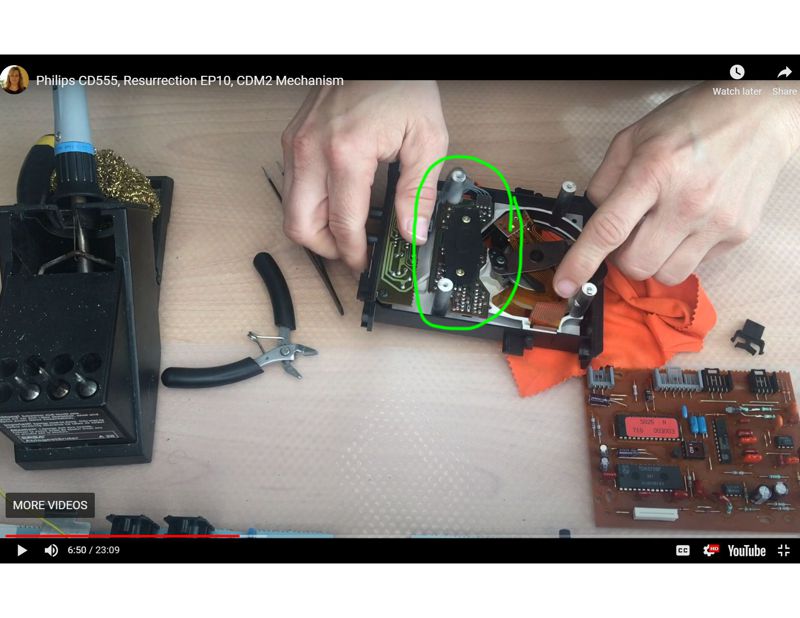

    Yes the CDM1 from the CD100 is very similar. The second generation, the CDM2 in this Sound Machine, is a "cheaper" version. Very special on this particular version of the CDM2/19 is that is has two PCBs on the panel - you can see this in your screenshot of the video. The capacitors you are talking about are in this case on the left, smaller PCB. Not sure why this is a special version, cannot believe it is just because of the vertical position since in Unit #2 a donor from a CD150 (horizontal player) is working perfectly. Only Philips will ever know.
    In my opinion it is always worth to replace all the capacitors and I am doing this before checking all other parts since a lot of issues were already solved by just a simple recap.
    I figured out the small plastic part helps the focus lens to stay even. It is placed on a thin metal foil and if it is missing the focus is getting crooked and cannot focus correctly anymore. I think you can hear this in the video - it rattles when it try to focus. Now the focus is fixed but it seems the weight of the tape I am using is too much for the coil to move the focus the whole way up when it is in a vertical position.

    Here are some pictures of the current progress for the digital counter. The D-FlipFlop for the CD-CPU clock is outside on the experimental board and I am running some more tests. And there's a video about the first part of restoring the tape mechanism...

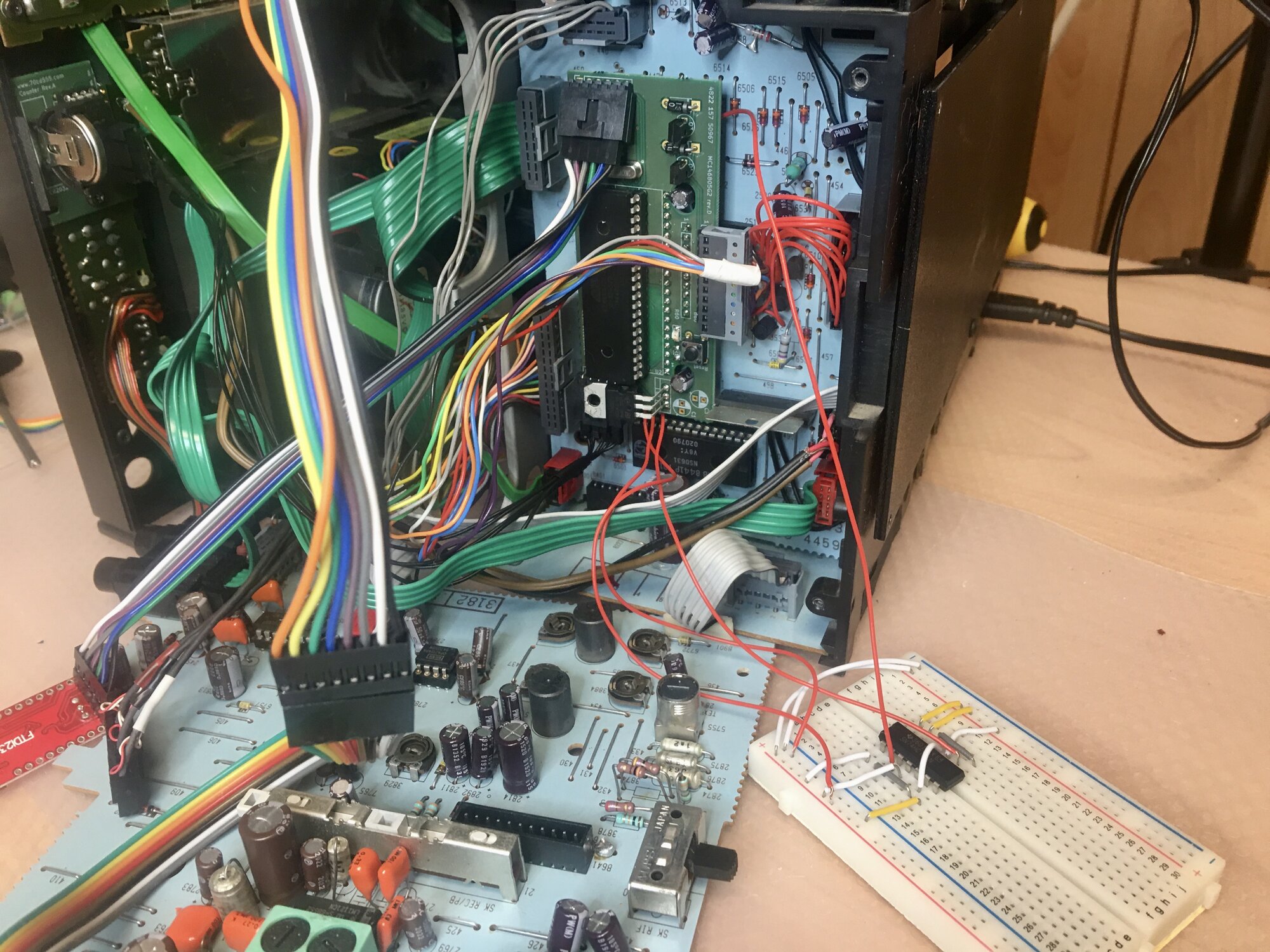

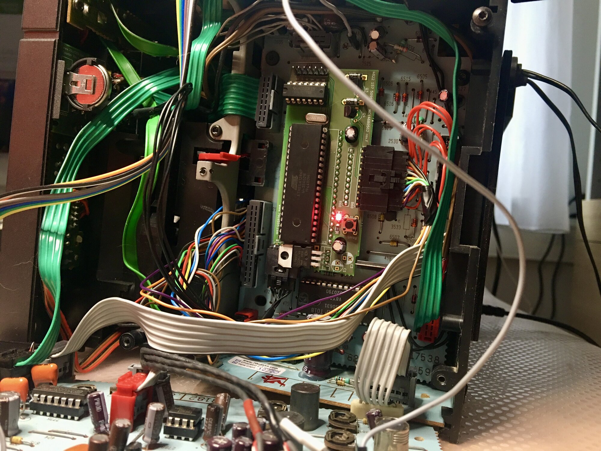

    I finally finished my CPU replacement hardware. The CD-Player CPU is working fine with the new clock at 4MHz and does not hang anymore. Well the software mights till need some tests but it is working great and I am very happy with the result.
    It's Christmas and as a small gift I've updated the website with more details to this modification. The kiCAD project can be downloaded and the software is available at Github. So anyone who is fancy to rebuild this modification can do this now :D However I am happy to help and might have one set of hardware left...

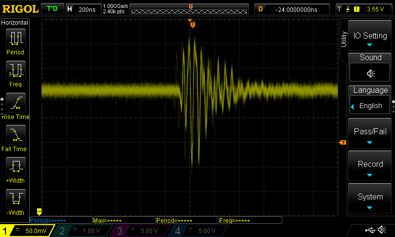

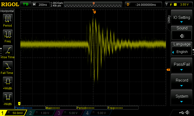

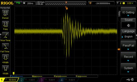

    On Christmas Eve my little bastard lighted up like a candle during my long term test. The smoking signals were not a good sign and I switched off immediately. However I have not found any issue, everything was working. Some days later everything failed and it was not working anymore. Seems that some components got stressed during the fire and finally failed. I had to replace two transistors and two fusable resistors on the power supply panel to get it back working. Took me another day of desperation.
    Now I am running again a long time test since a couple of days and everything is working great. Think the machine and I do have a kind of love & hate relationship.
    Also finished the second part of the tape mechanism repair video. I contains an unprofessional way (for the poor wo/man) to measure wow & flutter and to set the speed. Anyway, the method was working very good, better than expected. A recorded tape on the CD555 sounds also very good on my Denon devices.

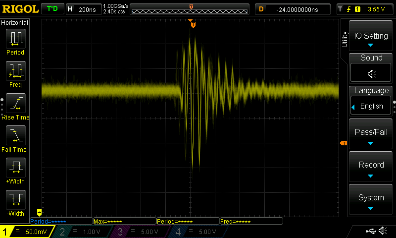

    Fun fact - I had an artefact during recording from whatever source I choose. I took me about 3 days of measuring just to recognise that the signal was coming from my magnifier LED lamp :eek::confused:
    Artefact from the LED lamp on the audio line about 37kHz ish...

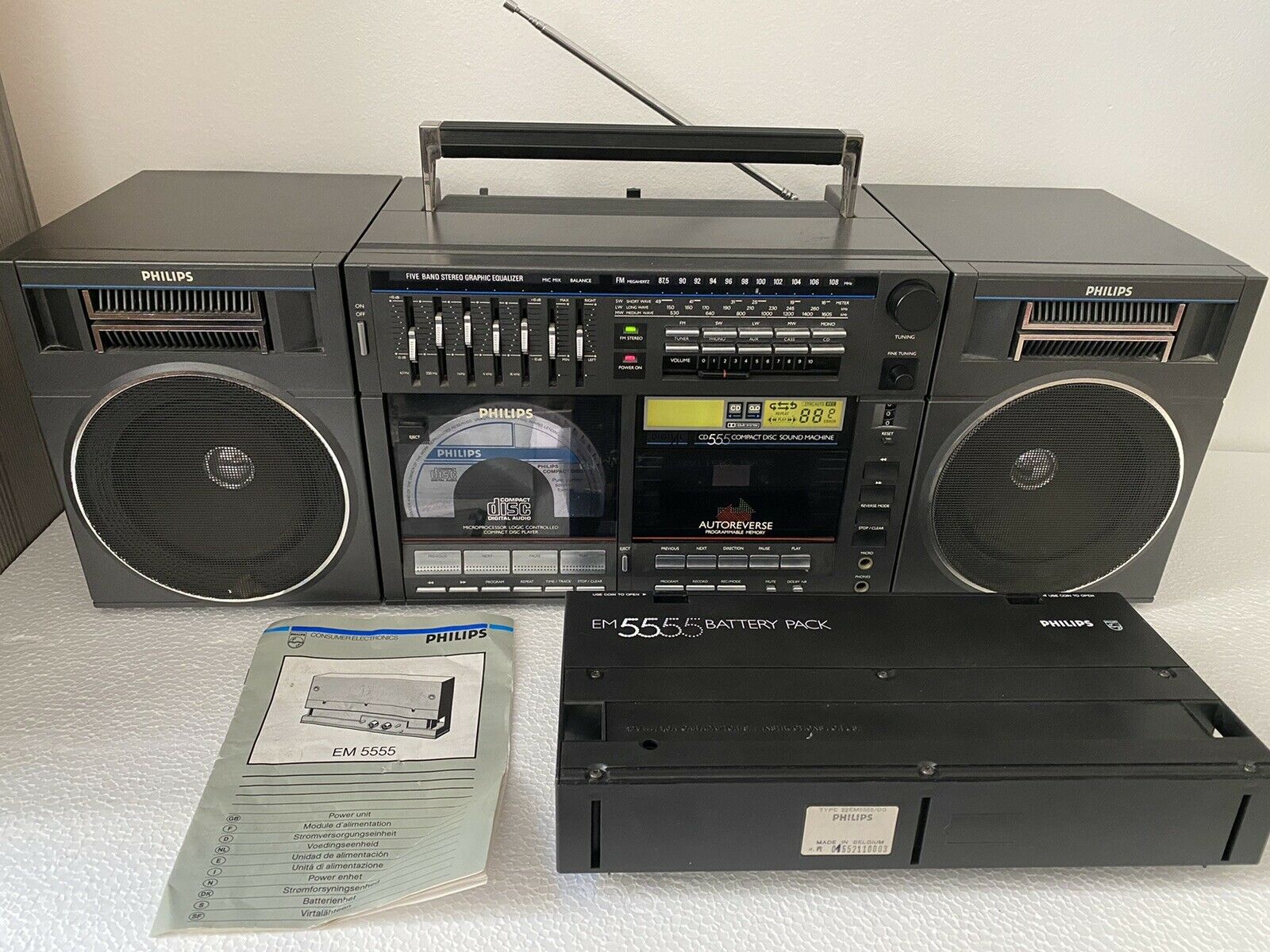

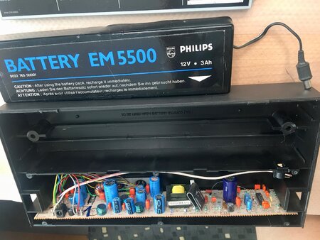

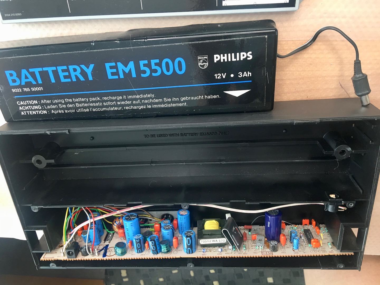

    Look what I've found on eBay...

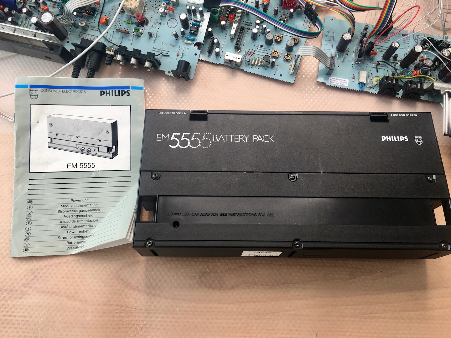

    Finally, after years of searching for the Battery Pack it showed up on eBay. Ordered without thinking twice.
    Well, the fifth Sound Machine, I must be crazy. But, although it is not working, it's complete with speakers and in very mint condition. Really happy. Now going mobile :cool: but need to train weight lifting before...
    Full Story and more pictures
    btw. CDM2 already repaired and tape controller replaced with my replacement CPU and tape fully working.

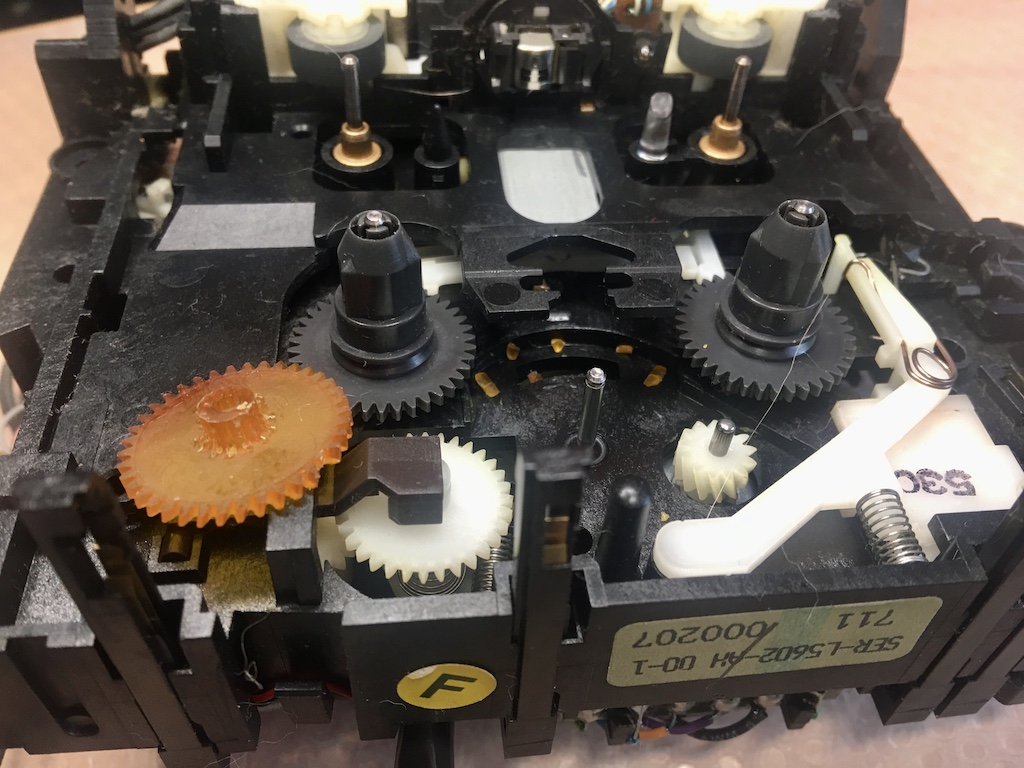

    When you think "wow the original gear is great and works like a charm" and at the very same moment it crashes and loses almost all teeth...
    It is such a pain to repair the Philips SER1 tape mechanism. But finally fixed all issues - and the gear was the least problem.

    it looks like now you can make a Wall Of Boom out of CD555!!! :) to raise stress level in your cat ;) he(she?) is beautiful, BTW

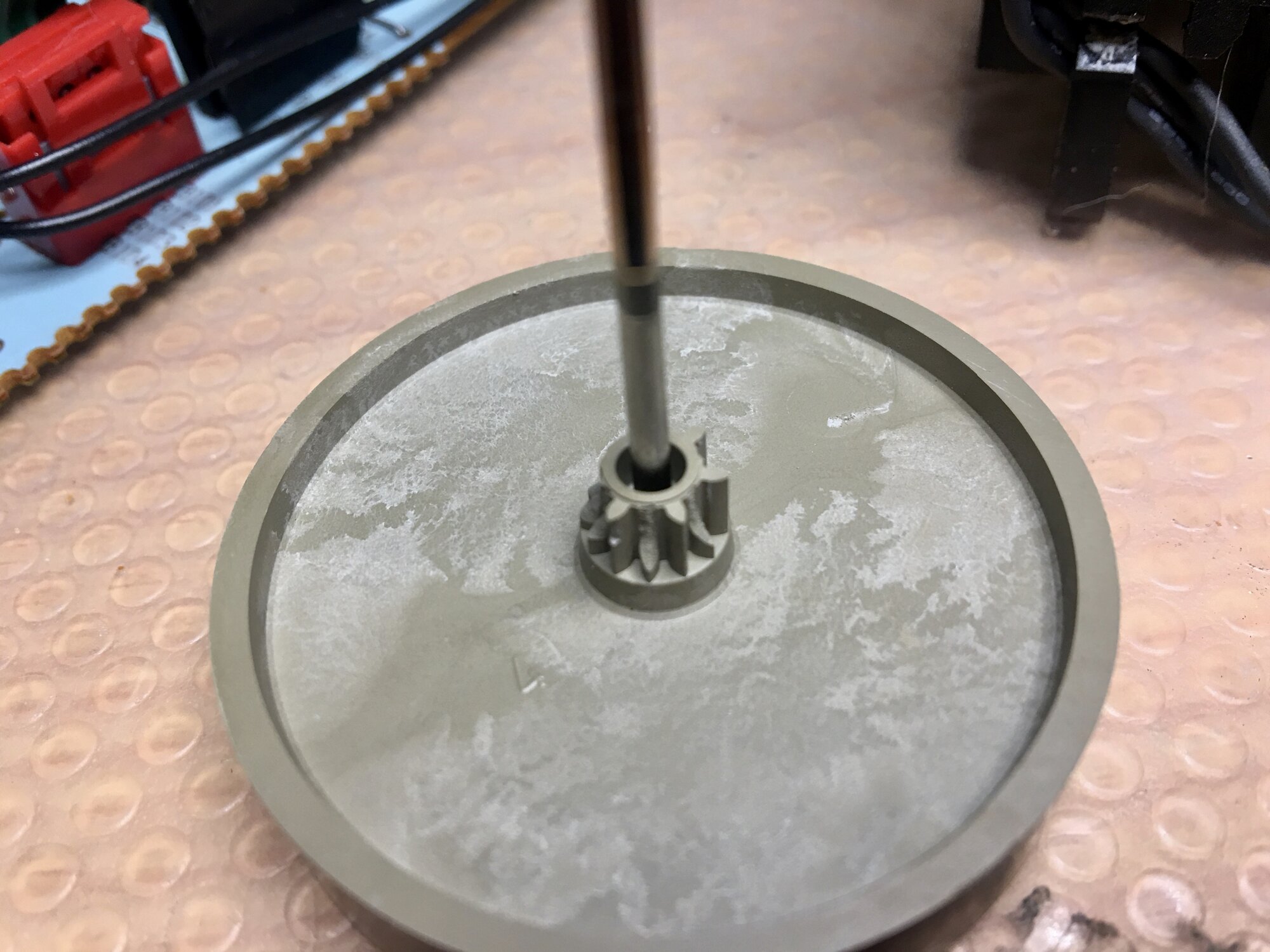

    how did you solve the least of your problems, did you buy or made that orange gear yourself?
