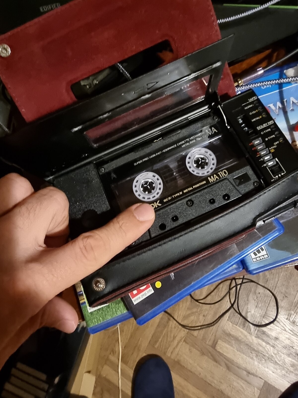

    Where do you press on the cassette to fix it ? Please put a picture for reference.

    Somewhere in here sometimes on another end.

    Ok, in regard to pressing the tape as suspected that is an indication the pinch roller is the problem.
    The tape itself will stay at an angle if you press on one side, so you will practically compensate for the misasligment the roller is creating.

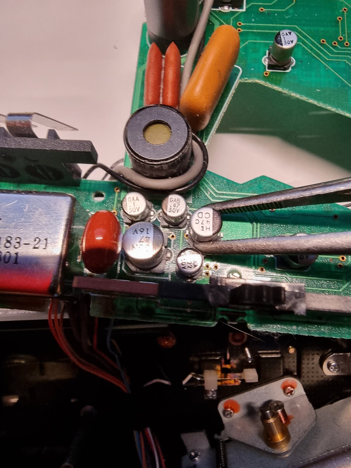

    I think the variable treble I was having problem with is gone. And It was a pinch roller for sure. I really cannot change the SMD cap. It is in such a place :( Will try to find pro who will do that. BTW I ordered replacement cap and missed in size and it is a bit smaller. Will it be an issue? Specs are exactly the same 16V and 47 uf
  15. Valentin
    1,658
    The capacitor can be smaller if it has the same voltage rating or a voltage rating that's higher than the operating voltage.
    Bigger is an issue here as it won't fit, smaller is good as it will be easier to solder it.
