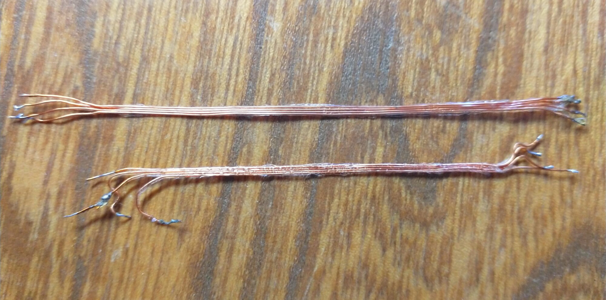

    If you need to replace a multi-wire harness, transformer winding wire is a good replacement. To make it look neat you can line up the wires on a piece of tape and coat them with something like nail polish. After a couple of coats, peel off the tape and coat the other side. Trim any excess. IMG_20260731_093222952~2.jpg
