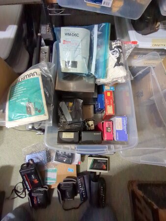

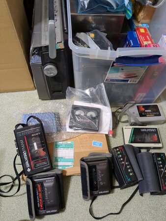

    One of my dd9s used to work a long time ago and I bought it and now it doesn't work and I can't remember which one it was but I have two of them and I really haven't put a battery in either one lately course. I have a lot of things. I haven't put a battery in it lately 1730313491693763797337966888839.jpg
    And then of course people may want to know what's still in the box. This is my $10,000 box of walkmans. I call it

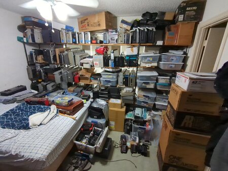

    Okay it talked me into it one more picture of the room. 17303136680207563068389001907306.jpg
    I could get carried away and show more pictures, but I'll leave this here.
