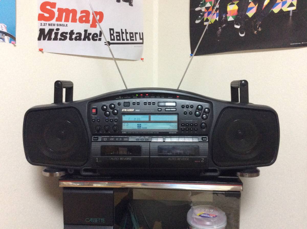

    The bigger QT-88CD never was offered outside of Japan. Only the smaller QT-77CD came into the western world – as CD-S77.
    Recently I could catch a QT-88CD for very low price directly from Japan.
    It arrived as usual – quite dirty and with a rotten battery compartment. Only radio was working, no CD and no tape deck.

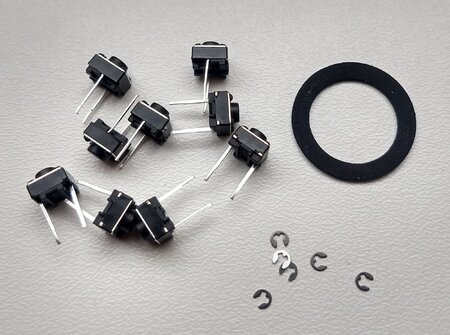

    After a deep cleaning I started the failure root causes investigation. Fortunately, as often for such old defective devices, it were almost only mechanical issues.
    On the right tape deck the left reel did not turn. I found, that the retaining ring on the reel wheel got lost. So the reel slid forward and lost connection to the gear.

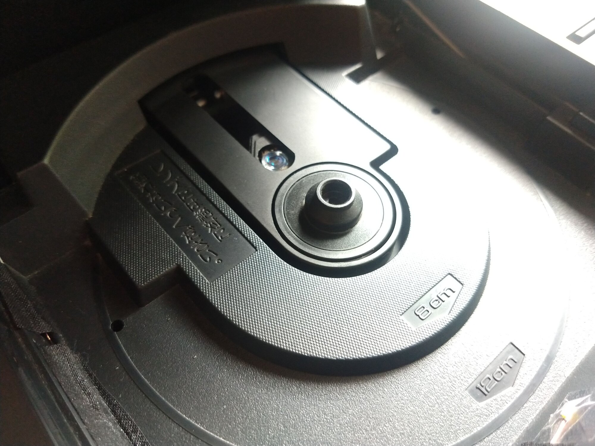

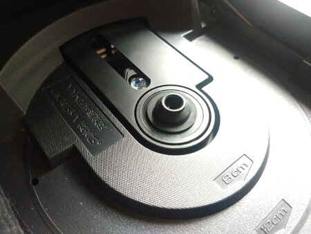

    On CD player the CD was not spinning. The reason was, that the rubber ring on the spindle motor, that lifts the CD a little bit and gives grip, had disappeared.
    Furthermore, a lot of the micro switches did not work anymore.
    The retaining rings and the micro switches I ordered online and for the rubber ring I took a sealing ring for water pipes, that had the right diameter. I just had to grind it down to a lower height.

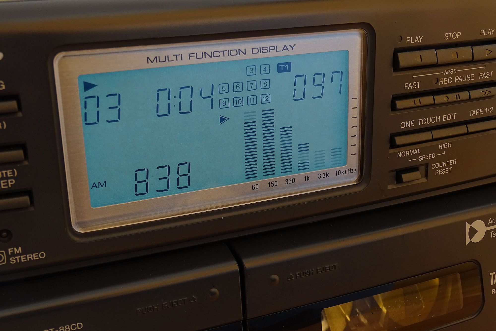

    Now everything works again. With the “Active Servo Technology”, that actually was invented by Yamaha, it gives a powerful sound. Interesting thing is, that the big display with its spectrum analyzer is illuminated even when the device is operated with batteries.

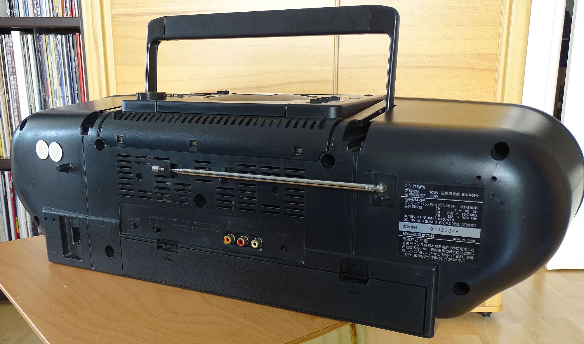

    Thanks for the photos, I thought the smaller unit looked like a Yamaha, I wonder if Sharp built the YSTs for Yamaha? The T-Tag on the back show Takaya as the manufacturer, they are the semi-conductor branch of Sharp. Neat box, I feel like it's a lot larger than the photos show.
  3. Mystic Traveller
    1,783
    Great photos of a good restoration done! I love the sharp's clear and bright display.
  4. rupi99
    rupi99 Active Member
    87
    33
    Germany
    Yes, Its is quite big and heavy. It is around 67cm long and 23cm deep.

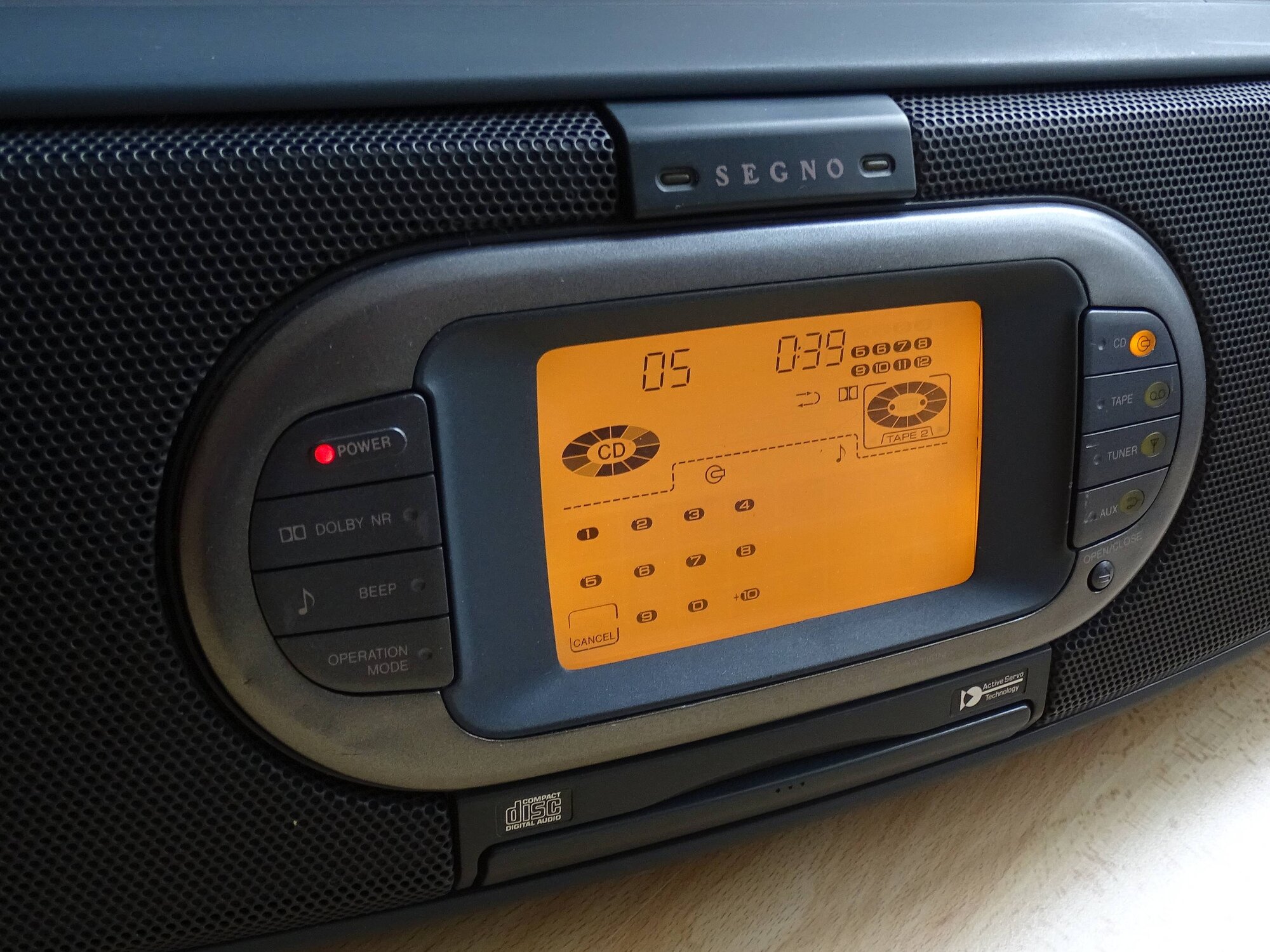

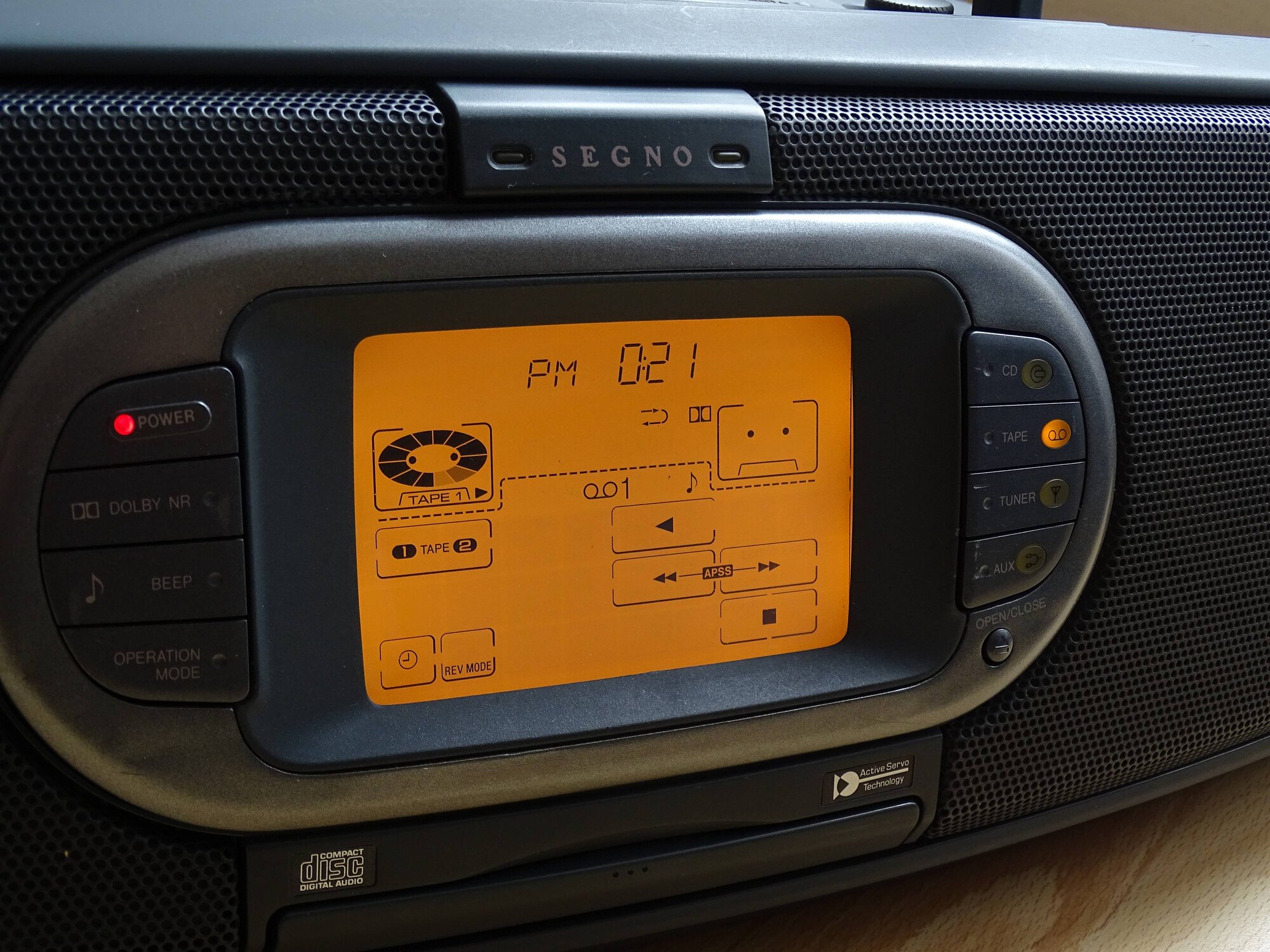

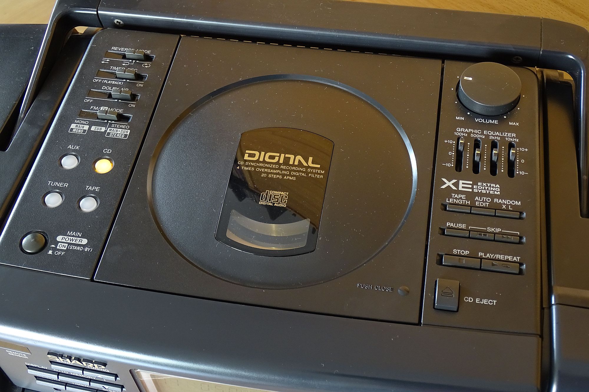

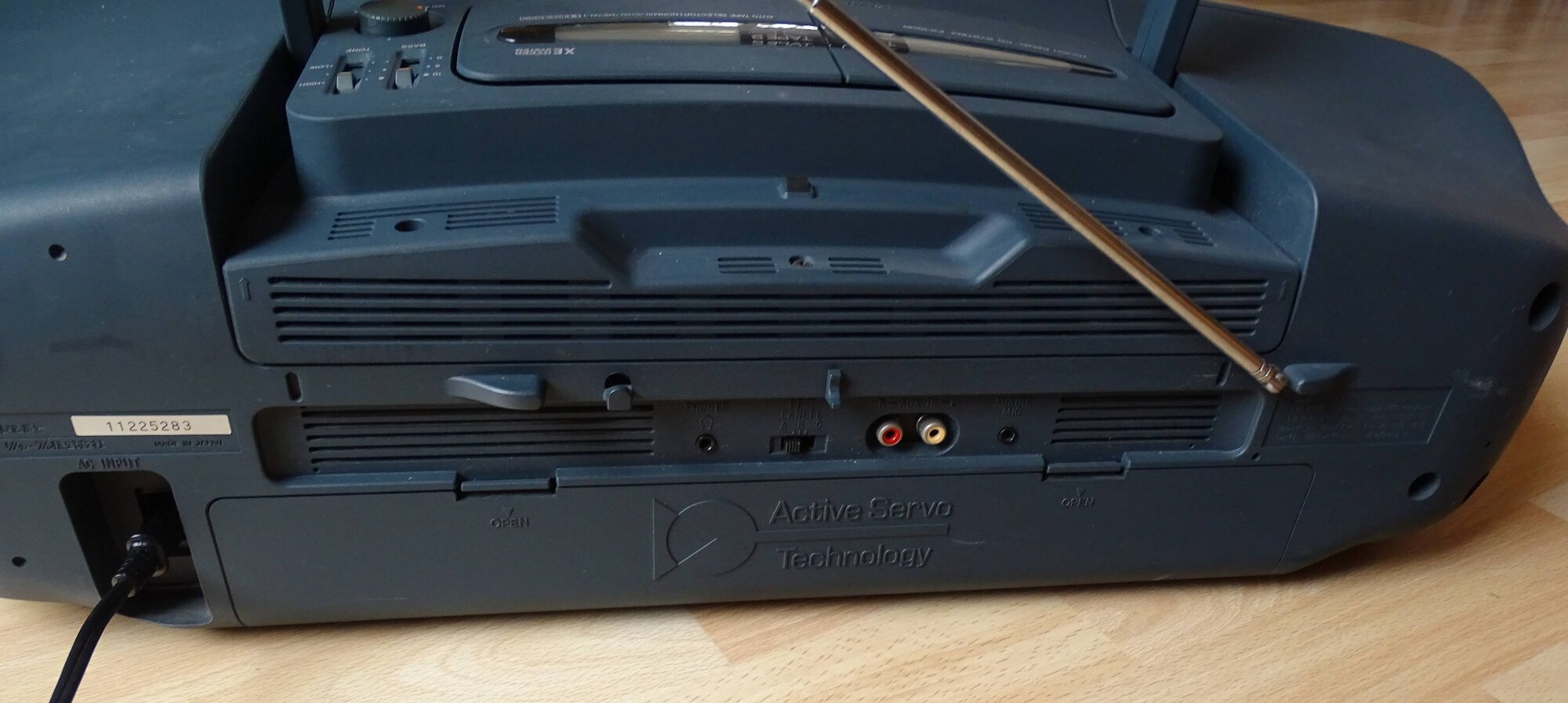

    It is a Sharp “Segno” FX-1000, the more expensive brother of FX-9000. In 1992 the MSRP was 66,000 Yen, at this time around 800 Deutsche Mark. I guess outside of Japan these devices are completely unknown.
    The highlight of this boombox is of course the big touch display, beside the “Active Servo Technology” from Yamaha for bass improvement. The touch display shows, depending on operation mode (CD, Tape, Tuner AUX), the relevant functions. Except sound and volume all functions are controlled with the touch display. With remote control also volume can be controlled (motorized potentiometer).
    There are 2-way bass reflex speakers built in, 10cm low-midrange speakers (10Watt each) and 4cm tweeters. They deliver a very nice sound with good noticeable bass. For sound adjustment it has only one slider for bass and one for treble, no equalizer and no DSP modes. But in my opinion this is absolutely enough.
    The power consumption is 38Watt at 100Vac. It can be powered also with 10 D-cells.
    The optical status for this more then 28 years old boombox is very good. A first test showed, that the tuner receives very good. Fortunately it covers the full frequency range from 76…108MHz; so no additional FM converter is needed.
    CD’s at first were not recognized (“No Disc”). After some trials CD started to run. Maybe the laser was a little bit “tired” and needed some movements back and forward. The CD drawer is sticking a little bit when moving inside. I already have seen this issue on a Japanese webpage and it is an easy fix.
    The tape decks were a little bit “rusted”; made some noise in the beginning and delivered a damped sound. After cleaning of tapeheads, capstan wheels, pinch rollers and cassettes running for some time the noise disappeared and the sound was clear.

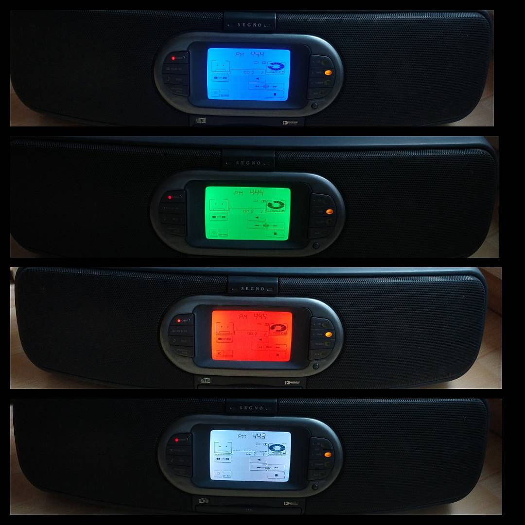

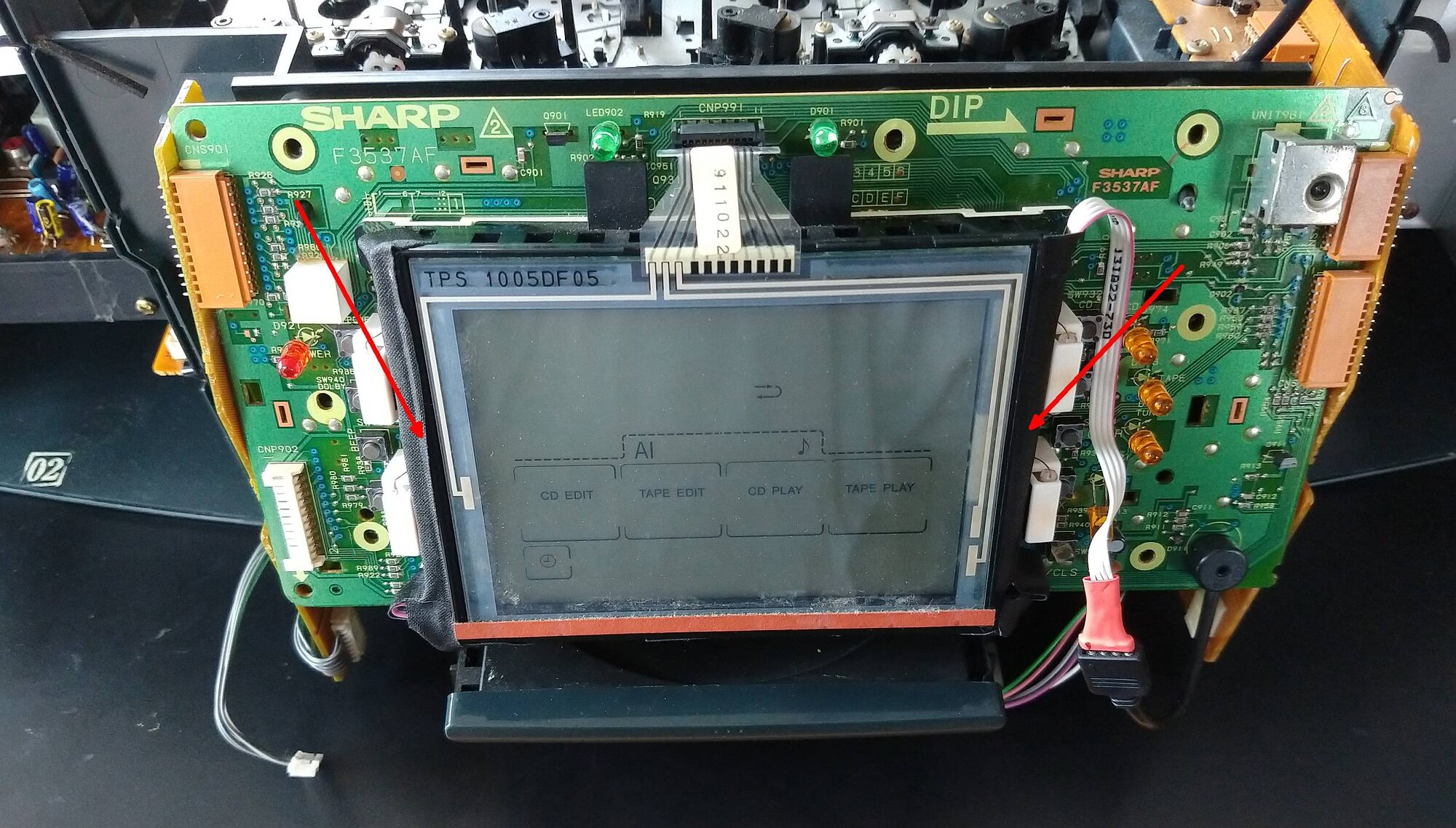

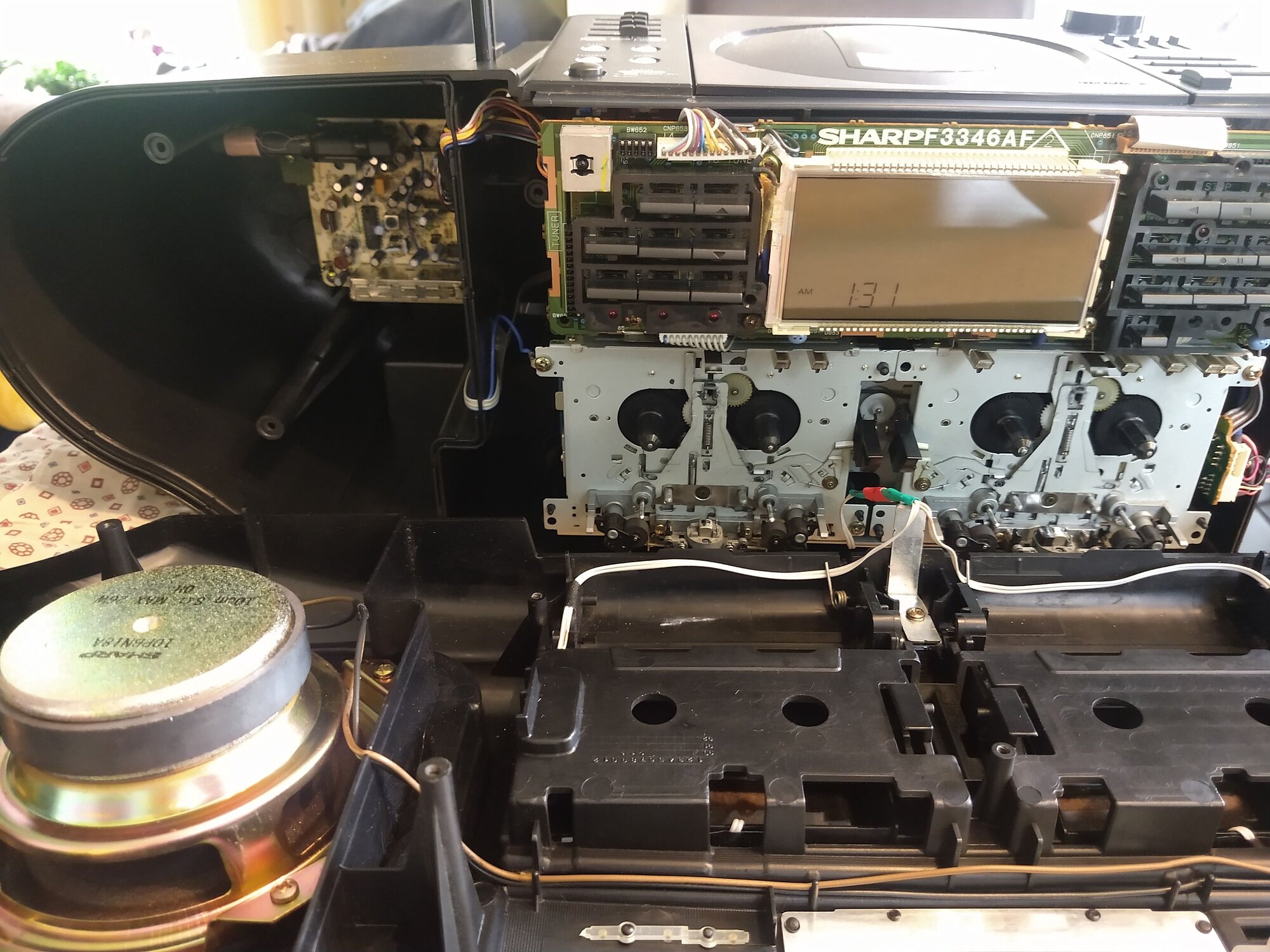

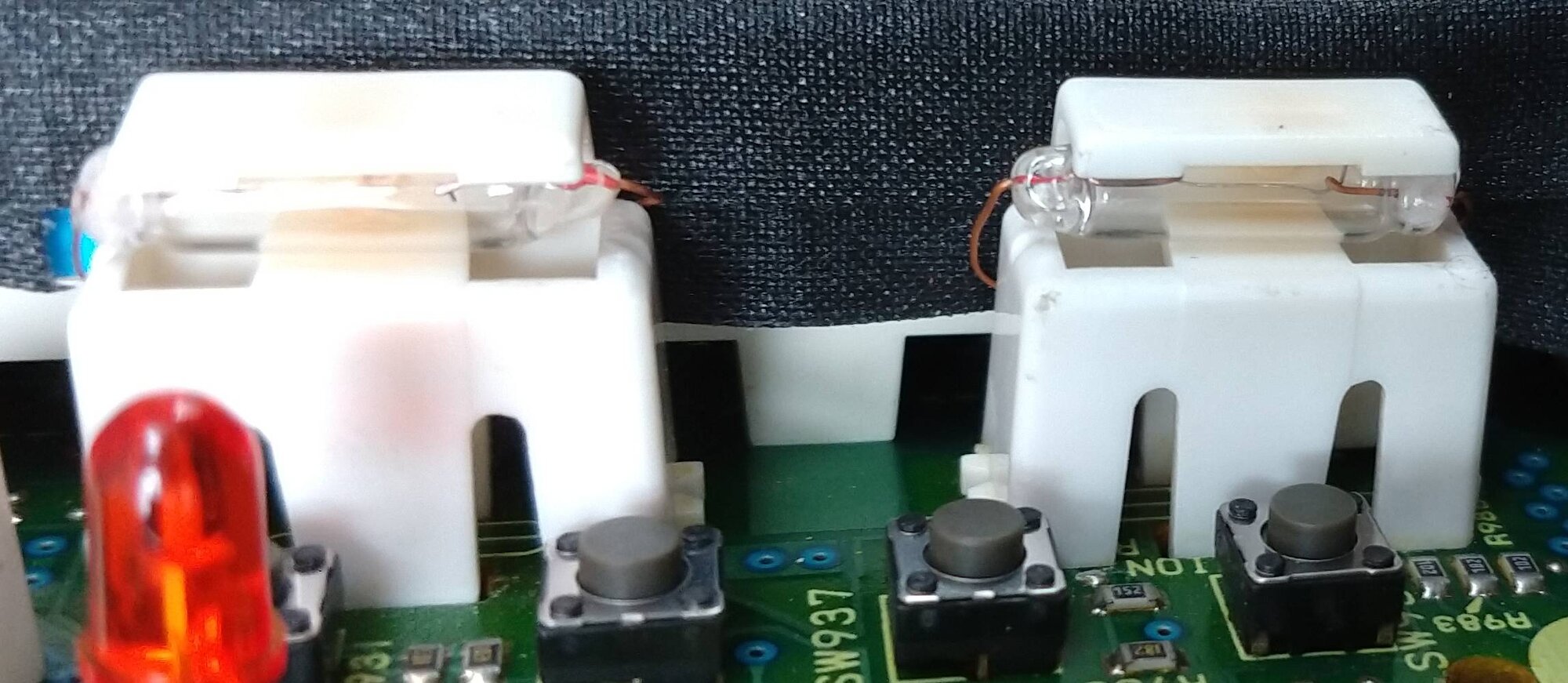

    Meanwhile I opened the FX-1000 to make some maintenance. Cleaned and lubed it.
    The huge display is illuminated just by 4 small incandescent bulbs, that are working only when connected to the mains. Furthermore such bulbs are getting hot and have only a limited life time. So, I decided to change them to LED. To make it more flexible, I built in RGB LEDs, that can be controlled with a smartphone via Bluetooth. And they work now, when running on batteries.
    As usual I added also some (yellow) LEDs to the tape decks.
    Below some pictures and a video
    Original bulbs
    RGB Controller
    Ready
