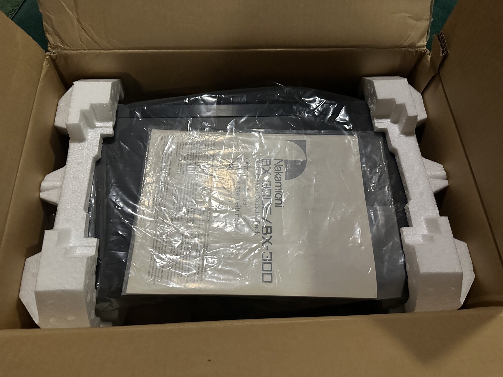

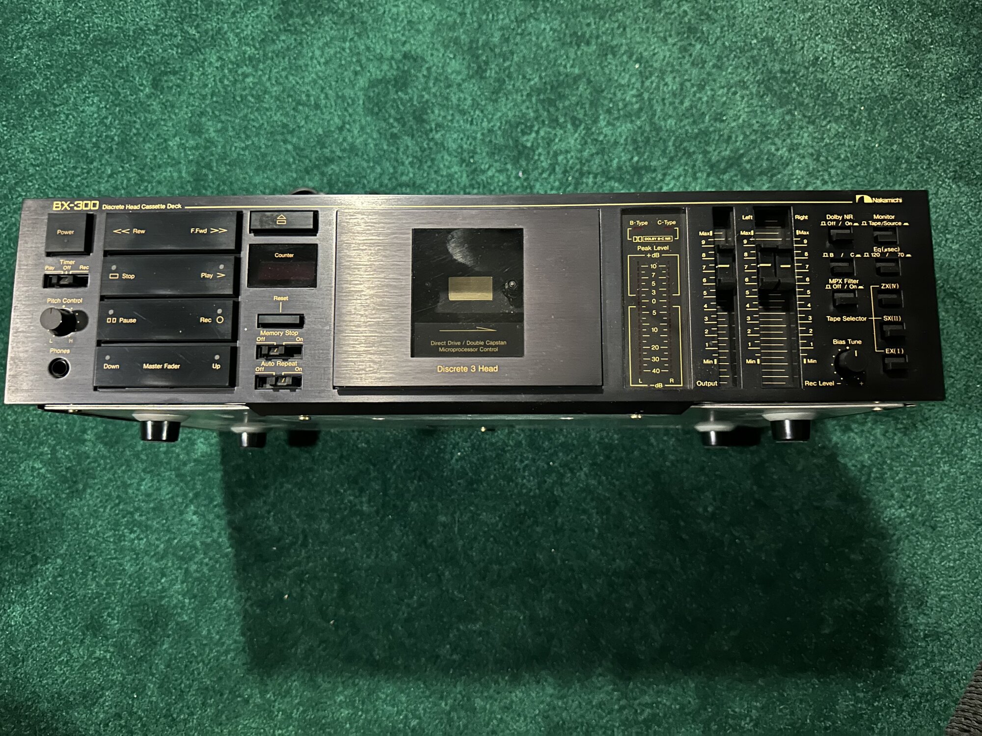

    85AF1B14-9735-4CAB-85AE-5D547ED4156B.jpeg DAB02FD8-0F1C-4800-BB74-2CB5E286A10C.jpeg 6E6F1432-A72A-4DF4-976C-F6E951ABCA30.jpeg Arrived safe and sound. I don't think that there is a mark on it anywhere. Too bad it's so cold, I'd love to fire this up but I think I'll at least wait till later tonight or the morning.
    edit;
    this is crazy, the pinch rollers look like new, not dried out still soft. Opened it up, the one belt that I could see spins freely, still soft, doesn't look overly stretched. I guess when he said it wasn't hardly used he meant it, and sometimes that's a bad thing and they need to be used but I think I lucked out on this one.

  4. Elite-ist
    271
    Squamish, B.C., Canada
    John: That is a nice way to start the holiday season, audio-wise. It's a keeper!
    Nando.
  5. overmodulated
    overmodulated Active Member
    250
    US
    Yes although my joy was short-lived. It plays for about a second and stops, also fast forward and rewind's for two seconds and stops. There is briefly
    sound coming out of it.
    Taking off the front cover in the well, it is the gear drive, it doesn't have the tire, and probably needs the motor rebuilt because it's flat spotted, at least I hear that's what the problem is with these. I sprayed a little deoxit in there and exercised it but no joy.

  6. overmodulated
    250
    US
    First time I came across the belt that's turned to goo problem, and it appears to be a belt problem. I am hoping to replace it myself and it appears it would be a lot easier to change by taking off the pulley.
    The take up pulley is retained by a small nylon clip or washer. Does anybody know where to get these from? I'm having a hard time finding them, and they're not exactly a C clip but it looks like there is a break in it so you can work it down on the shaft and click it in place.

  7. autoreverser
    1,870
    rebelt a BX-300 is not a miracle, you‘ll gonna make it :thumbsup:

  8. overmodulated
    250
    US
    I ordered a belt kit and hopefully that takes care of it.
    I actually found the belts pretty close by to me, and I'm hoping they are good quality.
    17,064
    I'd have to see the clip but any of those small parts are a pain to find unless you have a parts unit. Sometimes Amazon/Ebay have misc packs for sale and the right size might be in there.

  10. overmodulated
    250
    US
    Thanks for the replies, and I will definitely keep those places in mind.
    I ended up finding the little washer clips at nakamichi.us and it appears he has everything Nakamichi. Not cheap but the main thing is it's the right part.
    The the larger belt that's inside the unit has a little bit of slack in it and should be replaced, but looks like it's above my pay grade to replace, but I may be able to do it if I can find the right instructions. I can't find good instructions anywhere, and even the service manual does not have anything in there about replacing the belts. No YouTube videos for that exact model that I can find. If anybody knows where I can get the instructions or video for this I'd be grateful.
  11. TooCooL4
    3,273
    Best to get it to a tech that knows what they are doing, doing it yourself and you may end up costing yourself more money or worse still you end up with a nice doorstop.
    I use to put in my CR-7 for a full service every 2 - 3 years when Bowers & Wilkins Nakamichi was still around, they closed down the service centre about 3 years ago. So I need to find a new company for servicing my CR-7.
    Looking at your first image above, are you resting the unit on it's RCA connections on the back? If so, that's not good.
    overmodulated likes this.
  12. overmodulated
    250
    US
    Thank you the tips, I agree and won't mess with the rear belt in the back of the transport, the front one I can put on, and I already had the real off and cleaned all the belt goo off of it. I've learned over the years it's better to leave things go than to mess it up for sure.
    It was resting on the RCA's briefly and it's a nice soft carpet and I definitely wouldn't leave it that way for a long.
    I've heard that the B&W service over there was top-notch for the Nakamichi decks. Fortunately there are a couple here if I have to send it out, but I'm hoping the front capstan belt will solve my issues for a short time until I can secure a tech.
