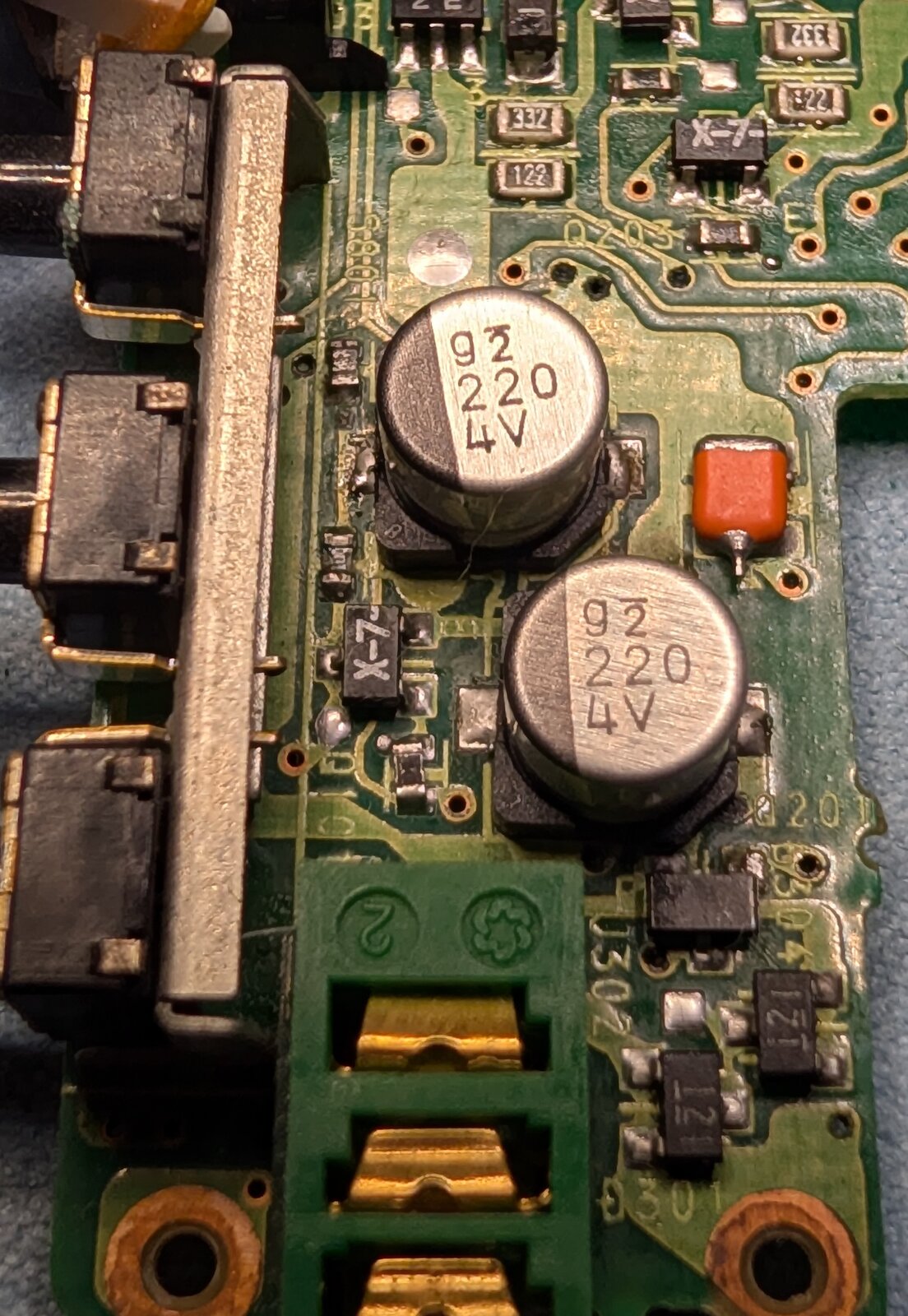

    Hi everyone,
    I hope someone here can help me. I inherited a D-Z555 and have replaced the gear and the three bad 100nf/6,3V capacitors (exchanged for 2x 220nf/4v 1x 100nf/10v) in it. The music is a bit louder now, but it "scratches and hisses" very heavily during playback. And when I turn up the volume, the sound actually gets quieter. Does anyone have an idea what this could be, or how I might fix the problem?

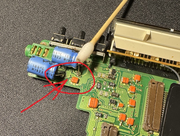

    Re-replace the headphone coupling caps and clean every board trace / pad before during and after should do the trick.
    Oh and pictures please! :wink:

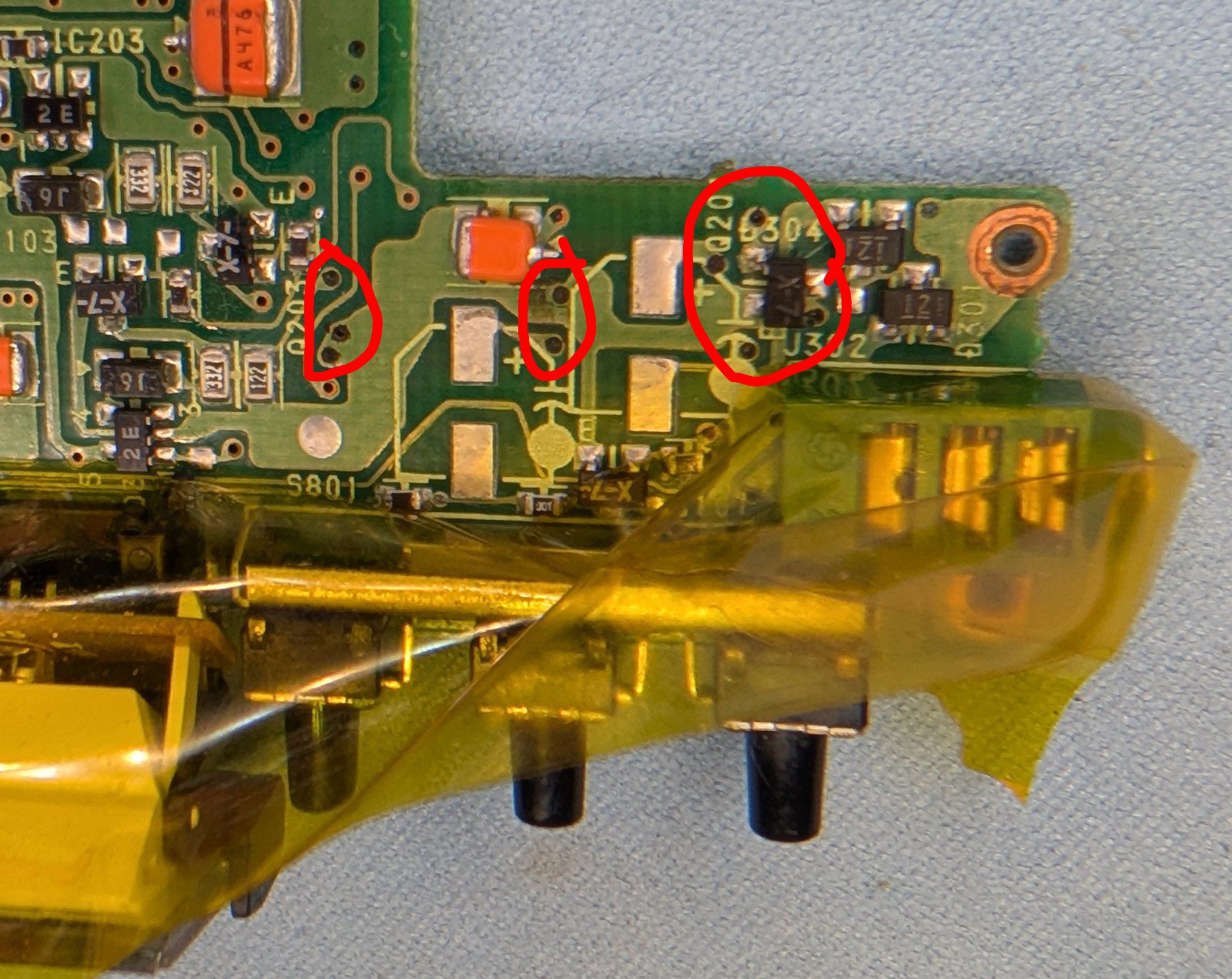

  18. Jorge
    1,794

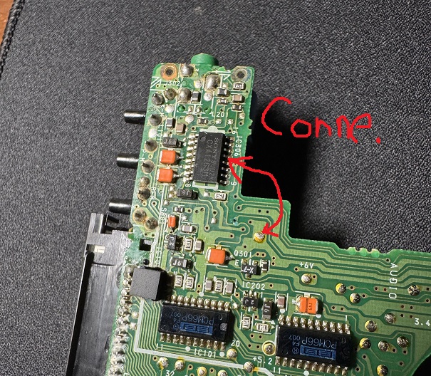

    I presume that you double-checked the continuity for all these black vias, they look affected by leaking SMDs:

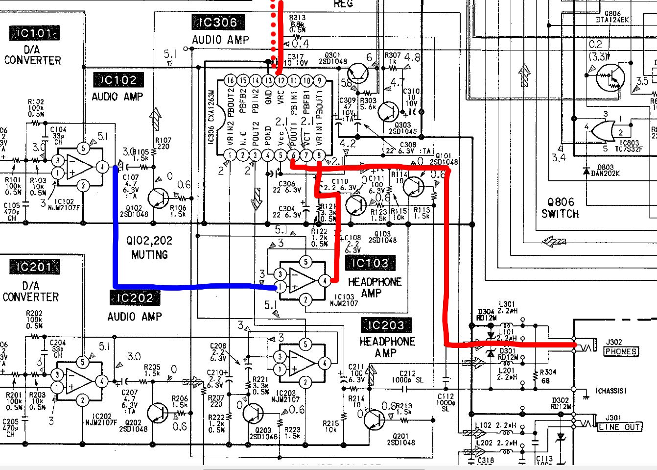

    Now, if what you described is 'just so' then we have the following for the Left Channel: all is good up to IC102(4) and then, somewhere downstream, signal gets garbled.
    Where?
    Since you note exactly the same badness for L and R channels, and in D-555 these are totally discreet, the prime suspect is IC306 which works as Volume Control for both
    OR bad Ground // Power for both IC103 and IC203 would give the same result for both channels - check those also. (5) for VDD, (2) for GND
    Check that IC306 gets good VCC at pin-5 and good Ground at pins 4 and 13. With music playing check what happens to Left Channel when you short, for a sec, with mini-probes (or piece of wire) in steady hands, pins 8 and 6
    IC306(12) is the pin which gets Volume signal through CN805(15), from IC851 located in the lid of D-555. CN805(15) is at the edge of a connecting flexboard, when these crack because the lid was opened/closed one time too many, this is where cracks usually start...

  19. Chen Bin
    Chen Bin New Member
    Guangzhou, China

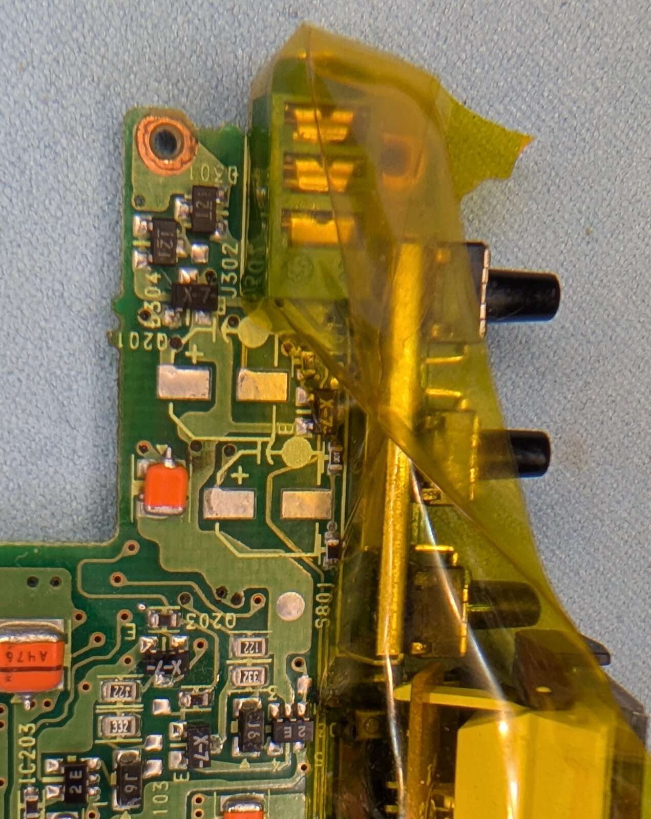

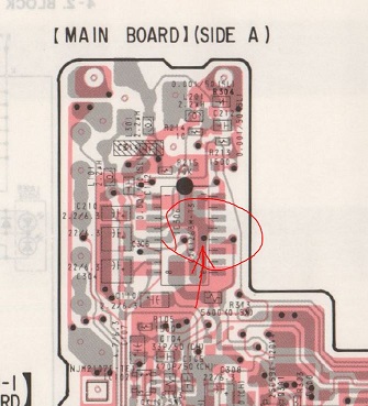

    I have same problem with Marc2025. And in my case I found the root cause but I don't konw how to fix it.
    The root cause in my case is that one of vias underneath IC306 is blocked. As a result, pins 4 and 13 of IC306 cannot be connected to ground.
    When I used tweezers to connect pin 13 of IC306 to ground, the sound in the headphones became normal. I don’t know how to repair that blocked via.
    I tried using alcohol and a sewing needle, but I still couldn’t repair the via.
    Does anyone have any good suggestions?
  20. Jorge
    1,794

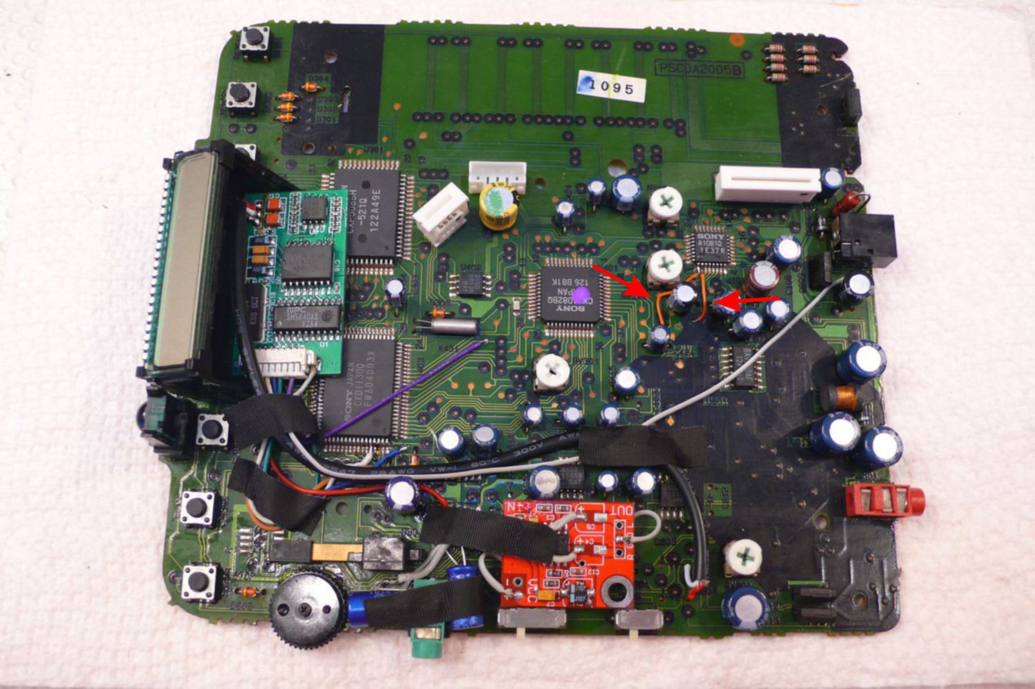

    @Chen Bin - that is easy, just use a 'bungee' to connect IC306(4) to the neatest GND. Short piece of isolated wire, I use 28AWG PTFE-coated single-core wire.
    Here is Denon DCP-50 upgraded for me by the King of Discmans, Master Kaosun (kaosuncd.com) to DCP-150 status. Red Arrows point to the fixes to the damaged board, pieces of Orange wire
