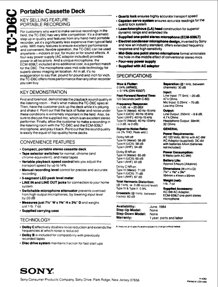

    I don't know if I've seen this brochure posted yet? It looks like it's dated 4/84 and appears to be a salesman's guide for the new "C" Version.
    Emiel likes this.
  10. dotneck335
    dotneck335 Active Member
    127
    Los Angeles, CA
    What is the difference (if any) between this model (TC-D6C) and the Walkman WM-D6C?
    19,946
    Good question, I didn't notice that!
    Either the marketing/printers didn't do a test print or Sony was going to do a "TC" Version. I think "TC" traditionally, for Sony, stood for portable tape decks using some of their early cutting-edge engineering, maybe they wanted one version for professionals, and sold by the professional sound companies followed by the prosumer "WM" Model stocked at your local camera shop.
    Personally I don't know when they dropped "TC" and what the last model was.

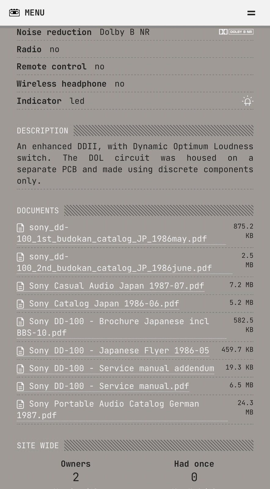

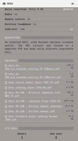

    19,946
    I checked over there and didn't see it in the advertisement photo listings?
  15. Emiel
    1,115
    That is correct, we also link to PDFs. You can find the catalogs and brochures here per model:
