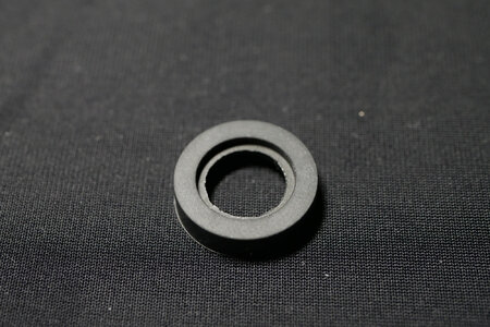

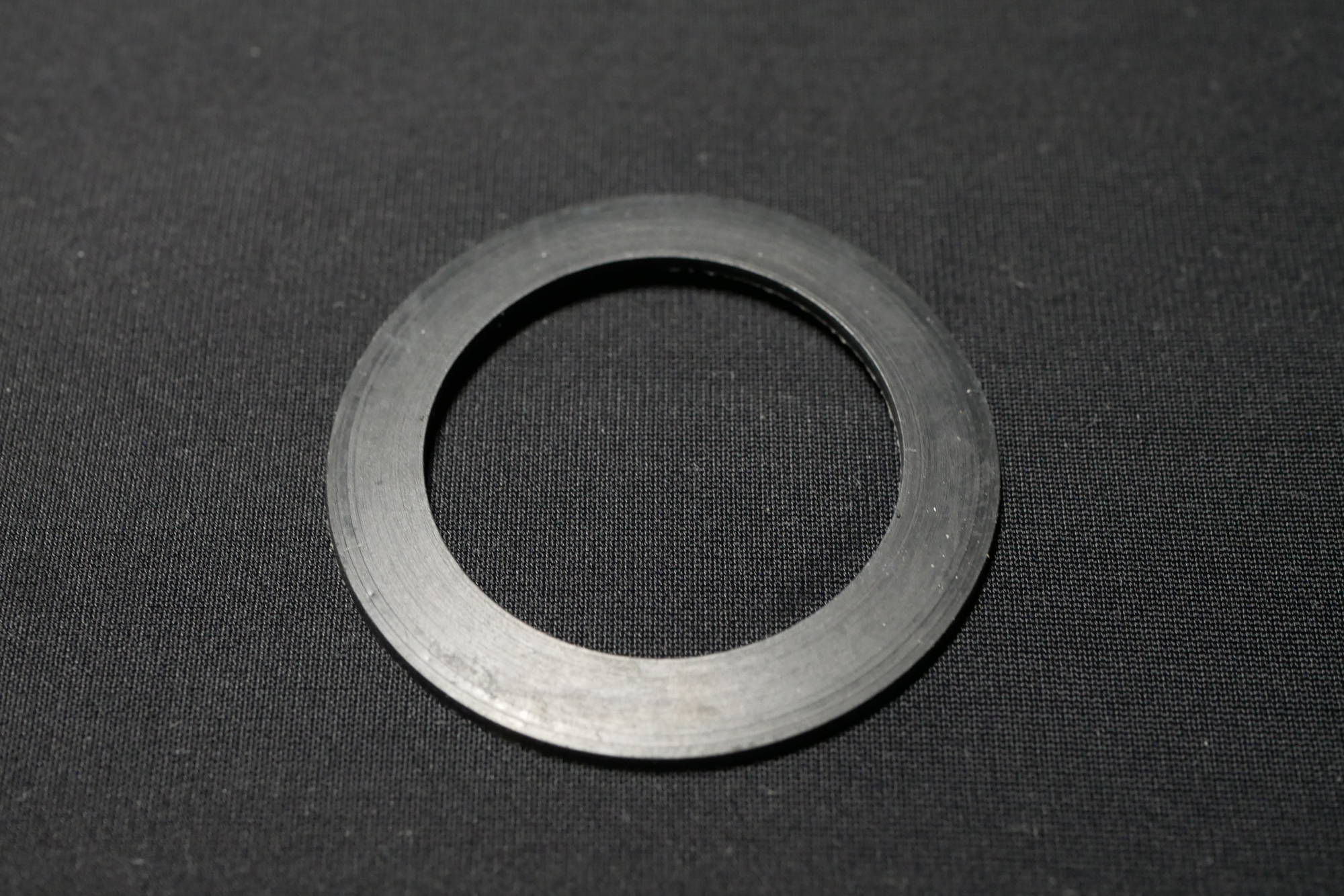

    1. Marian has stated that because the capstan ring is very hard to remove on some units, he cannot sell a replacement one as a DIY kit. That is indeed a problem I have seen myself.
    At the current number of backers (9), the cost per person will be around 222euros so it's probably too high for people to support the project anyway.
    2. In the meantime, I did find myself replacements for the T-shaped play idler. For the capstan ring I knew a source before, but the quality of the part is not as good as the original,
    being made form natural rubber and not as uniform, so that one will render higher wow&flutter than the specification and it's why I have not shared it.
    The belt kit is available from DeckTech: https://www.ebay.com/itm/224456248572
    The T-shaped idler: https://www.ebay.com/itm/314730104076 (link not working anymore, product has either been re-listed or it's no longer available)
    The capstan ring I was reffering to seems to be out of stock at the moment, so in case it comes back in stock I will update the thread later on.
    The rubber on Yahoo Japan looks to be of very good quality, the seller has even provided a measurement of wow&flutter showing a figure lower than the specification.
    However the kit is not exactly cheap and importing it from Japan will add to the cost (VAT and shipping), so I expect the final amount for someone in Europe or US to be $150 or more.
    Considering a TC-D5M can be found for as little as $200-300 in good cosmetic condition and with rubber in restorable condition, the value of such kit is unfortunately debatable.
    Compared to the cost of a D6C rubber set which contains 2 idlers, 2 belts and 1 capstan ring ($14.5 at FixYourAudio), this one is more than 6 times the cost despite it only contains 1 more belt and 2 more idlers.
