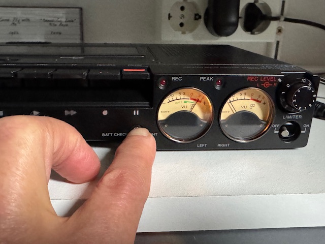

    "Testing is easy. In that case, the meters will illuminate when the light button is pressed."
    That's the case!! The light's go on when I press the Light Button. And the left meter goes completely to the right. So it must be the left channel that is not releasing properly. Record level 'zero'.

    Left VU-meter acts as battery level check (see the green marking), that's why only the left needle moves.

    When you press the light button, a single meter acts as a voltage gauge. That's why it deflects to the right. It indicates the battery status.

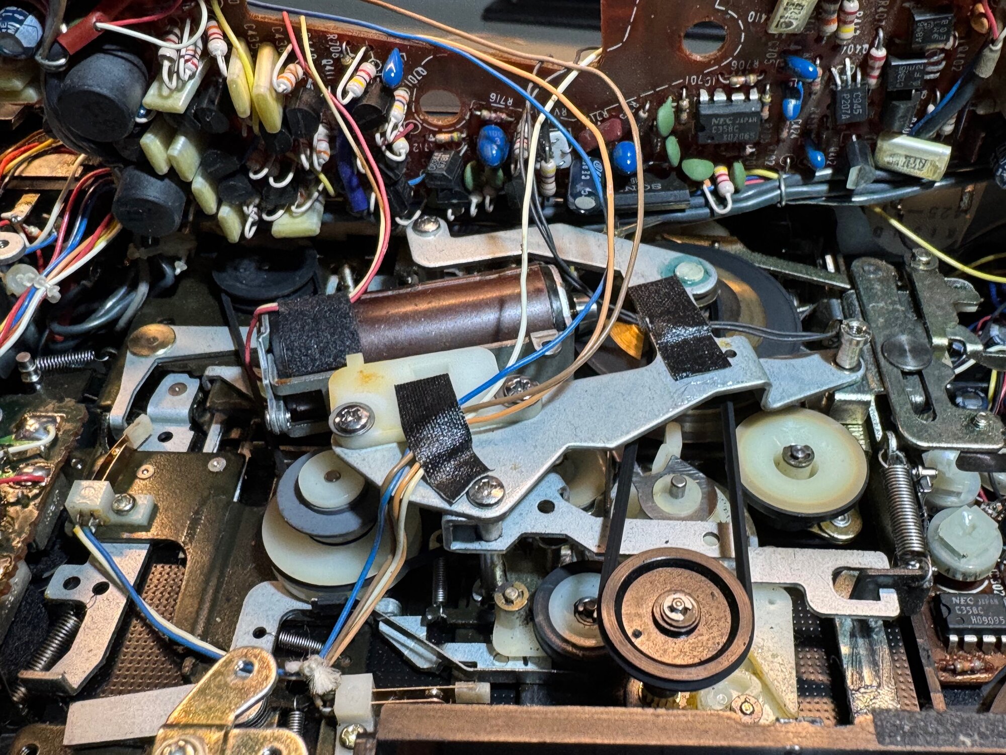

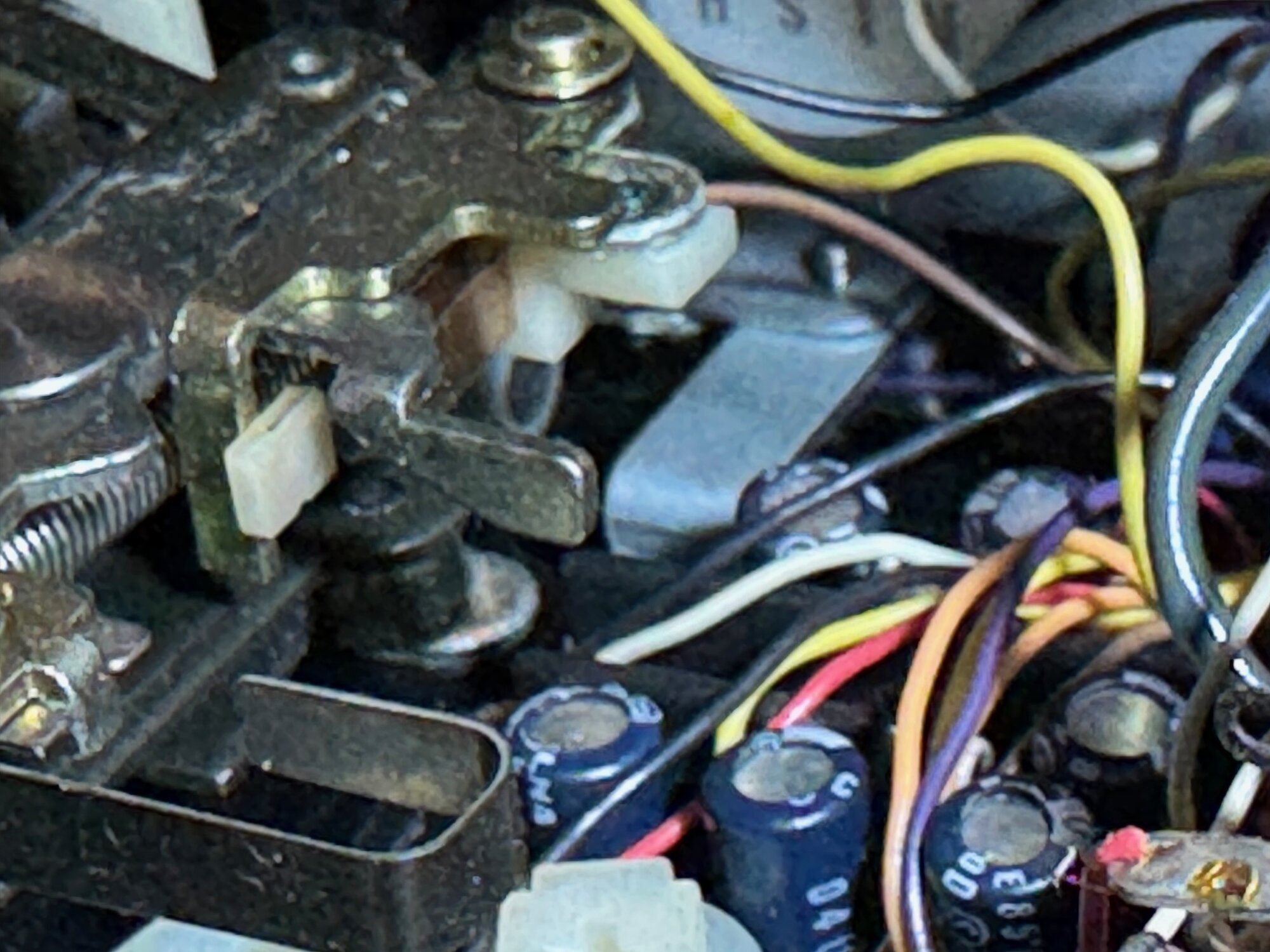

    I checked the four leaf switches in my D5. All are working as mentioned in the service manual. So there must be another component that is causing the high current in stand-by.
