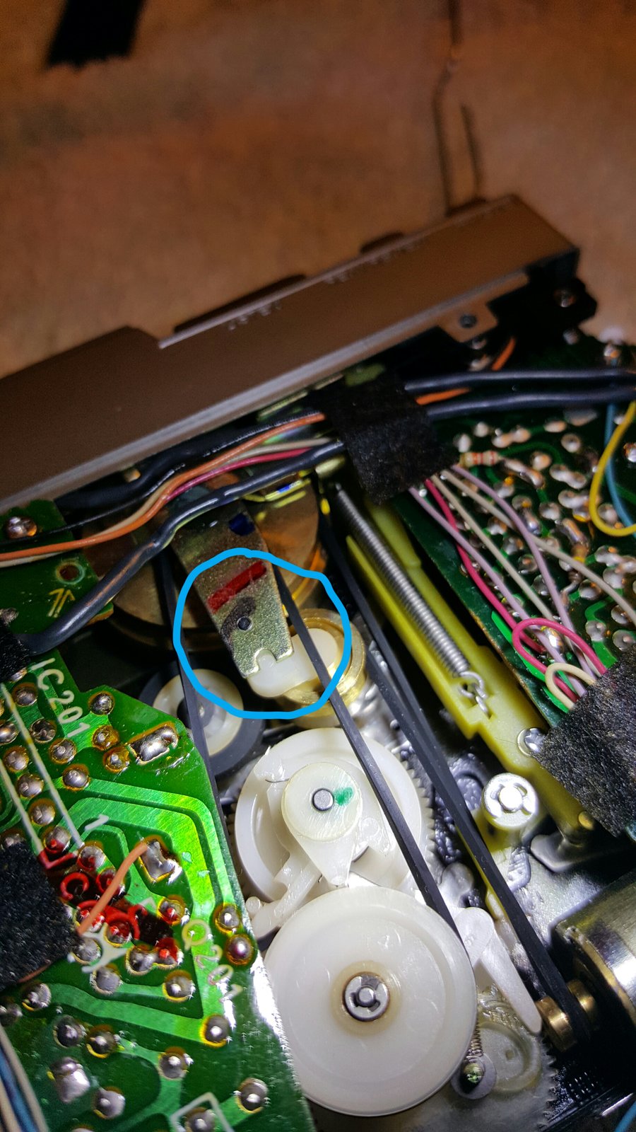

    So I noticed if I press down slightly on this part the noise goes away and the music sounds better (I plugged some headphones in and as it runs now the music sounds like it has a lot of echo and is wavy) but it does not look like anything is pinched or holding it up, any ideas? I'll have to keep looking around

    See if that (the flywheel holder) is installed properly. If it is, Do a Flywheel thrust adjustment. There's a white screw on this part that you adjust until you get lowest wow/flutter with the least load on the motor- check the service manual.

    My TPS-L2 has more then wanted w&f..... How to do a correct Flywheel thrust adjustment? I dont have the SM.... Thx
