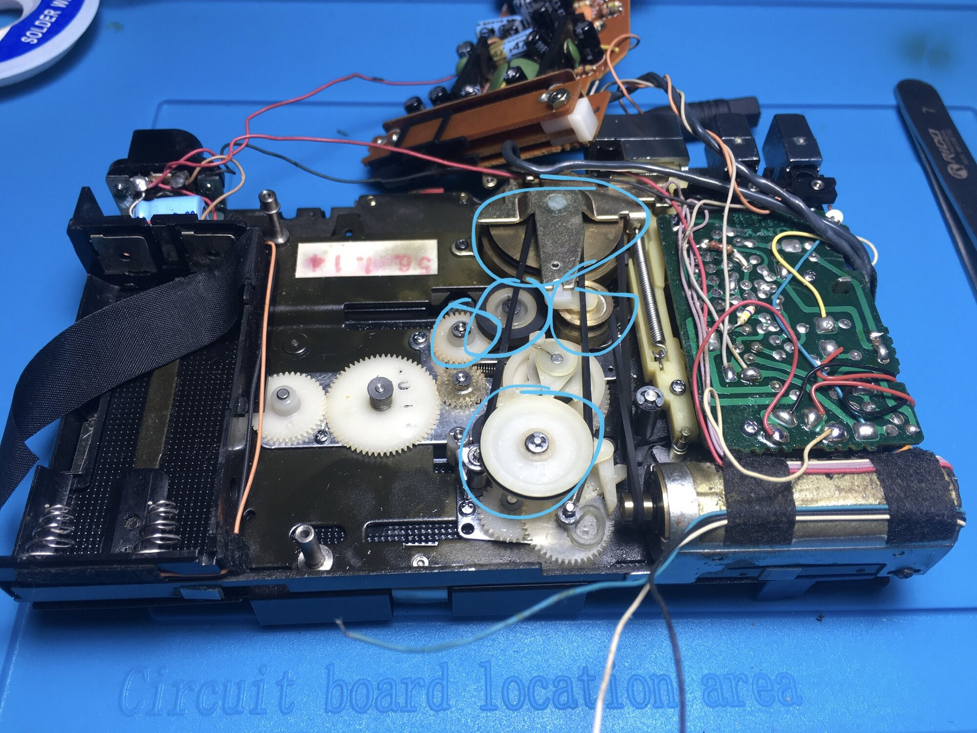

    In regard to cleaning and oiling, I think it's best to upload a picture with the mechanism (can be one found online) and mark on it exactly what parts you have oiled.
    This way I can tell exactly if there is anything you have missed or not.

    Oiled parts i showed in blue.
