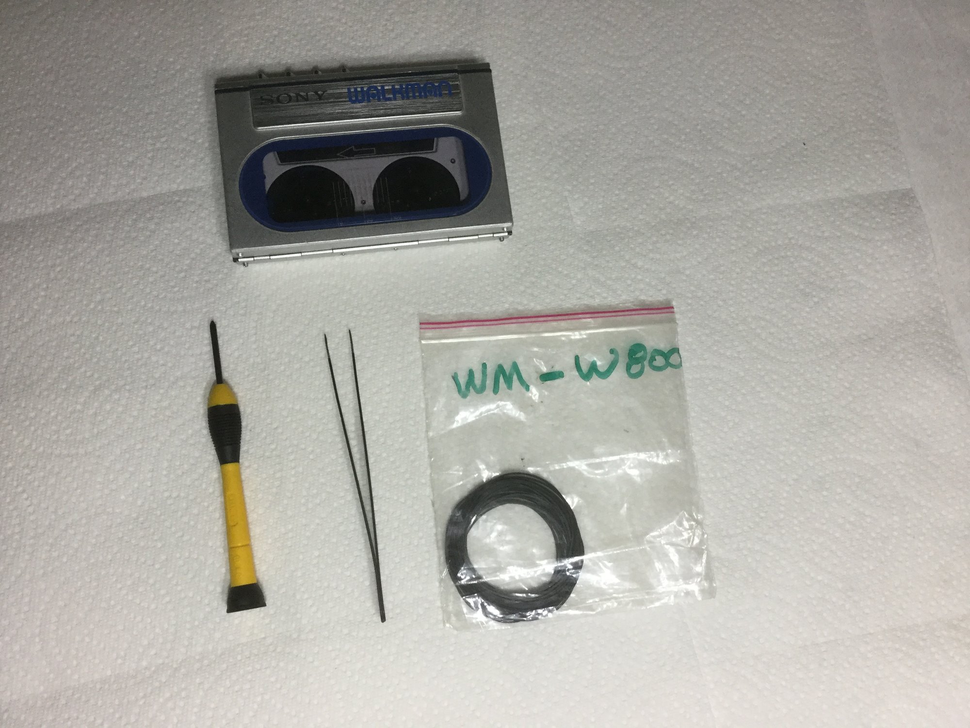

    East steps to change belts on your WM-20.
    You need a tweezer and a small screw driver and obviously appropriate size belt

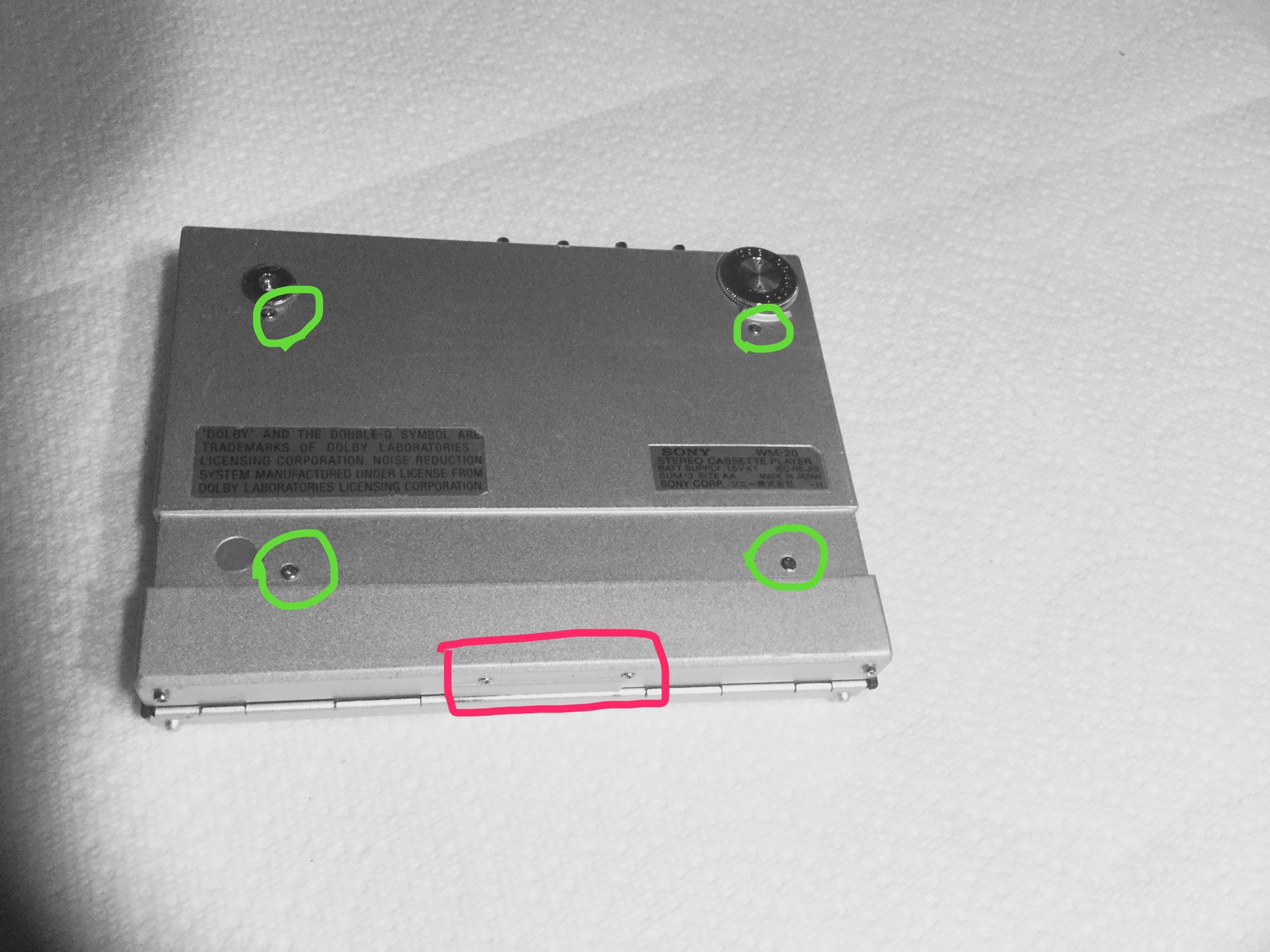

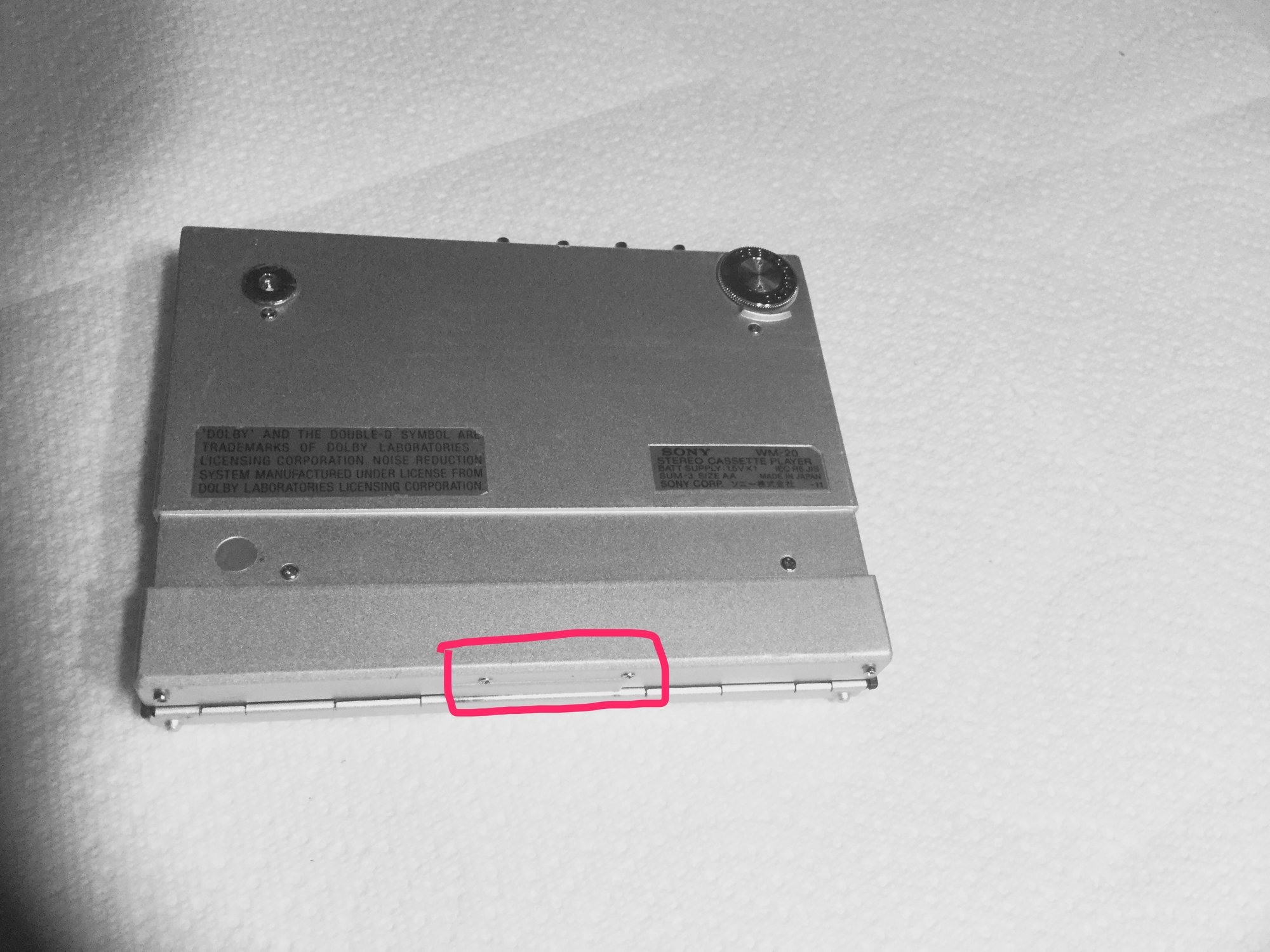

    First pull down the face plastered and open the two screw shown in the red box and gently remove the face plate

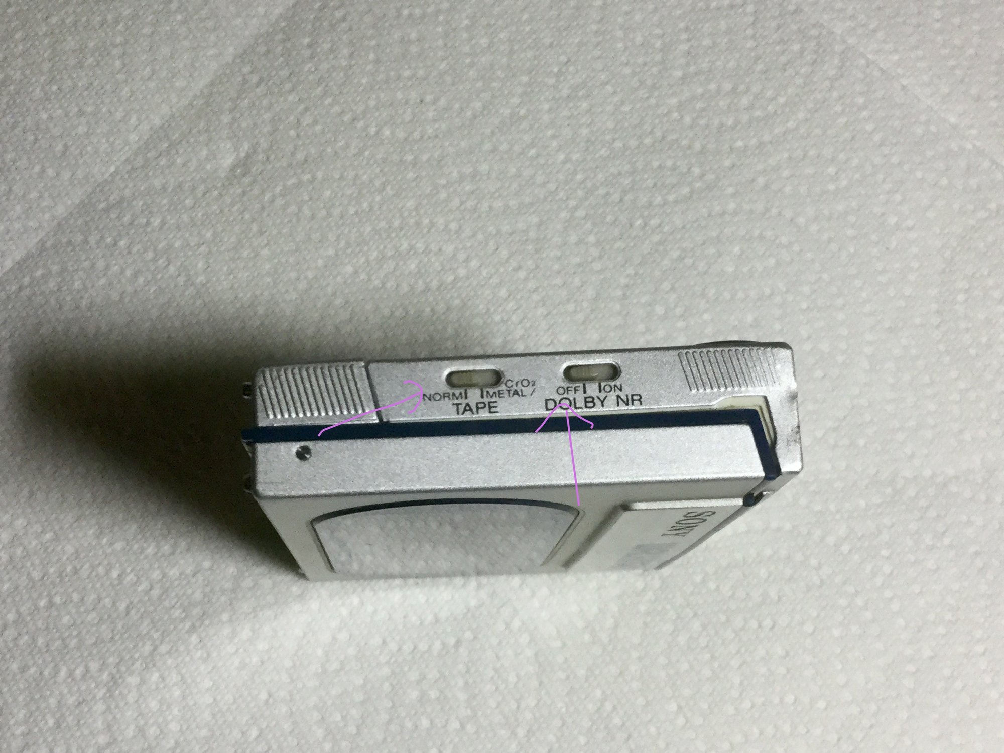

  15. Boodokhan
    2,461
    Make sure the tape button is switched to "Normal" and Dolby is switched to "off"
    ( this is important when you are placing the internal parts inside the back plate)

    Open the four screws that marked with green circle

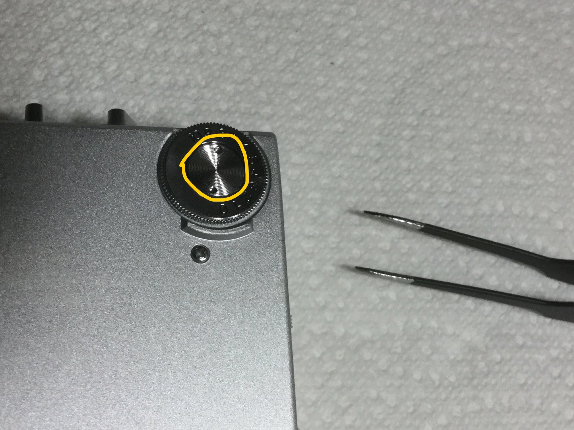

    By Using a pair of tweezers open the screw that hold the volume control.

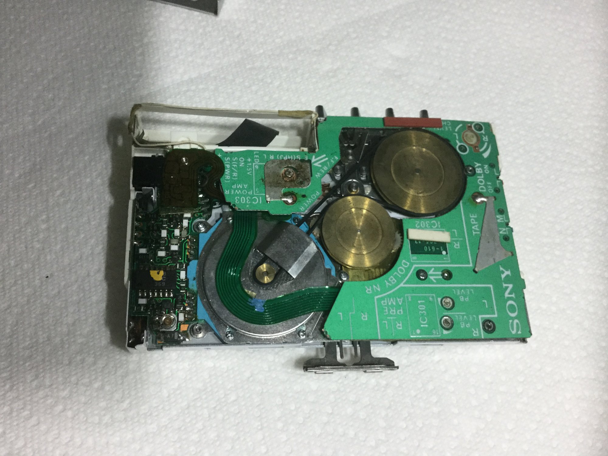

    Now you can remove the back plate. But remember yo be gentle when you are working with your Walkman.
    You can look at the belt that is already installed and follow the same way this one is installed
    Most probably you need to clean the melted belt. So make sure it is well cleaned before installing the belt

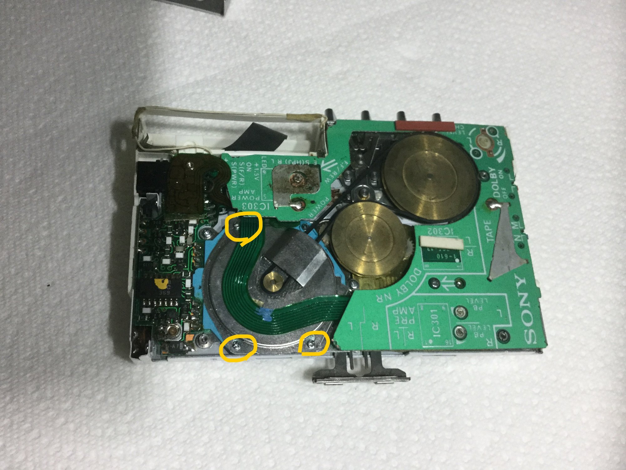

    Is you see a lot of goo around the motor you should remove the plate ( by opening these 3 screws) to have better access to clean
  20. Boodokhan
    2,461
    I will leave this Walkman open till tomorrow. Let me know if you need additional help.
