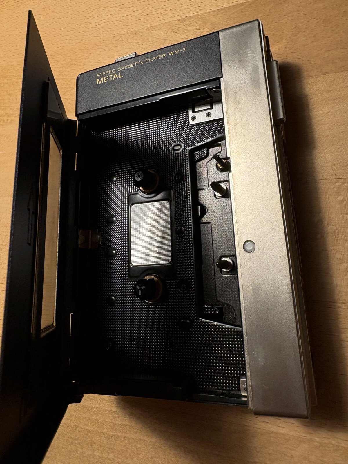

    So I bought this Sony WM 3 that was advertised as fully working. Turns out only one channel is.
    The right one is audible, but only with very low volume. Except for this problem, everything works well and the overall condition seems very good. I paid 200 Euro and a local repair shop (the only one we have in Hamburg) told me that it might be either:
    • Faulty or aged electronic components such as decoupling capacitors(Entkopplungskondensatoren) that may cause reduced volume in one channel.
    • Amplifier components responsible for audio amplification on the right channel.
    • Micro solder joints or cable connections that have intermittent contact or are broken, especially along the right audio path.
    • Dirty or oxidized tape heads or audio contacts, which can cause signal loss and volume imbalance.
    I was told that the repair might cost somewhere starting 100 Euro.
    What do you guys think? Is this a common and easy to fix problem so it is worth keeping this device or should I rather look for another unit?

    Can you do any work yourself? I'd start with a product like DeOxit (contact cleaner) and start with the volume knob. I'd look into the headphone socket and see if there's visual corrosion or rust (which needs to be removed). Headphone jacks get a lot of obuse and might need resolding.
    Most units need this basic maintanance, the volume knob, sitting in one place for years will get dirty and not make good contact when turned.
    https://audiokarma.org/forums/index.php?threads/the-idiots-guide-to-using-deoxit-revisited.207005/
    Your headphones might also have issues, check with a known working pair.

    Same here. The first thing I always suspect with these symptoms is the sliders. You can try cleaning them with contact cleaner. But it can also happen that the internal contacts come loose. To fix that, you'll need to desolder and open the slider. Or the carbon track will be broken. In that case, they also need to be removed. However, I've never experienced this with this model.
  5. Valentin
    1,956
    @Phil247 Likely it's a capacitor problem, it's a relatively common problem on this model.
    A volume slider problem should have crackling and you should be able to get full volume at some points while moving the slider up/down.
    Headphones can also be a problem, as @Mister X has pointed out, so do double check with other pair of headphones.
    The repair shop statement is a bit vague, as those potential issues hold true on any walkman having thesse symptoms.
    Defintely worth keeping the walkman in my opinion.
