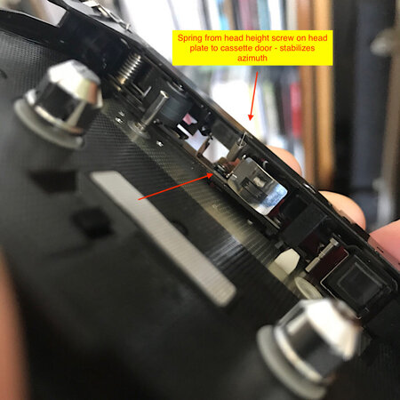

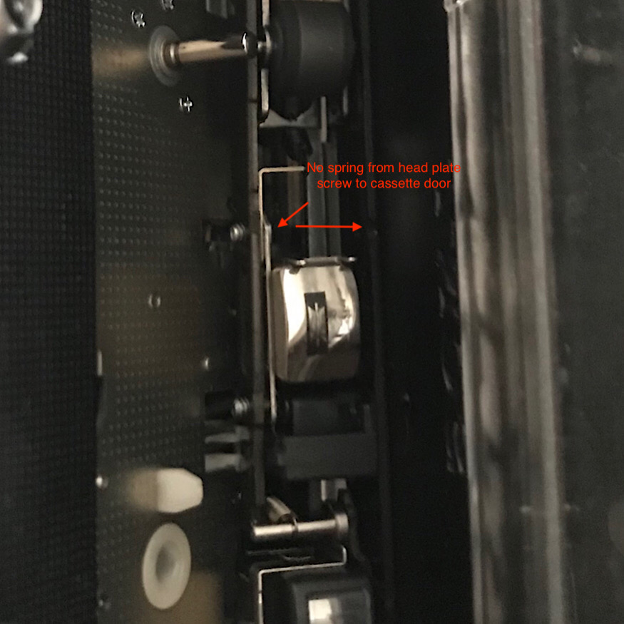

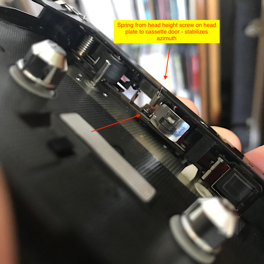

    Azimuth Stability
    While adjusting the azimuth I noticed that my readings were highly unstable - I'd remove the ceramic trimmer tool from the azimuth adjustment screw, stop the test tape, and after playing again to check my work the reading would shift back out of phase. It was also the case that, while making the adjustments, if I put pressure in the wrong spot the azimuth reading would jump significantly.
    After comparing with another D3 I have on hand, I saw that the one I'd been working on was missing a spring that connects the head plate to the cassette door. Perhaps there was a revision to this section, or maybe it'd been removed by someone over the years, but regardless I ended up swapping in the spring from my other unit, which fixed the issue. Azimuth now remains stable.

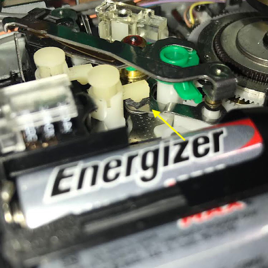

    Misaligned Center + FFW Gear
    Finally, despite attempts at adjusting the center gear arm, I kept running into an issue that caused the FFW gear to slip out of contact with the center gear, producing a screeching sound and stopping the take up reel from moving.
    Lots of time spent inspecting the area, the motor housing (which I ended up swapping entirely with one from another D3) and all sorts of other potential solutions that ultimately failed to correct the issue. In the end I could see that my new center gear was 'wobbling' - for lack of a better term - and that there was a point in its rotation where it wasn't making a sufficient connection with the FFW gear.
    In the end, I glued a tiny piece of rubber to one of the center gear arms sitting below the FFW button, which added just enough height to force the center gear lower when pressed down, since it now made contact sooner with the FFW button. This allowed the center gear to maintain contact with the FFW gear during FFW.
    I can't imagine that's a clear explanation for most - though I've added an image here showing the small black rubber piece glued to the arm.

    In respect with the low record level, the fact that you need to turn the trimpots all the way to get the level where it needs to be clearly indicates a problem. It should not be that way for sure. On all units I have repaired, I only rotated the trimpots a little.
    I would check the following:
    - Are you sure the playback levels are set correctly ? If they're too low, that could explain the situation. What test tape did you use to adjust those ?
    - Make sure 100% that the azimuth is correctly set. When using a 6.3Khz test tape, the L and R should be 90 degress out of phase and at roughly the same levels.
    - Are you 100% sure the bias is set correctly ? The bias level does influence the record level.
    What tape did you use to adjust the bias ? I recommend using a TYPE II (cobalt doped ferric) tape to adjust the bias, because it has a good enough treble response.
    On a TYPE I you will need to make the the treble response much higher to compensate for the response of the tape. And if the 10Khz response is too high, the 330Hz will be too low.
    Also keep in mind that TYPE Is are the most sensitive to bias levels, compared to TYPE II and TYPE IV.
    In reality you need to make a compromise when making these adjustments, as you won't get perfect response on all types of tapes. I personally consider that using a TYPE II is the best compromise.
    As a sidenote, I have seen some decks which have separate bias and rec level adjustments for each tape type. Only those will get perfect response on all tape types, but that is rare and certainly not to be found on a walkman.
    autoreverser, JoFugd and Boodokhan like this.

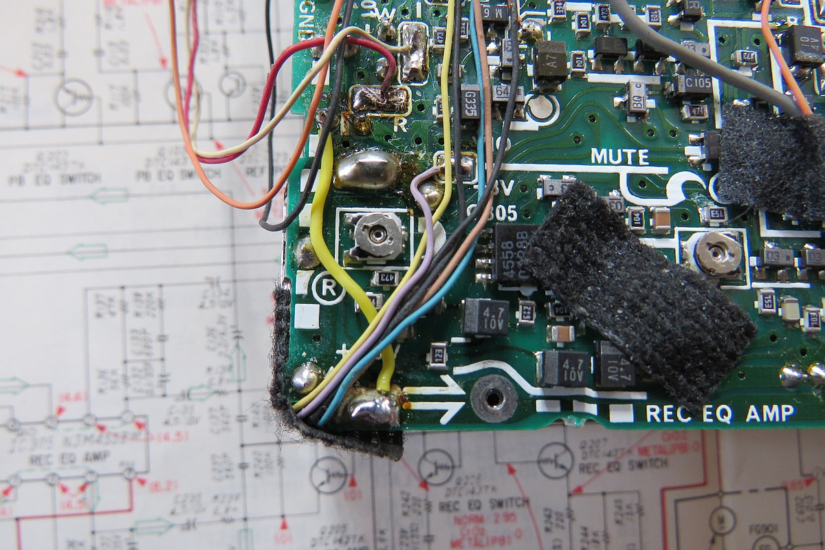

    RECORDING PROBLEM
    @JoFugd I suggest checking out this one, as it seems to be similar to what you have described
    When doing the adjustements (Dolby level, rec level and bias) I noticed the record level on left channel doesn't get nowehere near what it should be, even with the trimpot at the maximum setting. I immediately suspected the bias, so I checked the bias level immediately after the capacitive divider.
    After some measurement and soldering/desoldering pads I found out the bias level is much lower on the left channel and I could not get it anywhere near what was on the right channel, even with all the capacitors soldered. The values were 5.3Vrms on the right channel, 3.1Vrms on the right channel.
    At this point I suspected that something was loading the bias oscillator, so I decided to desolder the wire going to the REC/PB switch. After desoldering, the bias level immediately came back to 5.3Vrms, identical to the right channel. The problem was obviously after that wire.
    I started by measuring the resistance between the hot point of that wire and the ground point (postitive side of C306). The resistance measurement revealed nothing, as both L and R resistances were the same.
    Decided to start measuring the indutance with the LCR meter: the test revealed a significantly lower inductance on the left channel (28mH on the left compared to 109mH on the right - test done at 10Khz).
    At this point, I was starting to suspect the head itslef, so decided to measure it out of the circuit. After desoldering the wires going to the head, the head measured just fine, so it was clear that's not the problem.
    It was only now when I started to suspect a parasitic capacitance loading down the bias oscillator (that would also explain the lower inductance measured with the LCR meter).
    With the wires to the head disconnected, I measured the capacitance of the circuit: 6pF on the right channel and 70pF on the left. Now it was very clear this was the problem. But I still did not know where that parasitic capacitance was coming from.
    At first, I suspected some oxidation inside the REC/PB switch; I was ready to desolder, open and clean it, but decided to do a clean around it first. Some residue came out from the REC/PB switch area (that wasn't very visible at first glance). Now the parasistic capacitance was gone.

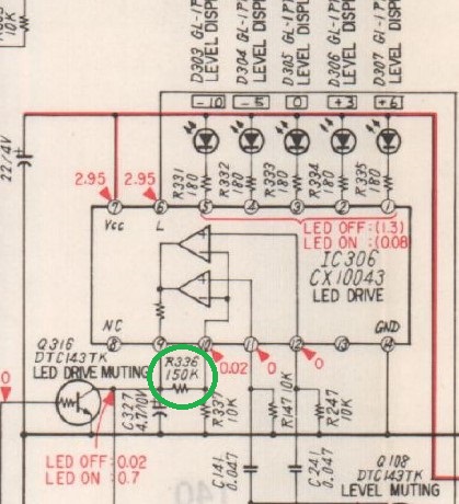

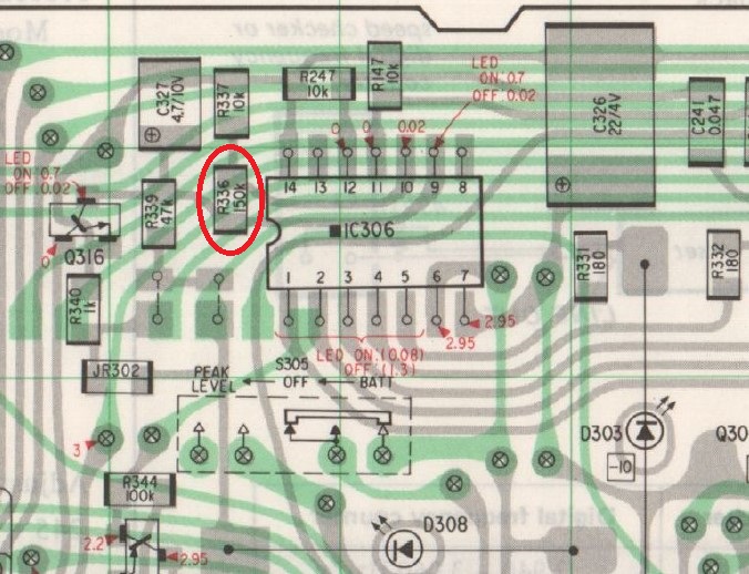

    VU-METER PROBLEM
    The VU-meter indicates lower peaks than the real signal peaks. I observed this by playing the same tape on a WM-D6C. The D6C was peaking at +3dB, as the WM-D3 was not going higher than -5dB, sometimes barely ligjhting up the 0dB led (Dolby levels set correctly).
    The funny part was it seemed more like a slew rate problem, as the VU-meter would correctly indicate levels of constant amplitude signals, but would not respond to transient peaks fast enough to display them.
    I could not find anything wrong: did clean and resolder some of the components around the CX10043 IC and the IC itself with no result. I was hoping there was a similar problem with a parasitic capacitance in the feedback of the amplifiers that would slow them down.
    In the end, I increased the feedback resistance R336. Initially tried 220k, which increased the gain too much; then I tried with 180k, which seems about right but it's still too high.
    EDIT: Correct value for R336 is 165K. Package is 0805. Note that 165K is not a standard E24 value (5% tolerance), but it is an E96 value (1% tolerance). So you will only find this value with tolerances of 1% or less.
