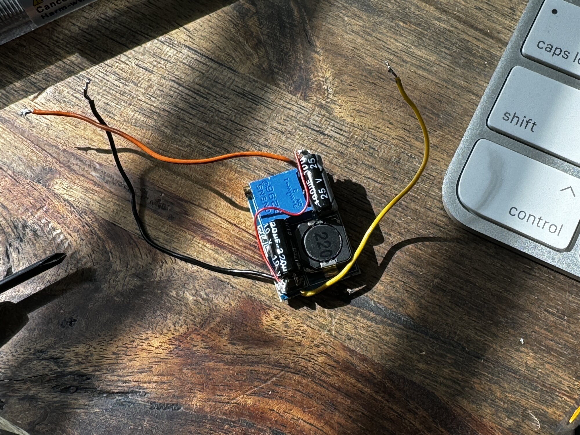

    MT-3068 dc-dc converters are easy to buy from Amazon or eBay - and they often sell in bulk. (I just searched on Amazon and it's being sold at $5 for 3 units)
    The specification:
    • Input voltage: 2-24V.
    • Output Voltage: 5-28V .(Continuously adjustable)
    • Output Current: 2A.
    • Efficiency: 93%

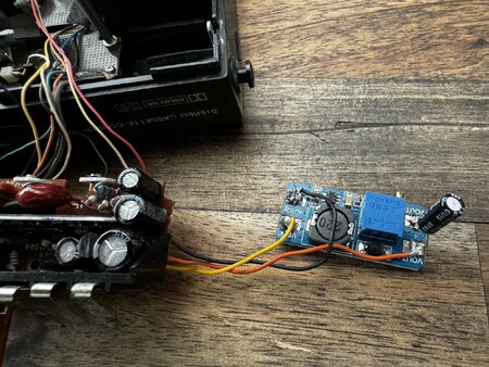

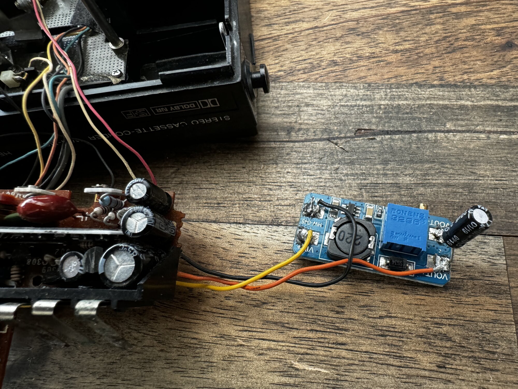

    From my test, once you set the output voltage using the on-the-circuit potentiometer, it holds that output voltage for wide range of input voltage. So when battery drains, or when adapter source is 5V portable backup battery, the high voltage rail can run on set voltage (in my case 11v)
    The test also proved original configuration of capacitors actually help reducing white noise.
    • 220 µF 10V for input rail
    • 100 µF 25V for output rail
    The circuit board is rather long to fit in the compartment within WM-D6 that was reserved for DC-DC converter. So I had to cut the input / output pods and use the component legs as post and it worked just fine.

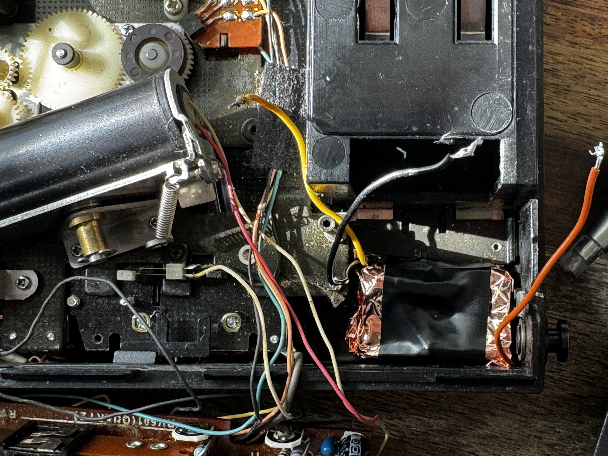

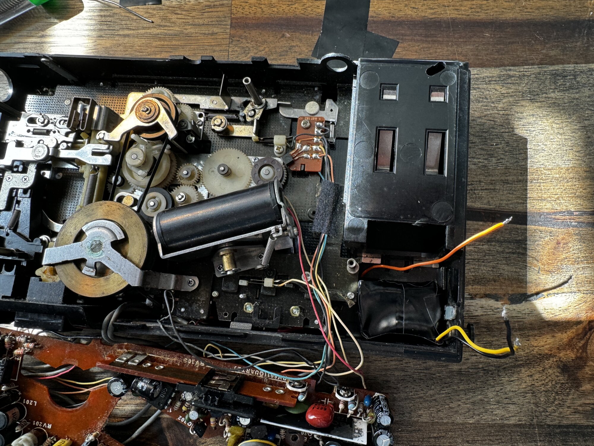

    After testing and compacting the unit with capacitors, I used electric tape to shield inside, then copper shield tape for EMF shielding, then again electric tape to prevent the copper surface won't short any other electric parts accidentally. With all that it was able to fit inside (with rooms to spare!)

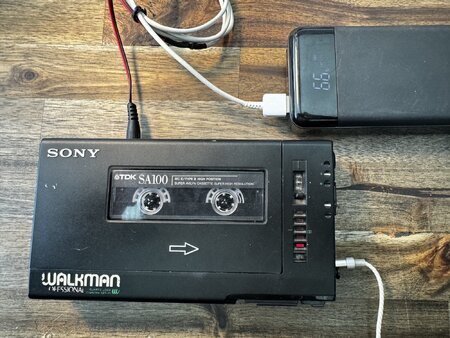

    Below are the pictures I took in the process of testing and building the package. And final application (5V high capacity lithium battery for phone charging used as a power source).
