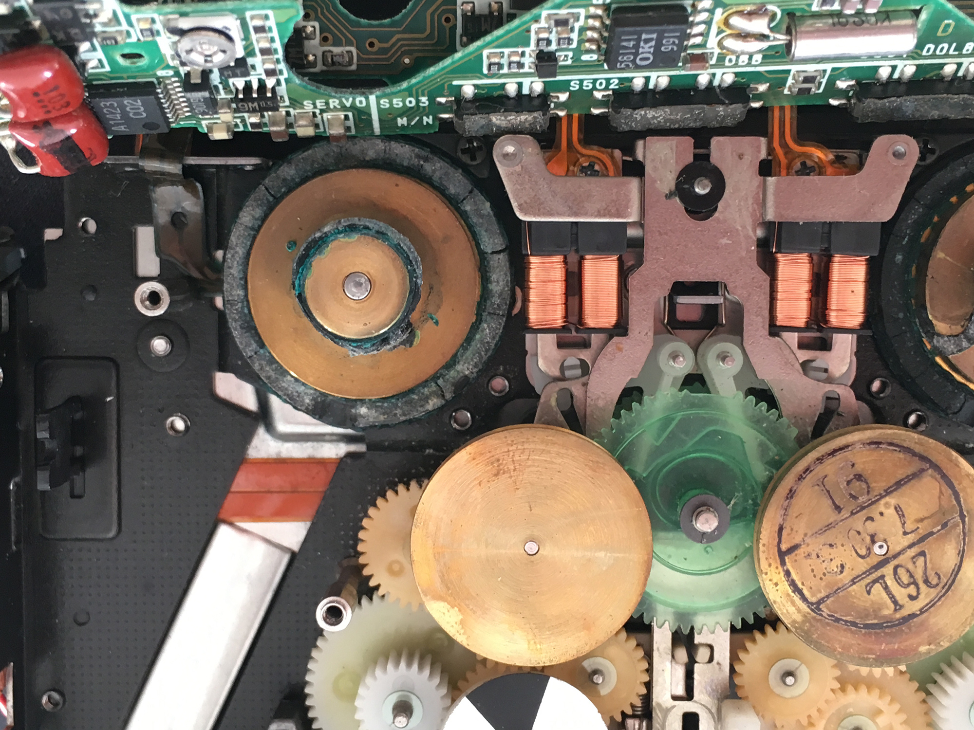

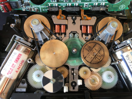

    Ohh men... not looking good. It seems like the belts are oxidized. How can that happen? So far, most old belts were like oil.

    Oh that looks pretty bad. Either it has been stored in damp and humid conditions for many years or its battery leakage. Its probably the latter. Sorry to be the bearer of bad news. I'd be trying to get my money refunded unless it was sold for parts.

    Oh goodness. Did you buy it like that? Looks like the inside of a rotten apple! No offence of course!
    If you bought it, certainly get a refund and put some aside to get a perfectly working model, that's my opinion. As Silverera showed, this model has some beautiful sound. I can't wait to own one, one day. Also as an Australian I can say there's not much else better than a good crack of Aussie guitar! @Silverera you should grab the album Frogstomp by Silverchair ;)

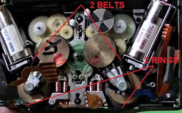

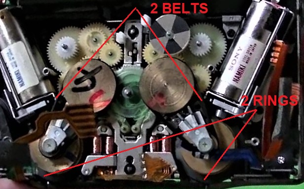

    What you see in your picture , is the rubber part of the Disc (Drive) , this is where the end of the motor shaft is in contact with the Disc(s) . The two belts , not shown in the picture, are above the two Discs (see attached picture) , most certainly they are far gone too .
    After cleaning the parts from the remains of the disc rubber rings and the old belts you'll need , obviously , two new belts and two new rubber rings , I believe they are available online.
    Oxidization most likely is looking worse than actually is and you'll be able to reuse the discs after thorough cleaning.
    The most dangerous part is to brake accidentally the ribbon cables while cleaning as they are very fragile and probably hardened after over 30 years of existence.

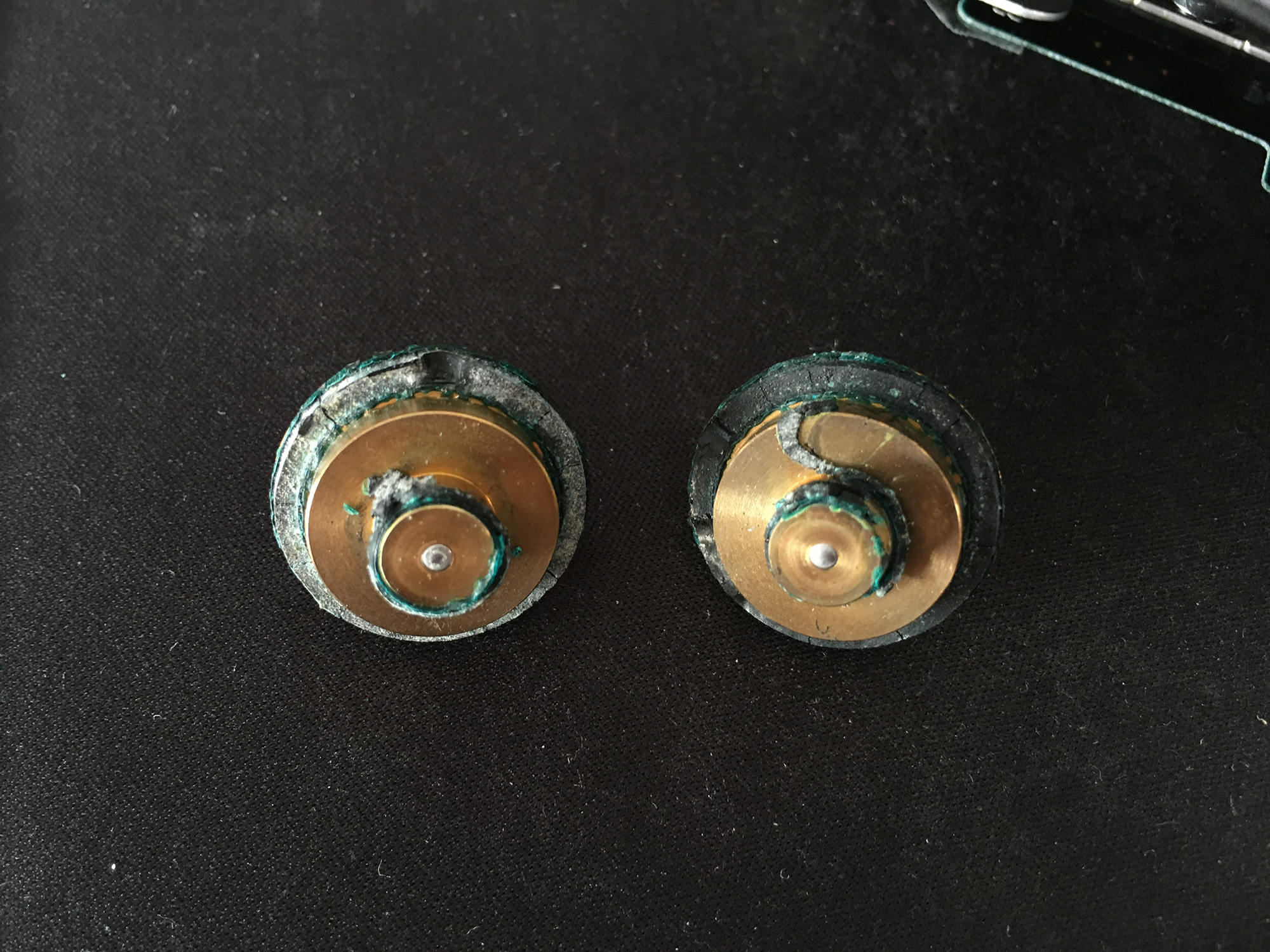

    I bought my DD9 in that condition as well. clean off the old rubber properly and you'll be fine. You may need to sand the surface of the new flywheel tires down a little to get W/F in spec. Add a drop of synthetic 5W-30 oil to the capstan bearings and clean off the excess while you are doing so.

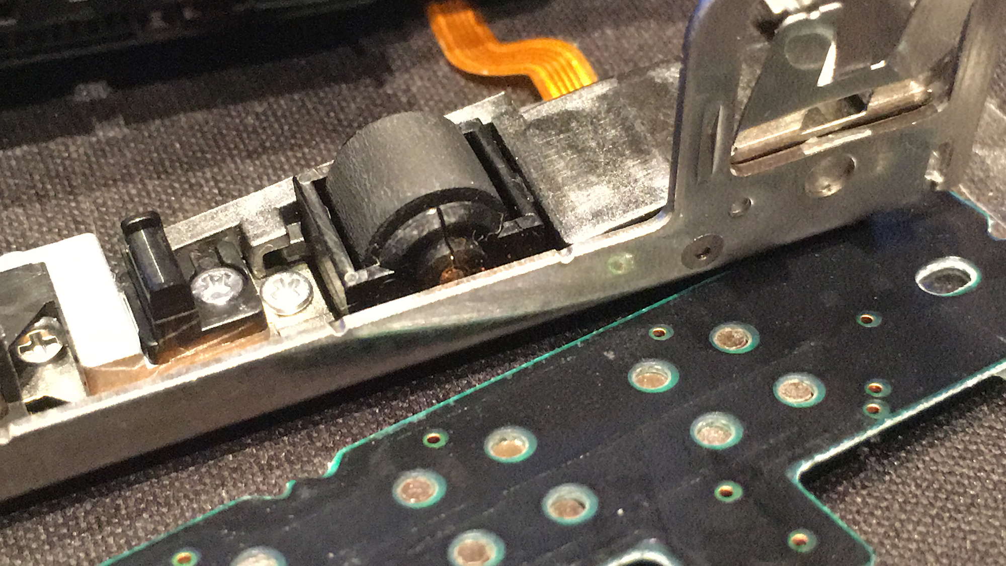

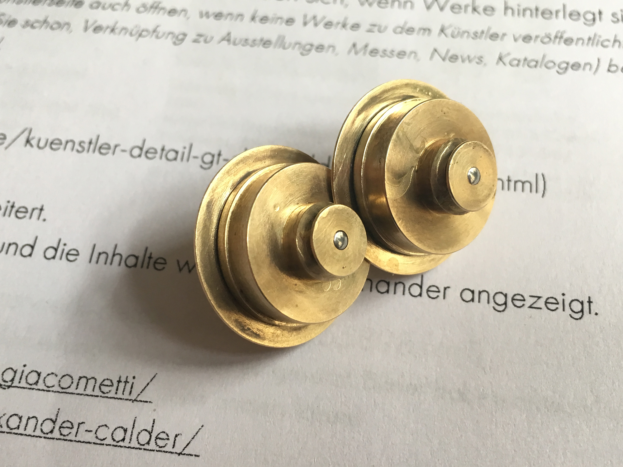

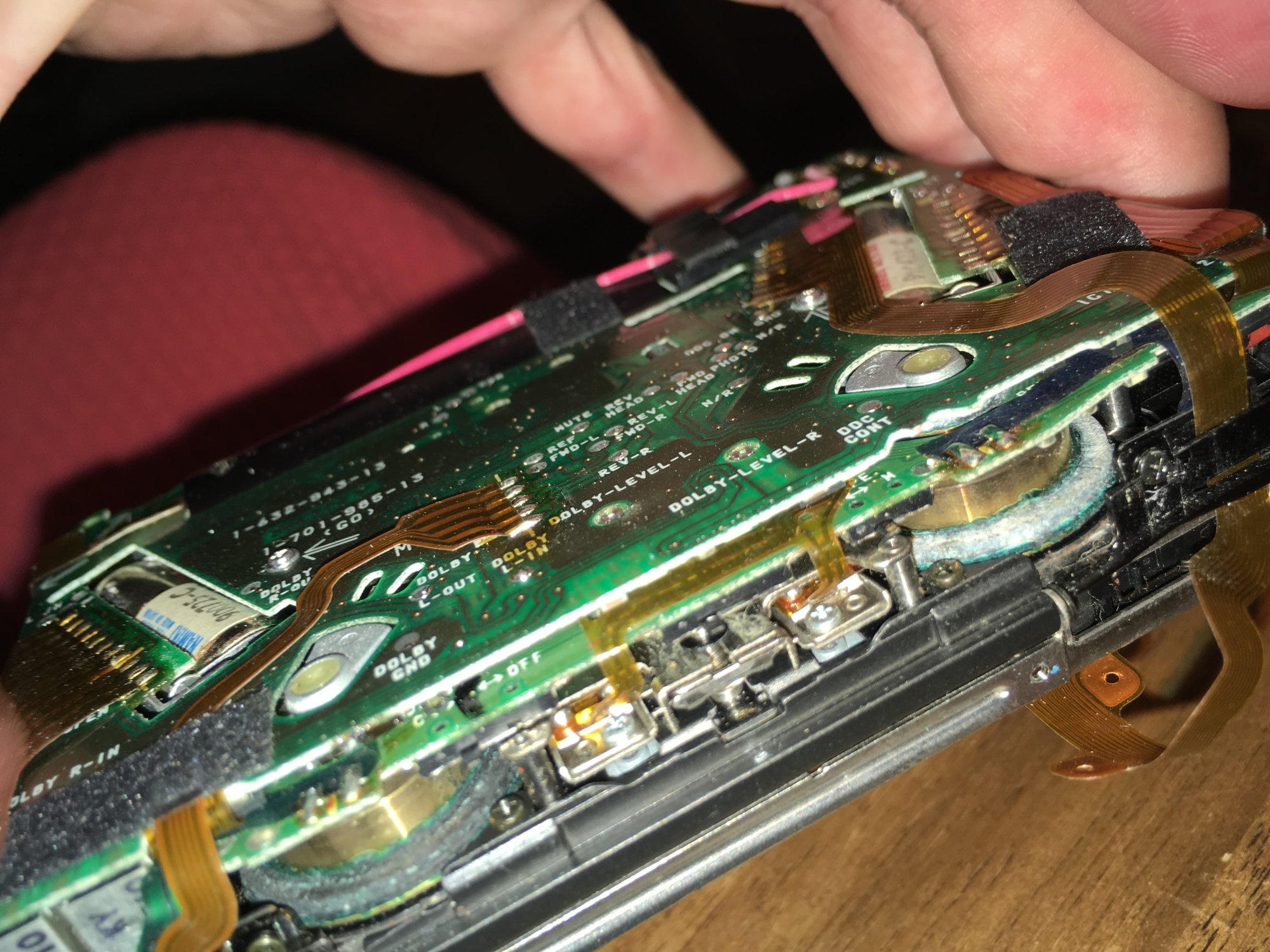

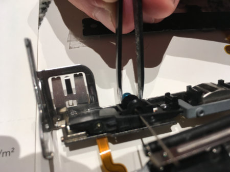

    After a long time I had the pleasure to devote myself a little more to the Sony. I had to completely remove the capstan wheels and clean them with various cleaning agents and ultimately an ultrasonic bath because the rubber was locked with the brass wheels. I assume a chemical reaction. After that I was able to install the new belts and rubbers. When changing the pinch roller, I found that there was a small hairline crack in the plastic guide of the shaft of a pinch roller. I had to glue this. After I put everything back together, the DD9 ran again and everything worked as it should, except for one small thing. Unfortunately, he has some problems playing in one direction. There is also a slight click. When I play in the other direction everything is great. I will look at it again sometime.

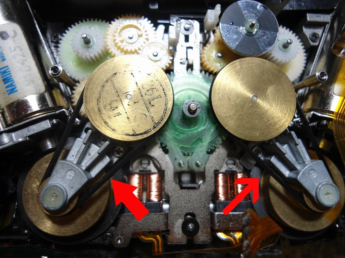

    Hi Davide, I hope I can help you. You have to change 4 rubbers. 2 rubbers on the capstan wheels and then two more (thinner). I'll send you two links for the rubbers and I'll upload the service manual for you. This gives you step-by-step instructions for disassembling. I made a note on a piece of paper at every step and stuck the components to the note with adhesive tape. I'll send you the things tonight. Greetings from Berlin. Gábor

    I think my situation is different. the rubbers seems to be fine. Everyting is clean inside. I think I have a problem with some electronic part.....
