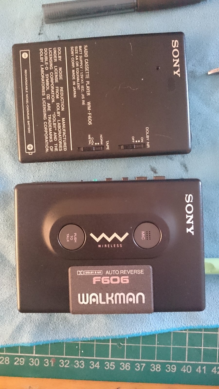

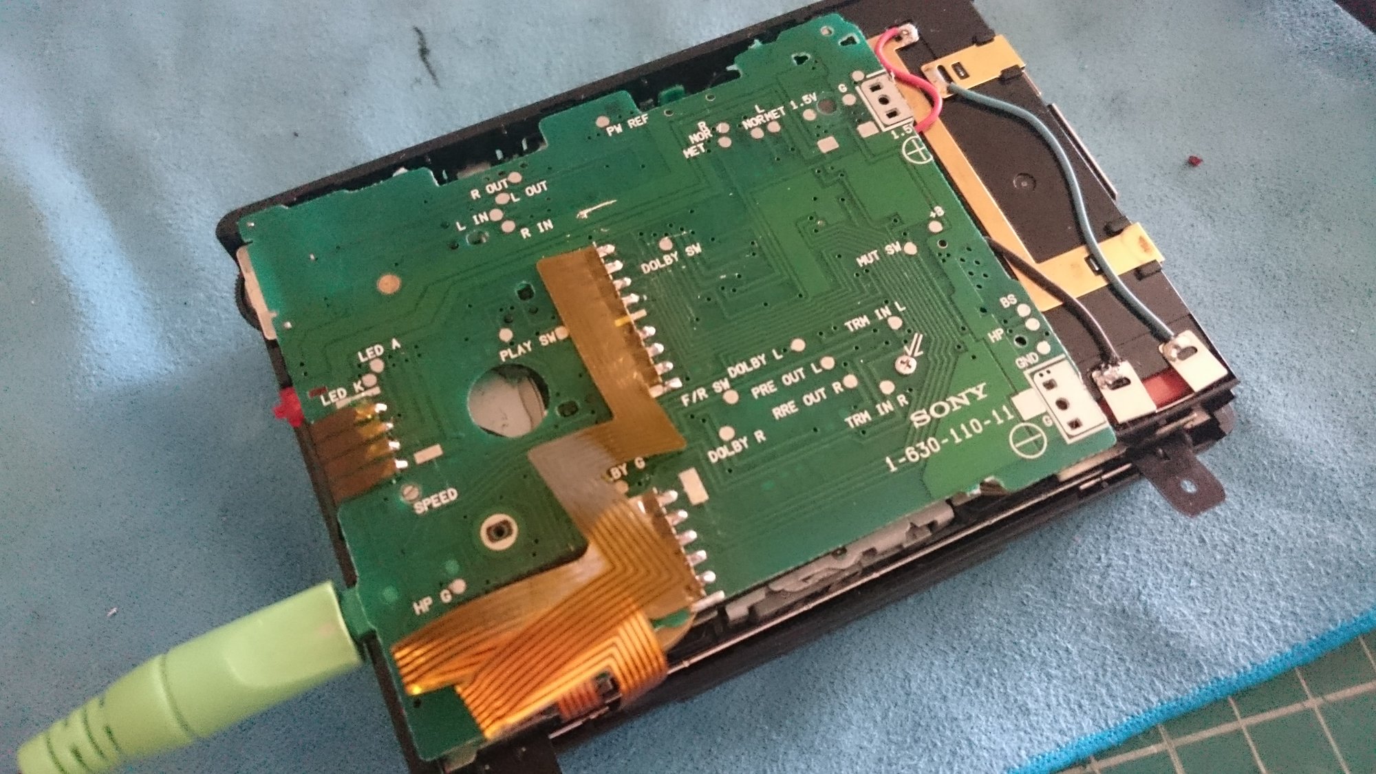

    Hi there - I'm working on a Sony WM-F606 and have reached the limit of my expertise
    I've done the mechanical work and all functions seem to operate
    But I struggle with the electrical stuff > Can the experts spare me a minute to listen to the attached audio (with a tape in) and advise. The audio is one channel just because of the way I recorded it. You can hear the effect of switching the Dolby and the tape select during the clip..
    Recap?
    thanks for your time

    1. Check grounding to the main PCB. Clean FWD/REV switch.
    2. This model (170 derivative) is known to have capacitor problems. Try recapping.
    Good luck!
