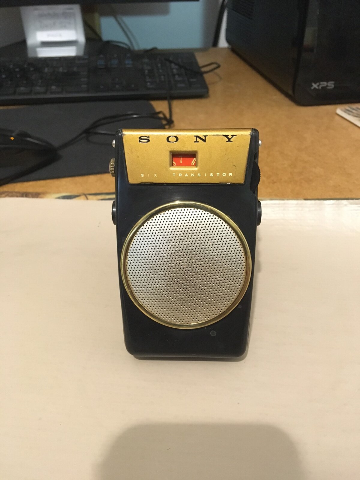

    Sony tr610.jpg Hello EuroFlash,
    Nice that Sounds good this last weekened I restored My Sony model TR-610 Am transistor radio it really works well after replacing the smalled Can electrolytic which had 3 electrolytics in on can .
