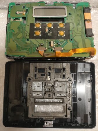

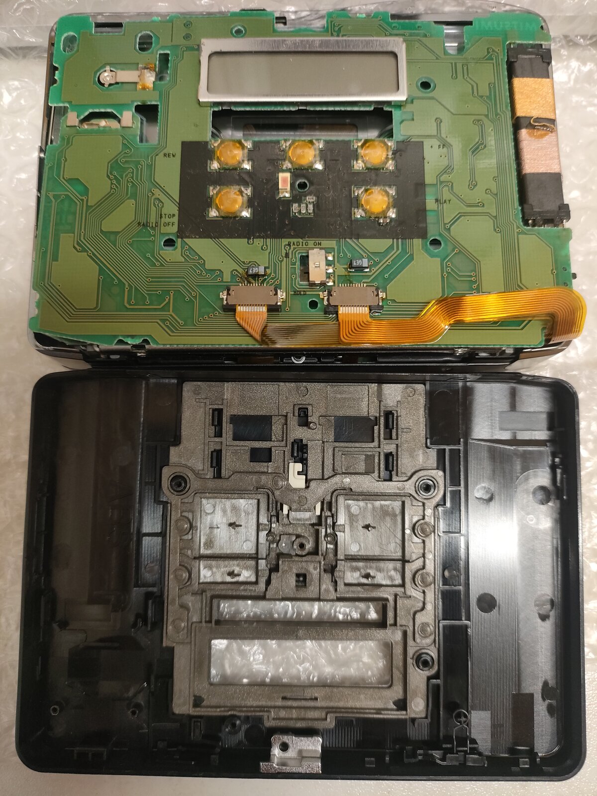

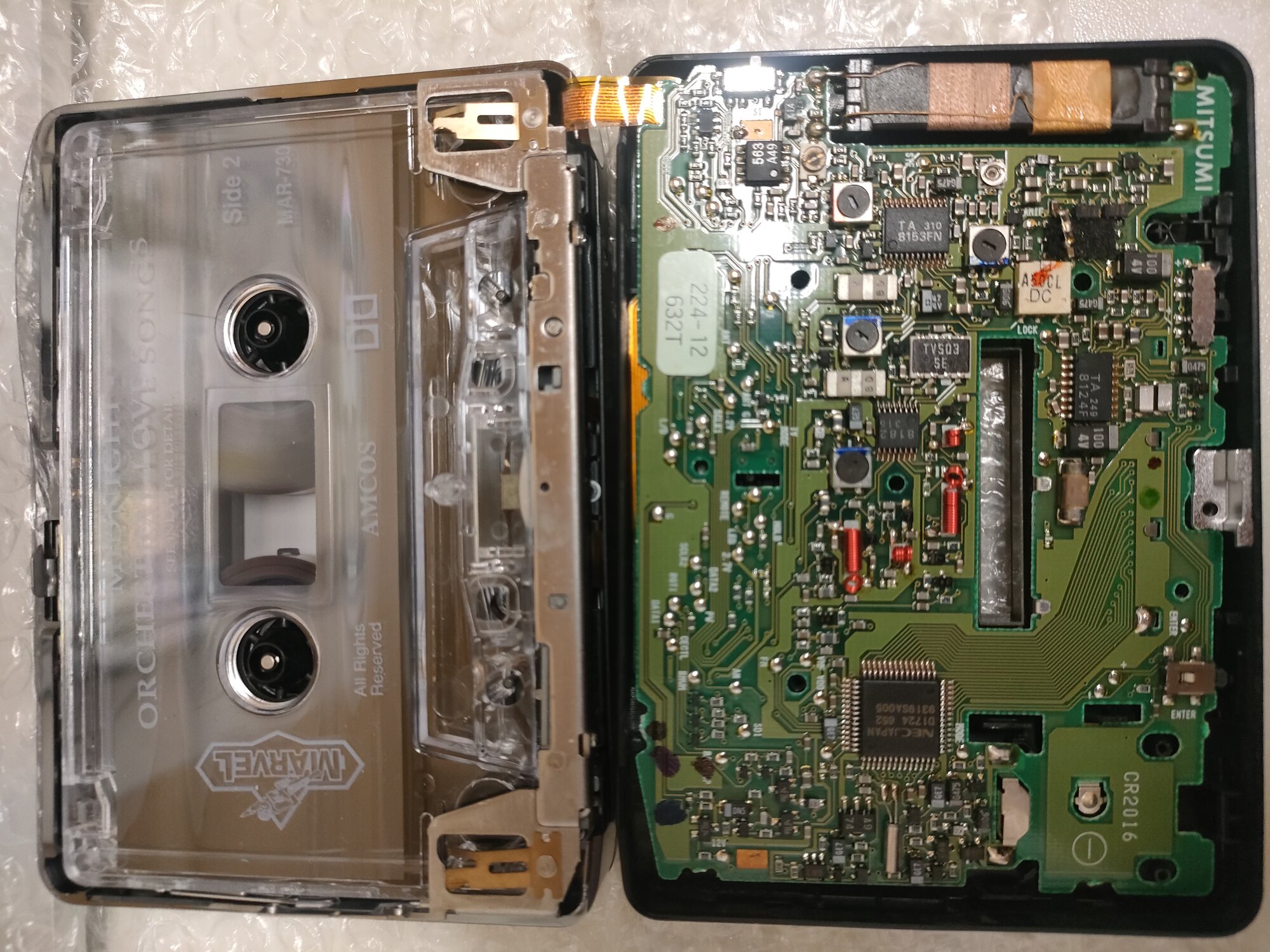

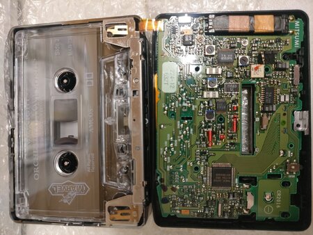

Hi guys. I've spent a lot of time servicing this unit and have replaced the belt and adjusted speed so its at least somewhat ok. There is one glitch however, when I press the stop button sometimes it actually mimics the behavor of the play button. And when I press play button sometimes it does a FF. It is very irritating. I have tried cleaning ribbon pins and ic pins with IPA. I couldnt see any damage under the hood. I have some pictures of the board which the buttons are registered on. Does anyone have any advice for me to try figure out this glitch?
Given the buttons use a resistor ladder, any increased resistance on the buttons will render this behavior. Solution is to clean the buttons themselves with contact cleaner (Kontakt 60, Deoxit, etc.)
Hi Valentin. Long time no see. I understand your logic that the increased resistance per button pad could cause this behaviour. I am not sure how I can clean actually clean these buttons though as they are completely sealed that that orange polymide (or similar) film. How do you get contact cleaner in there? Also would WD 40 specialist cleaner also work? It's what I usually use for pots
There are 2 options: disassemble the button and clean manually or simply spray some contact cleaner over and pressing the button many times. The latter usually works just fine. And no would recommend against WD-40 or any similar generic cleaners, even the ones marketed as good for electronics. The generic ones are no good for this application. There is a story here on the forum with someone cleaning a DD10 PCB with that and it left a lot of residue which was very hard to clean.

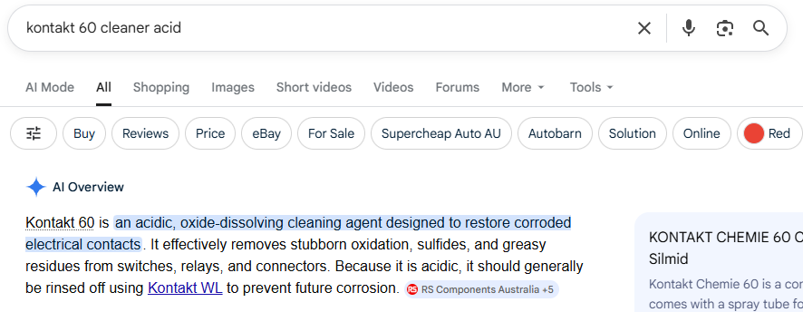

My appologizes if Im wrong I only did very light research on this on google and read the google overview. See below. From your and Black Fingers experience it sounds like it evaporates fairly quickly so it shouldnt be a problem. Sorry to Kontakt company for incorrect information above. I did also read somewhere that the acid sits on the bear metal forever - it must be wrong info Ok okay. Thats good to know. I read online that using a cleaner without the lubricant will actually break down any of the factory instealled lubricant on the potentiometer and now the metal on metal contact will increase the magnitude of wear each time its used. But to open a potentiometer is usually a time consuming job and can only be done so many times before breaking the folded metal that hold them in place. It does make me want to go the most basic spray of deoxidising cleaner route as its also a less risky procedure
