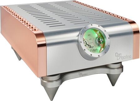

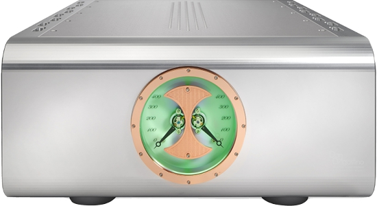

  7. Jorge
    1,723
    these look nice, a bit cheesy compared to his Krell days but still nice:
    Valentin likes this.

  9. TooCooL4
    2,969
    @Jorge Dan D’Agostino’s new designs these days has people in one of two camps, the people who love them and people who hate them.
