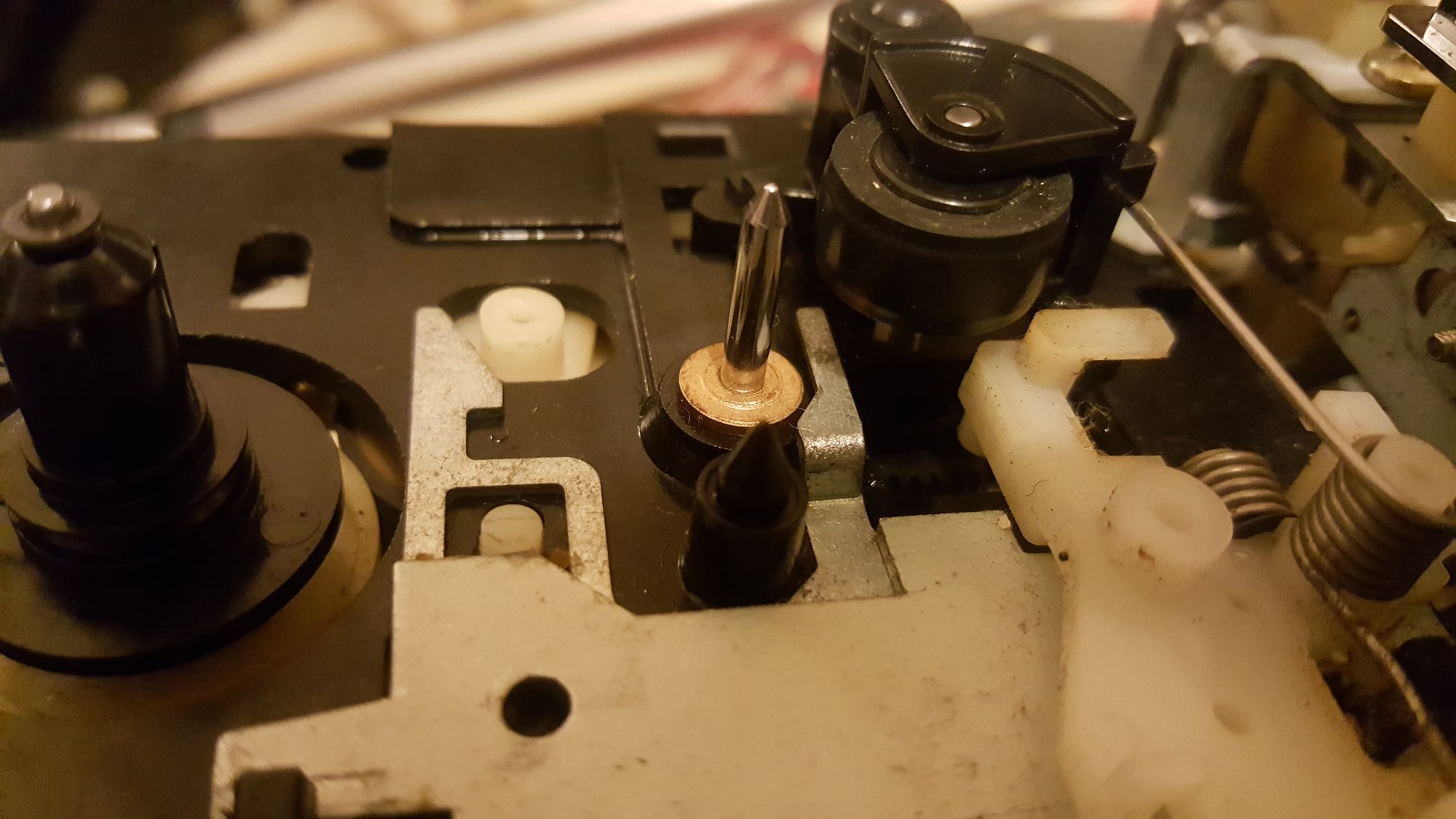

    Here's a picture of where the part goes, but don't think this has anything do do with pinch roller?
    The pinch roller is pushed up by the head block, is the block moving fully upwards? Mine had this problem it was stopping about 5 mm short, this was sorted once I had cleaned and re-greased
  2. T-ster
    1,455
    thanks Dave, thats great. The heads all move up just fine, the pinch roller just doesnt move up with it and i just need to find out what moves it, can i have a front pinch roller shot too please?

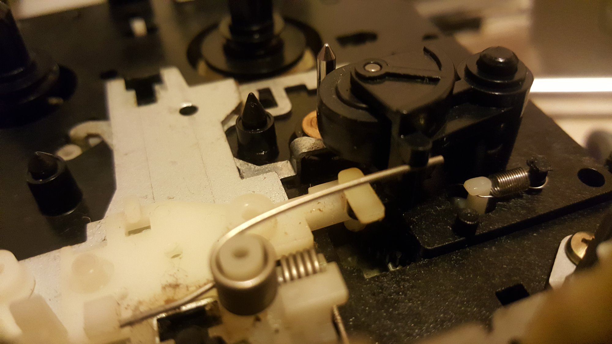

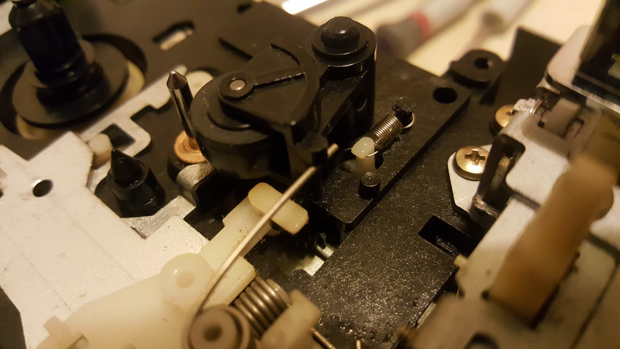

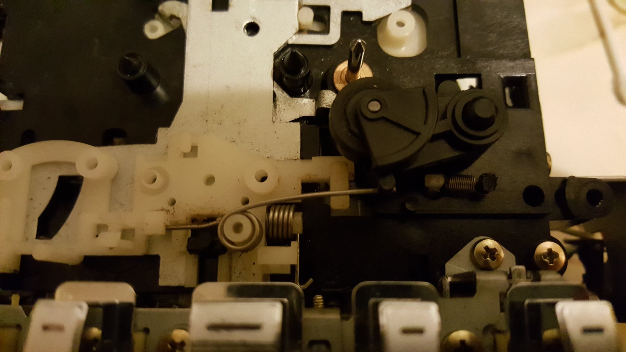

    Here's some close up shots of the pinch roller, it's actually the spring underneath that pushes it up as the heads rise, I've left these images full quality so you can zoom right in.
  4. T-ster
    1,455
    Your a legend Dave much appreciated. Looks like i have a missing spring. I thought i must of.
    So thankful for the pics as im bound to have a spring in my spares box :thumbsup:
  5. T-ster
    1,455
    Thanks to Dave mine is now all fixed up, tapes play real well and im super happy. I owe you one Dave thanks :bigthumbsup:
