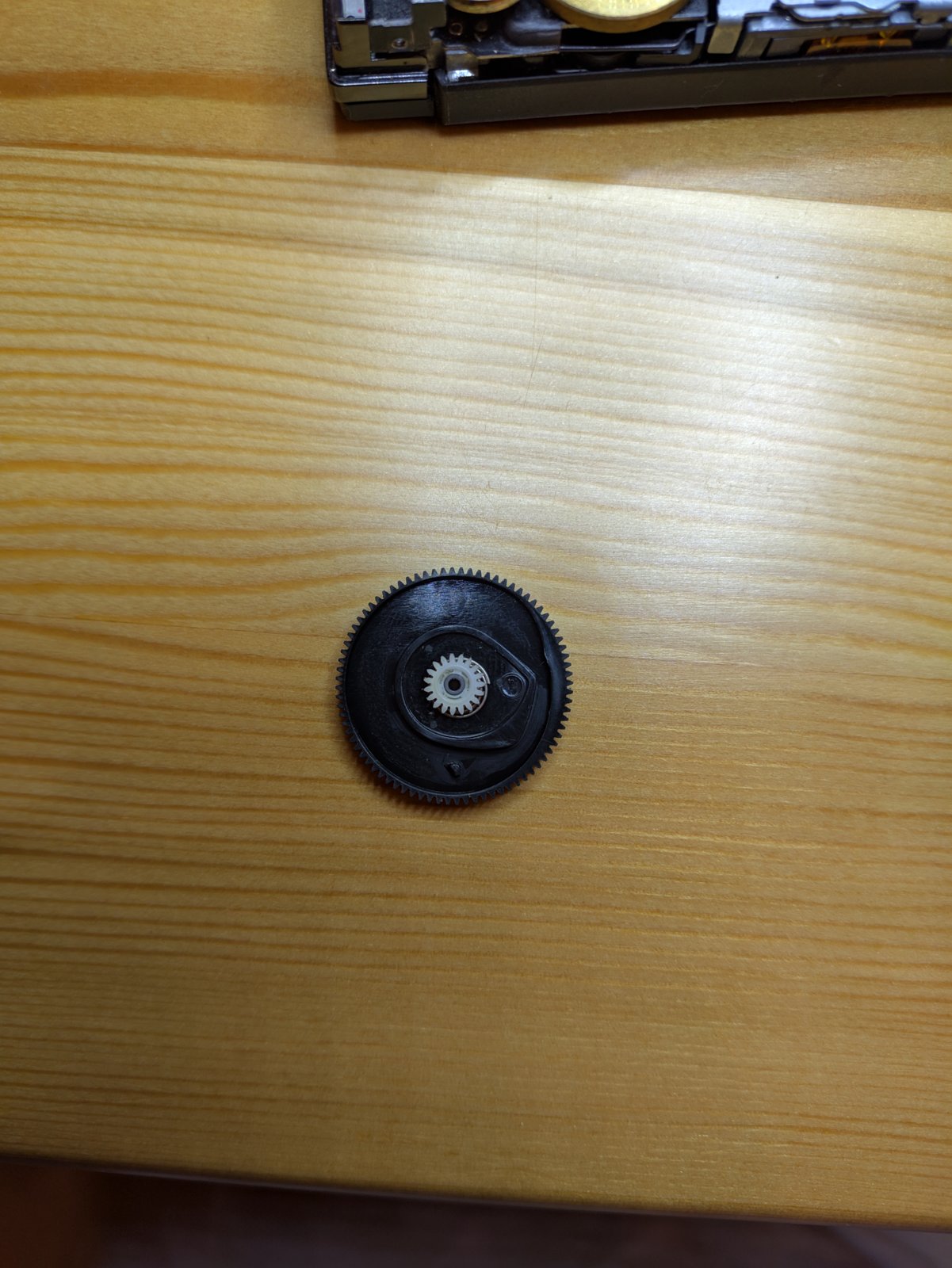

    I tried to do clutch repair and opened up my walkman, but I didn't expect to see this IMG_20190810_224518.jpg
    IMG_20190810_224938.jpg As I understood it, last owner just changed the cracked gear with not exactly same one, so only play works fine, but "green button", FF, REW aren't. I really don't know is he bad one, or my saver))
    Maybe someone possibly find, where to find the new gear instead of cracked one, or I have only way to buy broken walkman and take gear from it ?

    That gear is probably too tall and preventing the other gears from meshing with the top of the clutch drive gear. If this is the case, it might be worth a try sanding it down.
    You should be able to find another walkman with this mechanism as they were very popular. Look for the same buttons or an "EX Head" script on the reel table.

    You are genius !)) Could you measure the height of the gear for me, please, or it will be difficult ? Maybe I could fix it.

    I don't have a gear with me at the moment to measure, but check if the clutch drive gear is touching the surrounding gears in FF/REW mode.
    There is no glue that can hold to nylon/delrin permanently, it's only there temporarily to give time to "weld" the gear in by melting it.
    There are people doing 3D printing for some cassette deck gears that are quite high in quality, but I suspect there's not many that want to fix a WM-150 mech.
    (There are more desirable models from a collectibility POV, less 550C)
