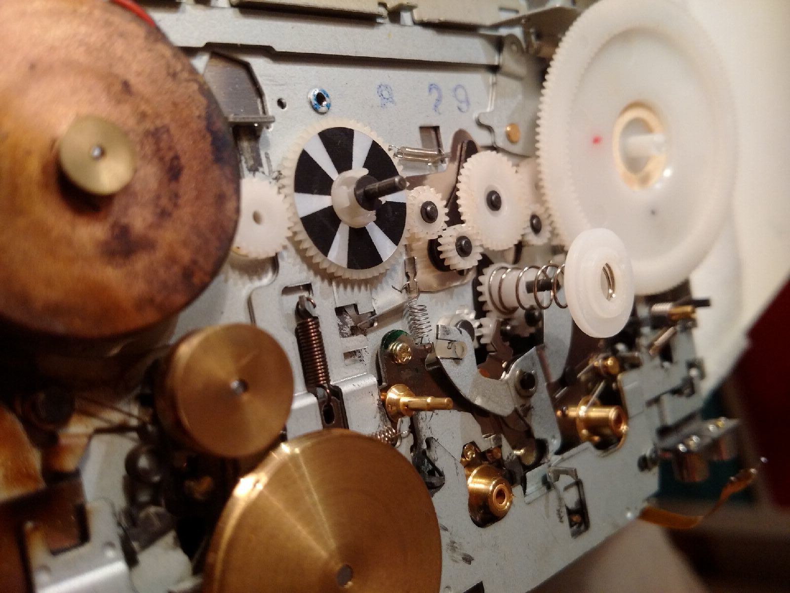

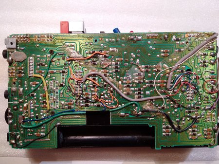

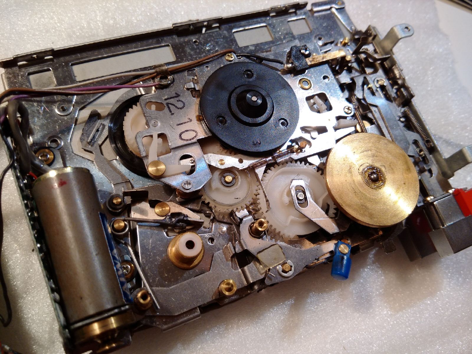

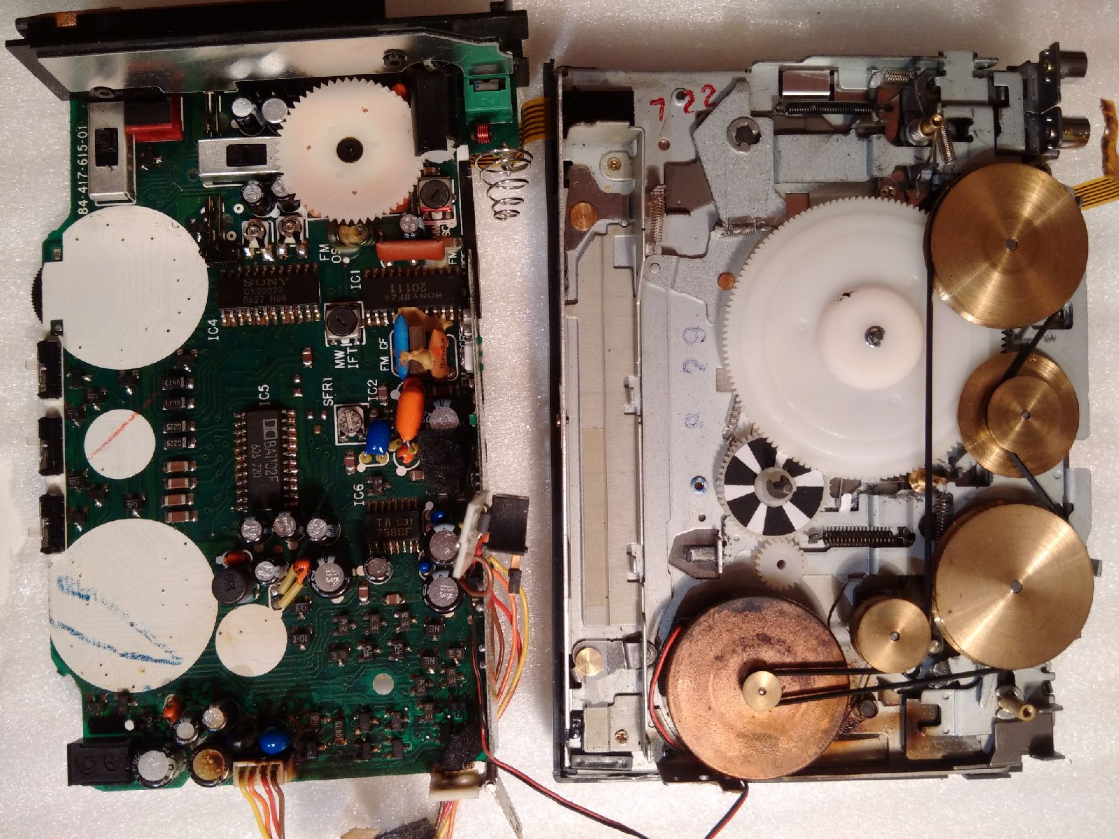

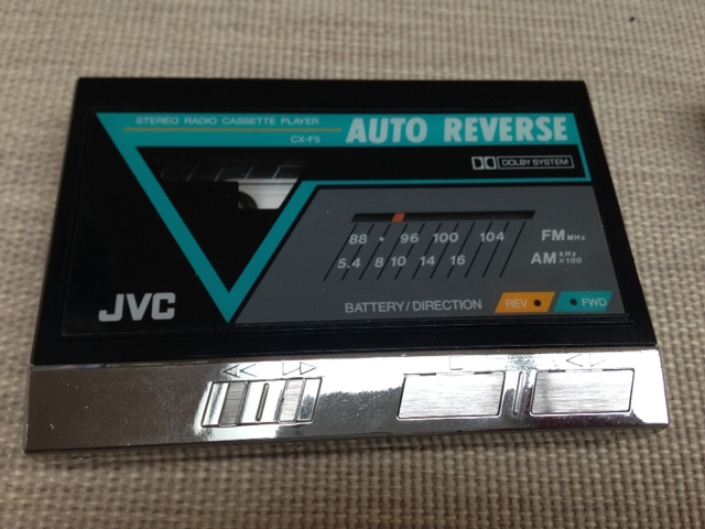

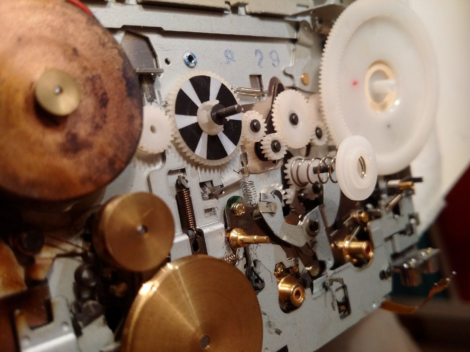

    15. JVC CX-F5
    miniature machine with radio and motorized head engagement
    IMG_0529.JPG IMG_0536.JPG IMG_0571.JPG IMG_0570.JPG .
    belt size: 8/13 or 9/13
    center gear seems to have problems: machine creates traffic jam even after new belt is installed.
    Valentin and Brutus442 like this.

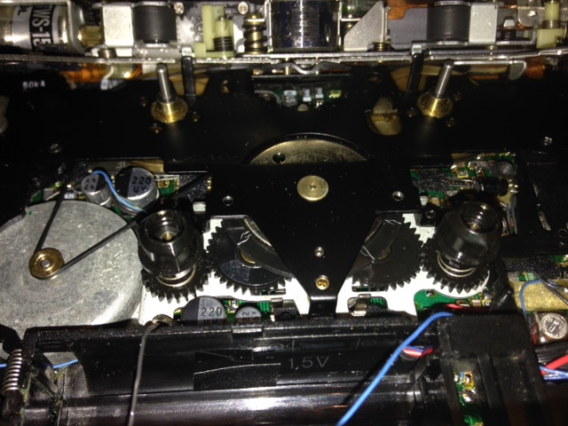

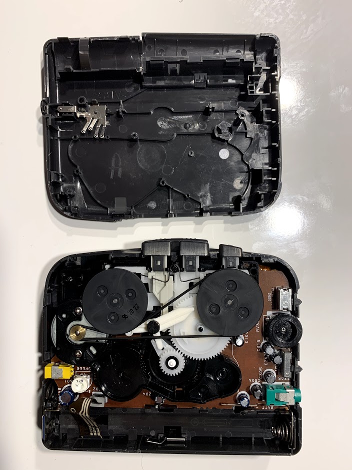

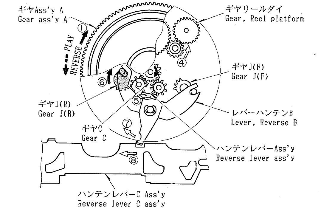

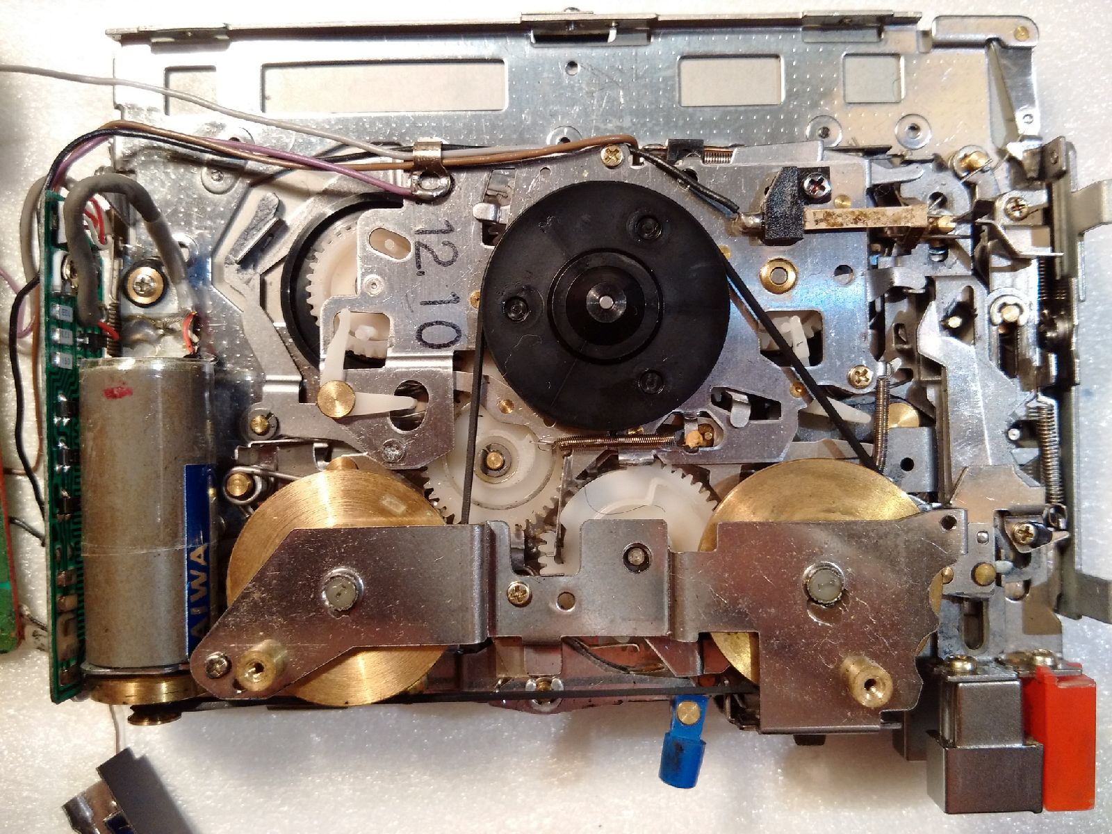

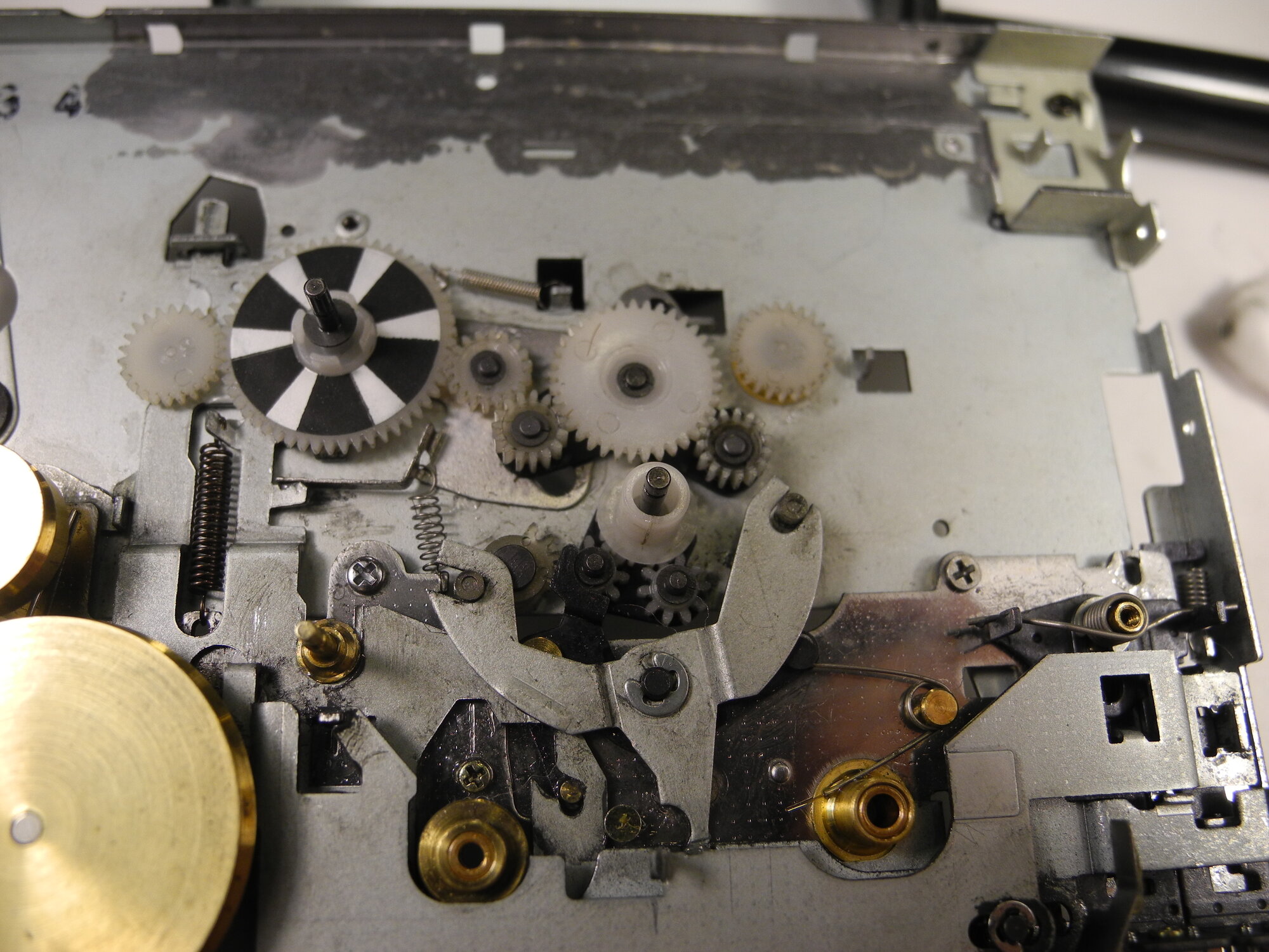

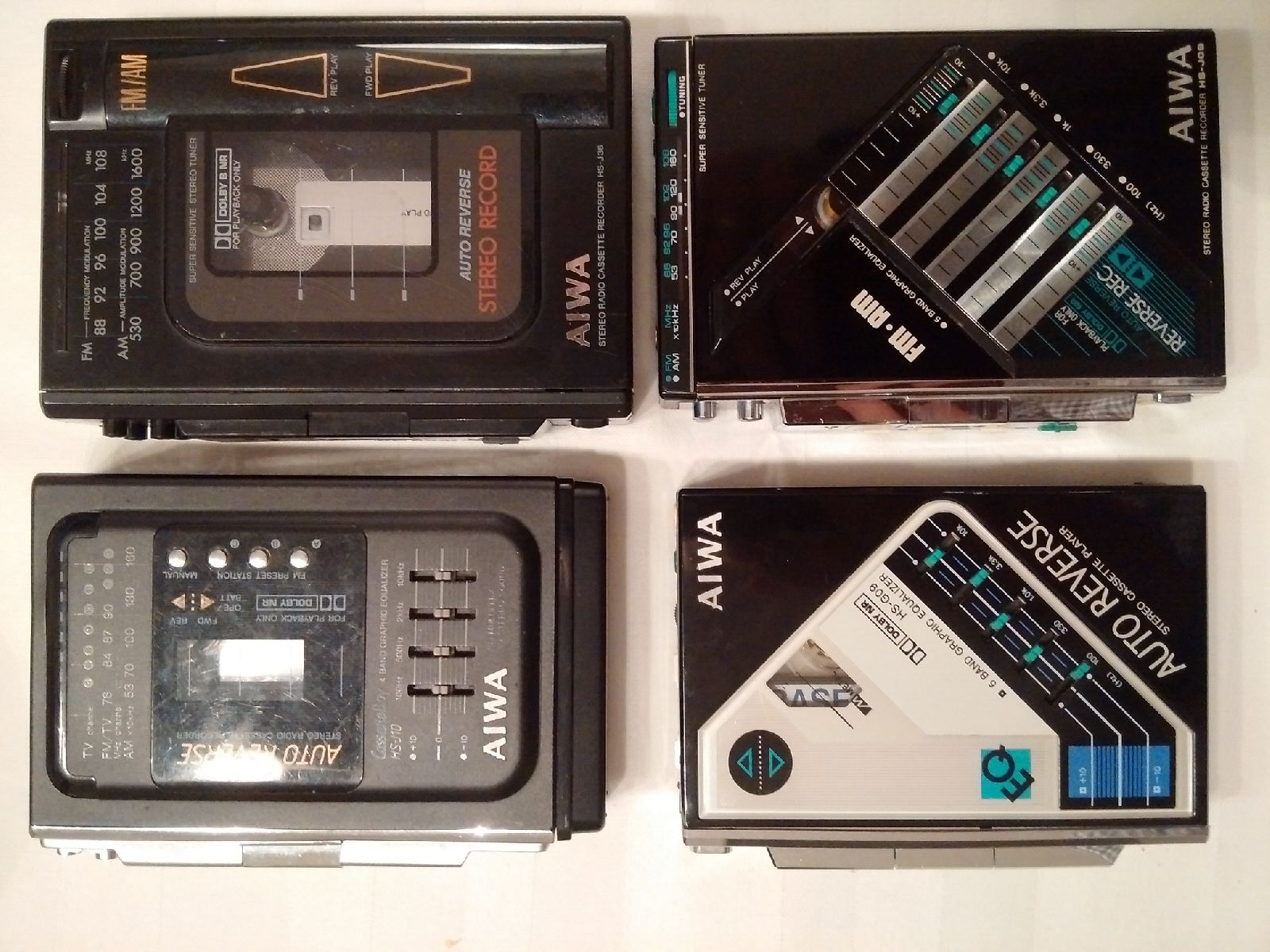

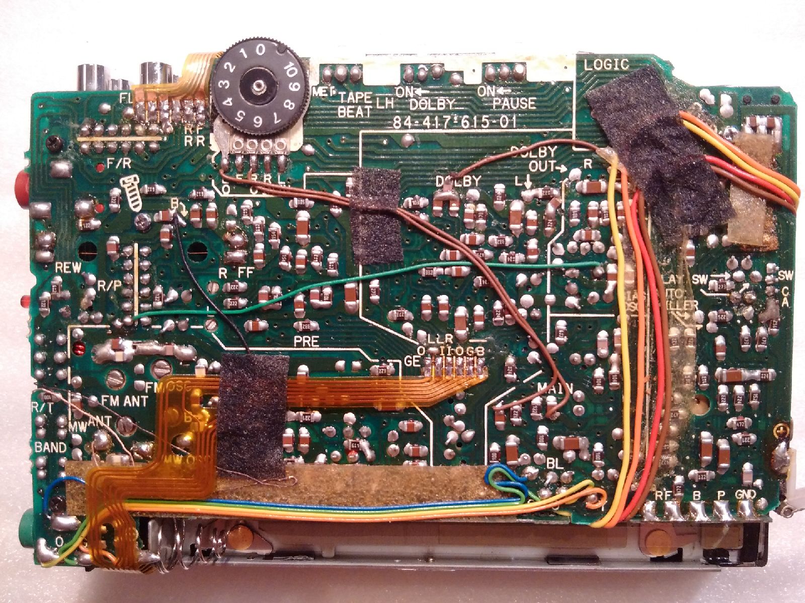

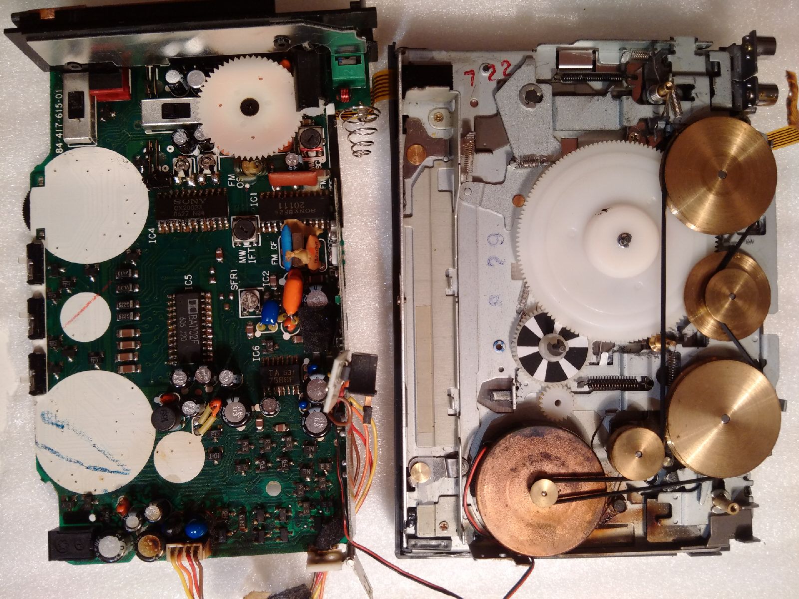

    16. Aiwa HS-J09
    common problem: broken center gear.
    the 4 machines below share the same mechanism.
    center gear is under huge load when switching the playback direction (fwd, rwd).
    if the machine jams the tape, the problem is most probably the broken gear (the spring creates tension when removing the gear and jumps off, too).
    IMG_20170305_225743.jpg IMG_20170305_234013.jpg IMG_20170305_234551.jpg IMG_20170305_235815.jpg
    Kabuff and Valentin like this.

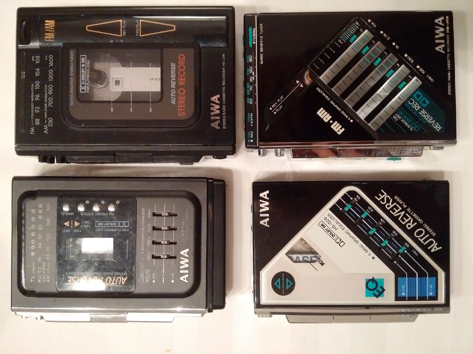

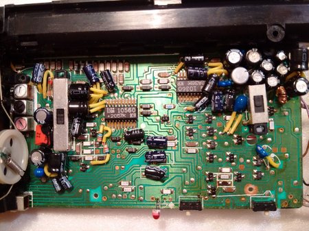

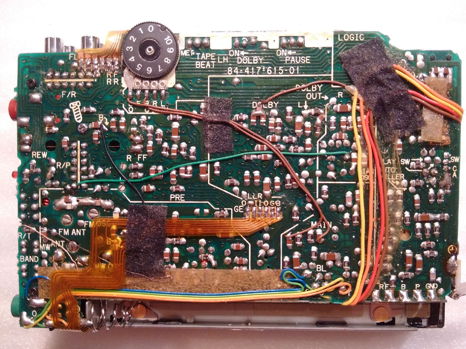

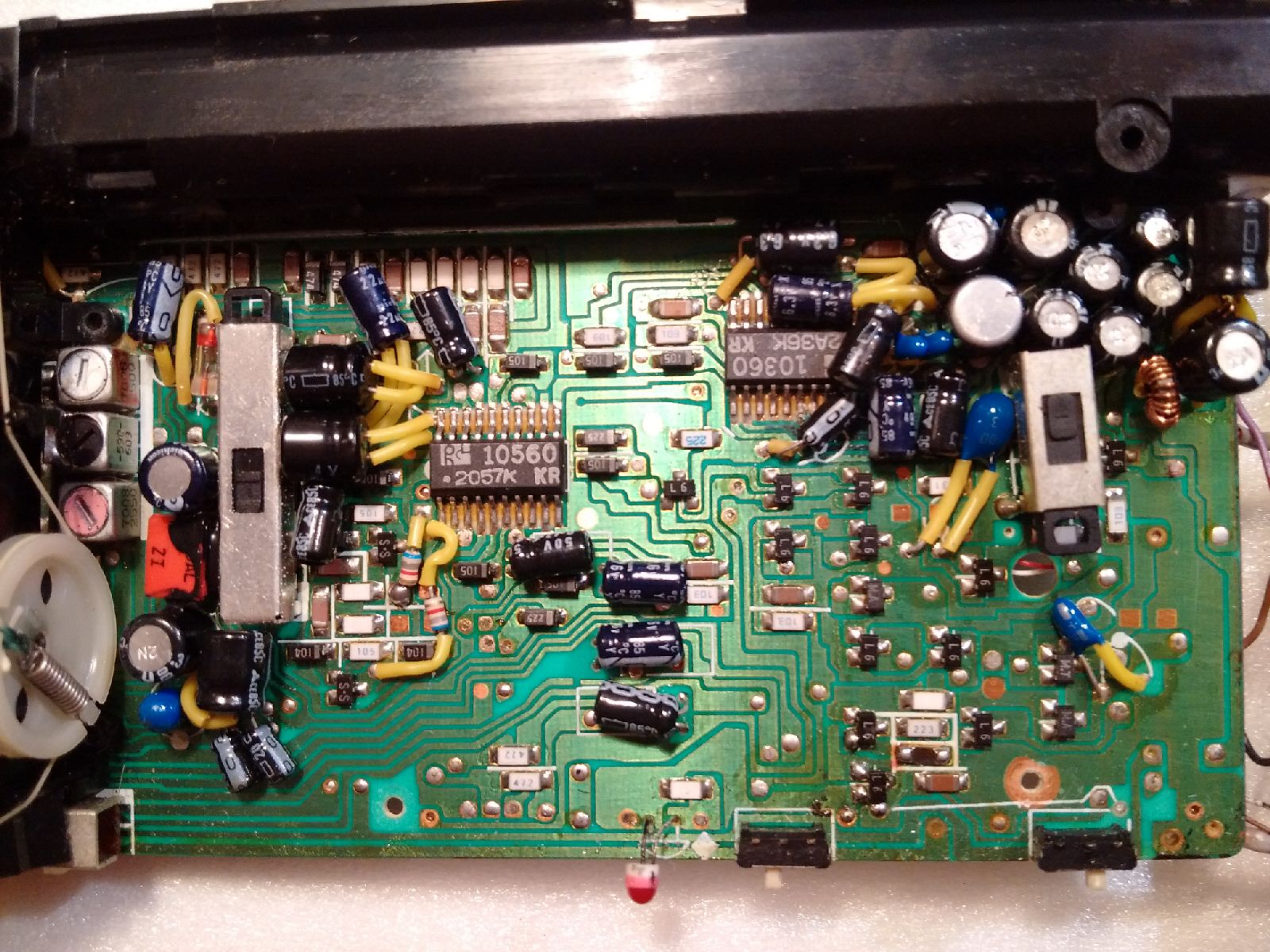

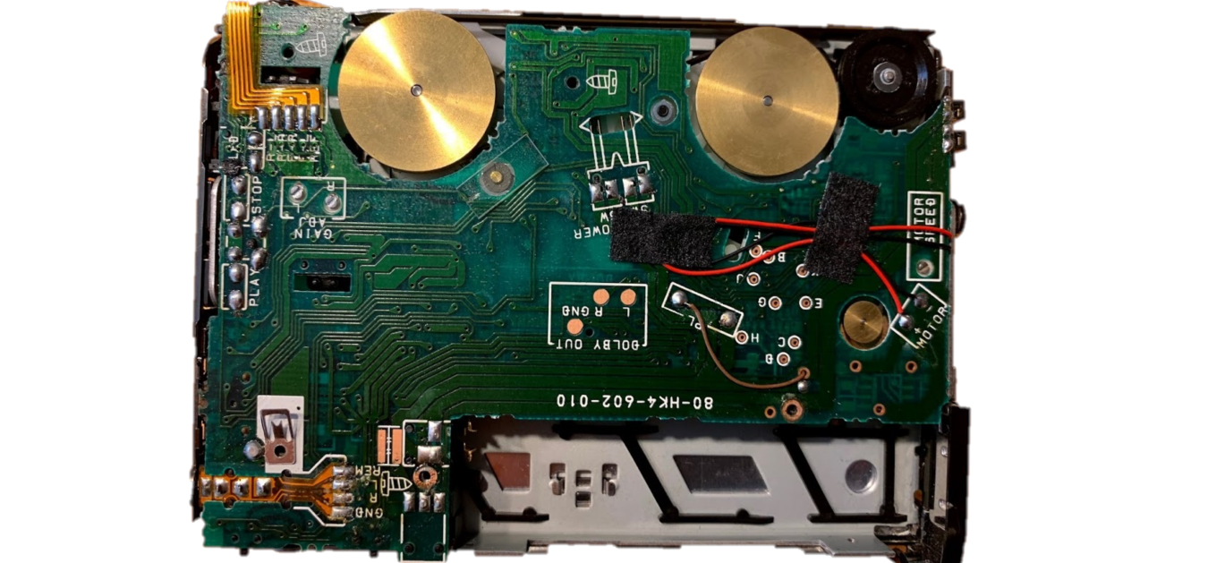

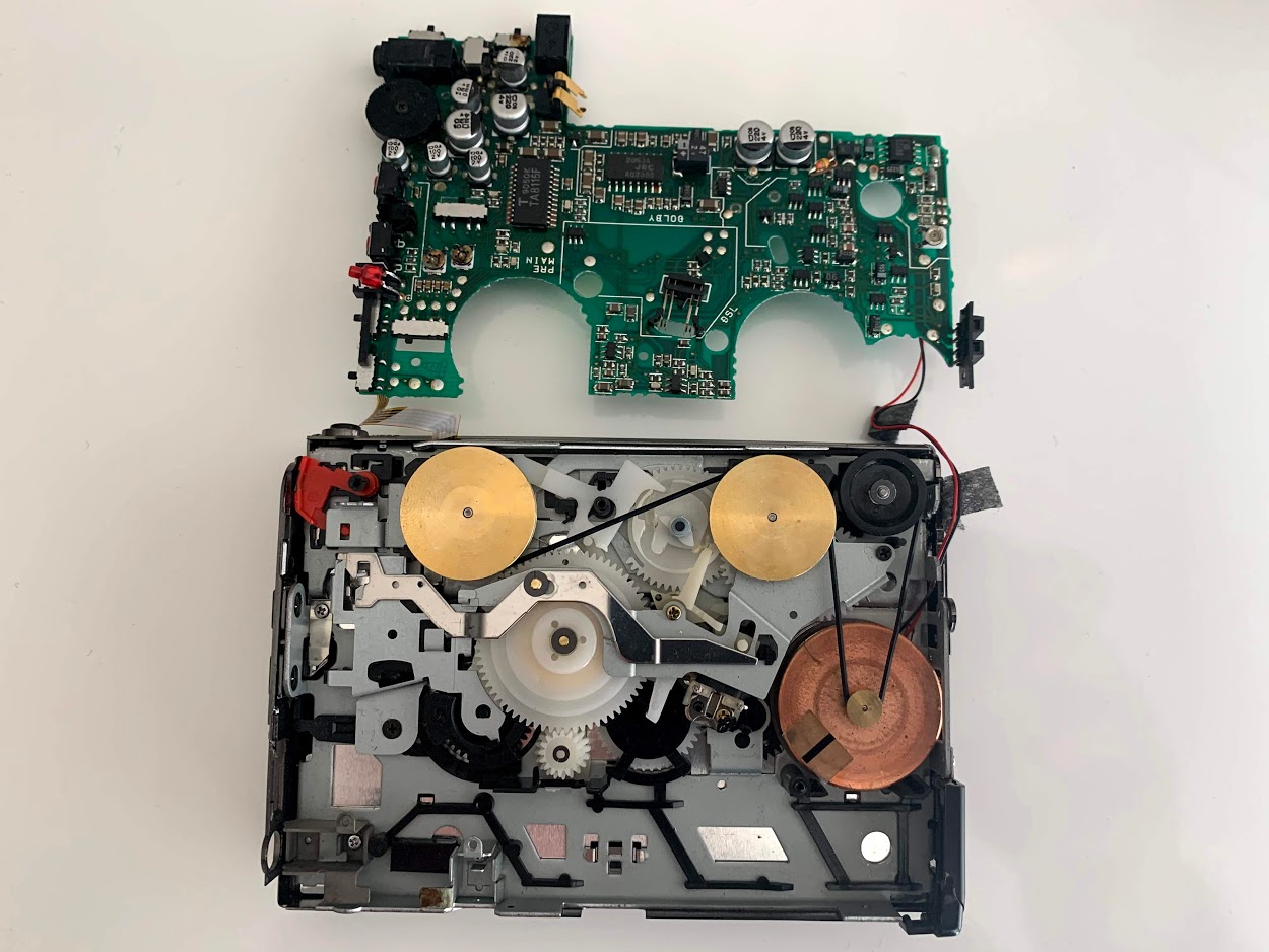

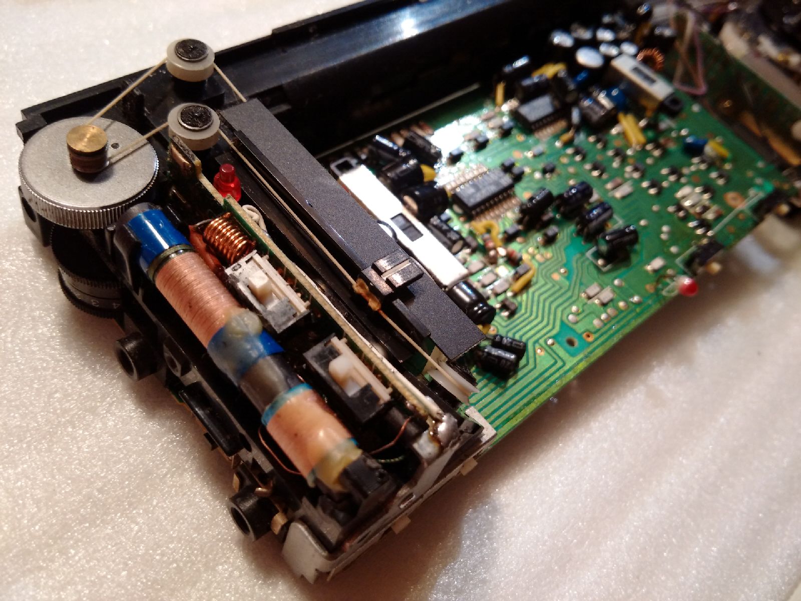

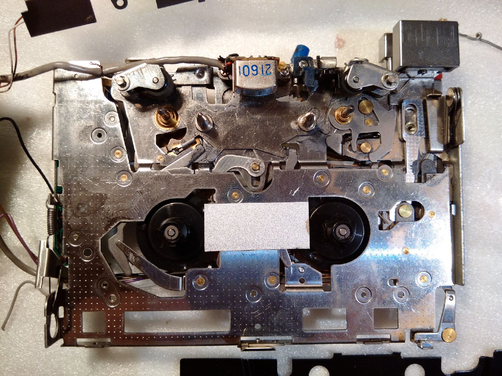

    17. Aiwa HS-J02
    Robust, heavy player /recorder, reverse, Radio, separate FM antenna.
    Not easy to change the belt, but worth it!
    Caps still ok, Machine just works!
    IMG_20170316_203702.jpg IMG_20170316_204228.jpg IMG_20170316_203915.jpg IMG_20170316_203924.jpg IMG_20170316_205147.jpg IMG_20170316_213557.jpg

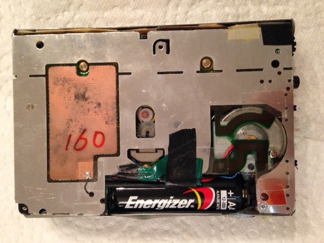

    Aiwa HS-P505 mkII

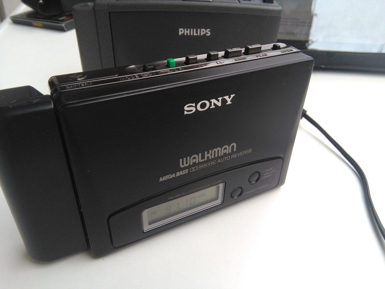

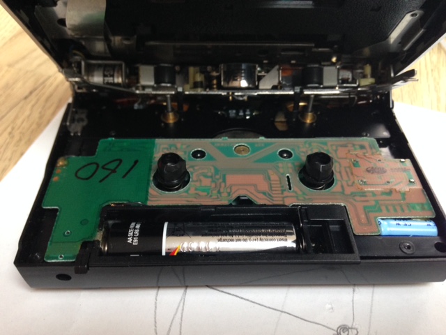

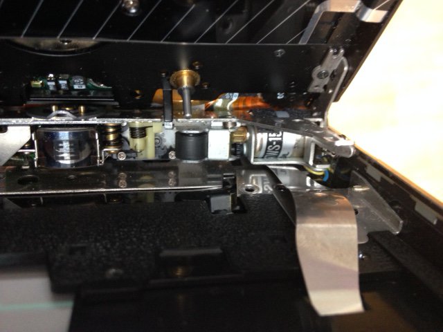

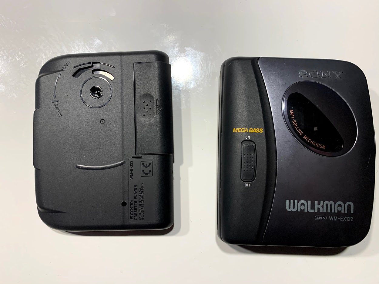

    Sony WM-EX122, a very basic model

    The Aiwa HS-P09 share the same mechanism (2 ME 7).
