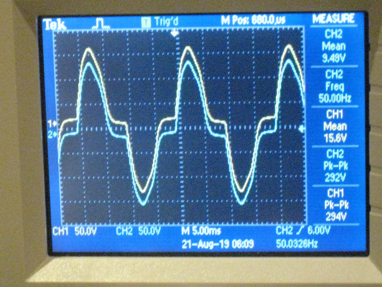

    It is unusual to find a pro walkman which is completely dead. A more common problem with the D6 and D6C models is that the motor runs too fast. In the D6 this is normally caused by failure of the CP602 potted motor driver module. In the D6C it is normally caused by failure of the CX20084 IC, which in turn is often caused by connecting an AC adaptor power supply with the DC polarity reversed. The DC barrel connector MUST BE WIRED WITH THE CENTRE PIN NEGATIVE.
    Also, avoid using any computer type switch mode power supplies. I have a D6C in for repair at the moment which was damaged by a Dell computer power supply. It measured 6V DC across the connector, when using a multimeter. When I checked the DC lines with the oscilloscope, there was a common mode AC signal (same on both +ve and -ve connections) of 292V Pk - Pk relative to mains earth (see attached image). I think this may have damaged the CX20084.
    If it is totally dead then you may have a dry solder joint or broken PCB track on the battery connectors or the DC input socket connectors.
    If there is no sound this could be a failed mute module or a damaged DC-DC converter. If the take up spool is not turning, the belt may have failed.
    Boodokhan, Jorge and Paul L like this.
