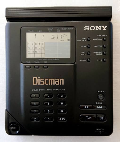

    I want to add some opinions about the SONY D-150 and D-250 Discmans, because now I have both in my collection for some time.
    In terms of sound quality, the D-250 is a significant improvement due to the 4x oversampling digital filter. The D-150 sounds pretty harsh in comparison, because it lacks any reconstruction filter, either analog or digital.
    However, both the D-150 and the D-250 sound considerably better when used with an external headphone amp (a difference in the favour of the D-250 still remains, which is to be expected), likely because of the additional filtering present on the input of a separate amplifier.
    Probably this is one of the reasons SONY included a LINE OUT on these models, because that's the only way to get the full potential out of tese Discmans.
    It is unfortunate that the headphone amplifier of these units is really good, but won't be used up to its full potential because of the "dirty" signal coming from the DAC.
    It is clear that the higher end models with 8x oversampling digital filter sound even smoother than the D-250. Of course, the best are those that have a digital output: this way a better external DAC and amplifier can be used, but from what I have read on the forum, there are only a handful which have a digital out.

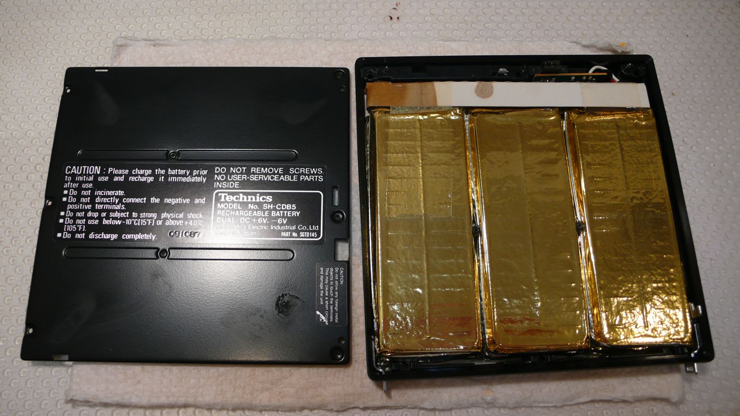

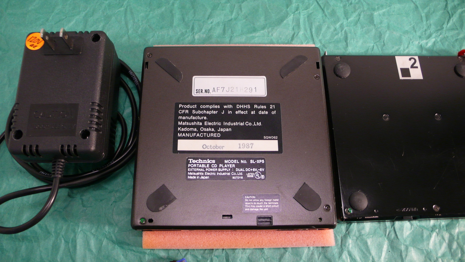

    Hi Jorge, your post interests me as I have recently acquired a Technics SL-XP5. When connected to its power unit it works fine but not with the battery. This is not surprising as it will be very old. You say it is repairable - can you give more info please.
  12. Jorge
    1,794

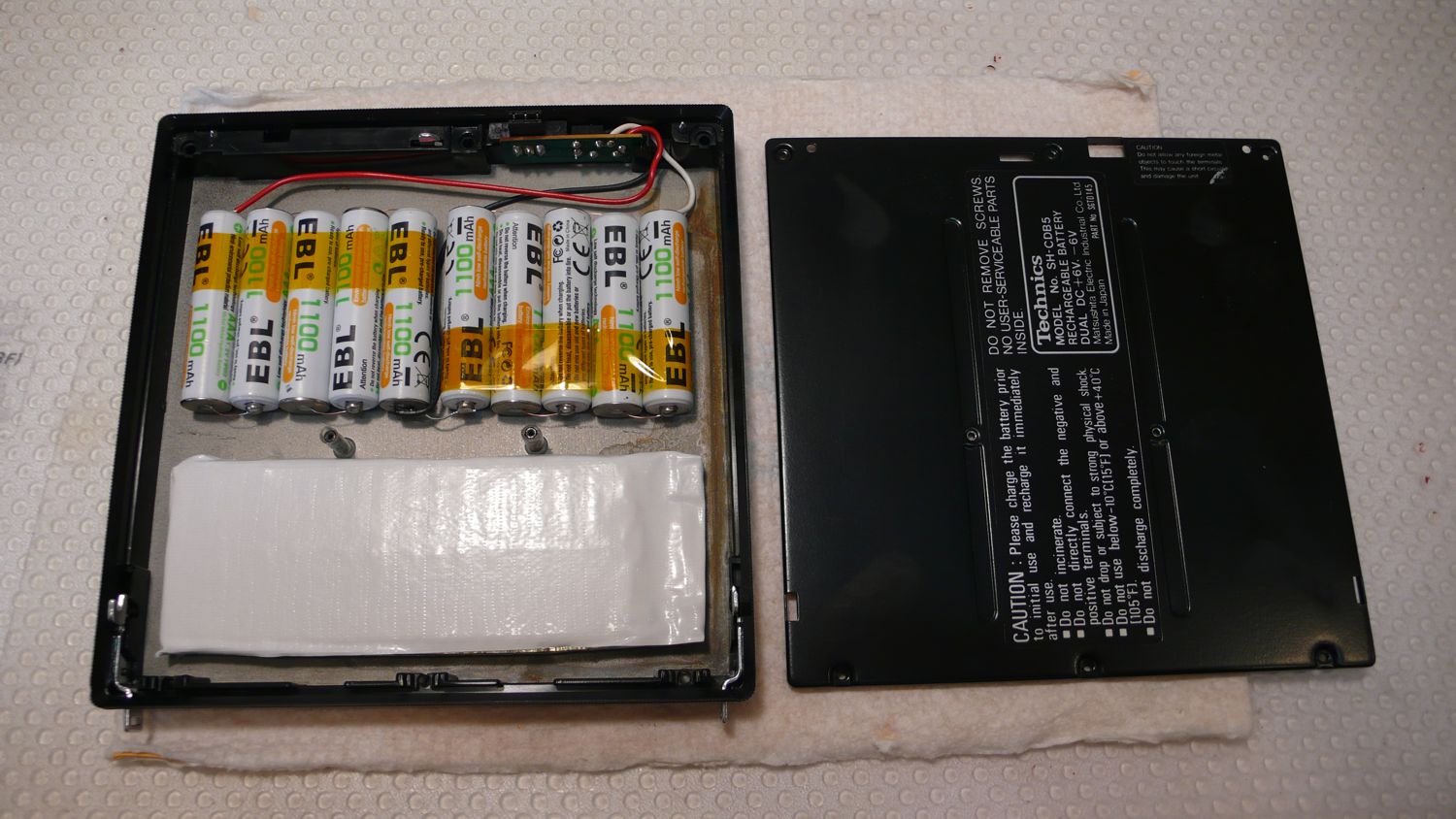

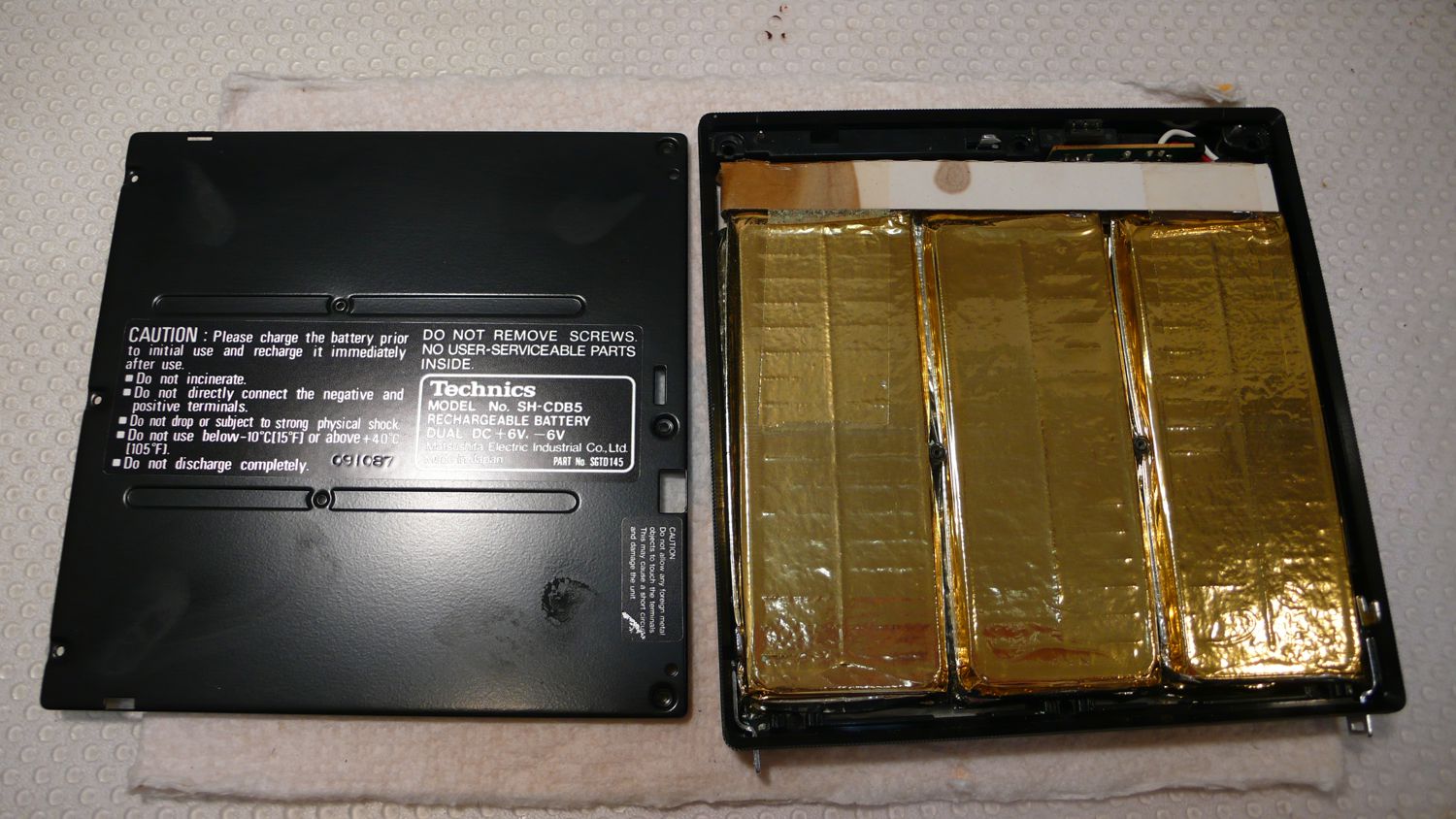

    correct, all batteries are dead and any attempts at rejuvenating old cells by injecting them with water or acid is a total waste of time! You have to substitute dead cells, the easiest (and quite cheap) way of dealing with this is by sending battery to Kaosun of kaosuncd.com. Extra pains and expenses for the 'US outsiders' so if you decide to DIY:
    Remove top plate:
    pry out dead cells, they are held together by tough double-stick tape, use strong flat strip of plastic or wood. Try not to damage the edges of the case.
    Ten 1.2V rechargeable AAA batteries do the trick:
    a piece of lead at the bottom is just to add extra weight. From full charge batteries last for about 2 hours of play. Second set of ten batteries will double that but will also double charging current going through the Discman. Kaosun offers that option but I prefer not to take any risks with SL-XP5
    my friend @hlpdt10 uses ten 1,200mAh gumstick batteries instead of 1,100mAh AAA, I have a photo but need his permission to post here

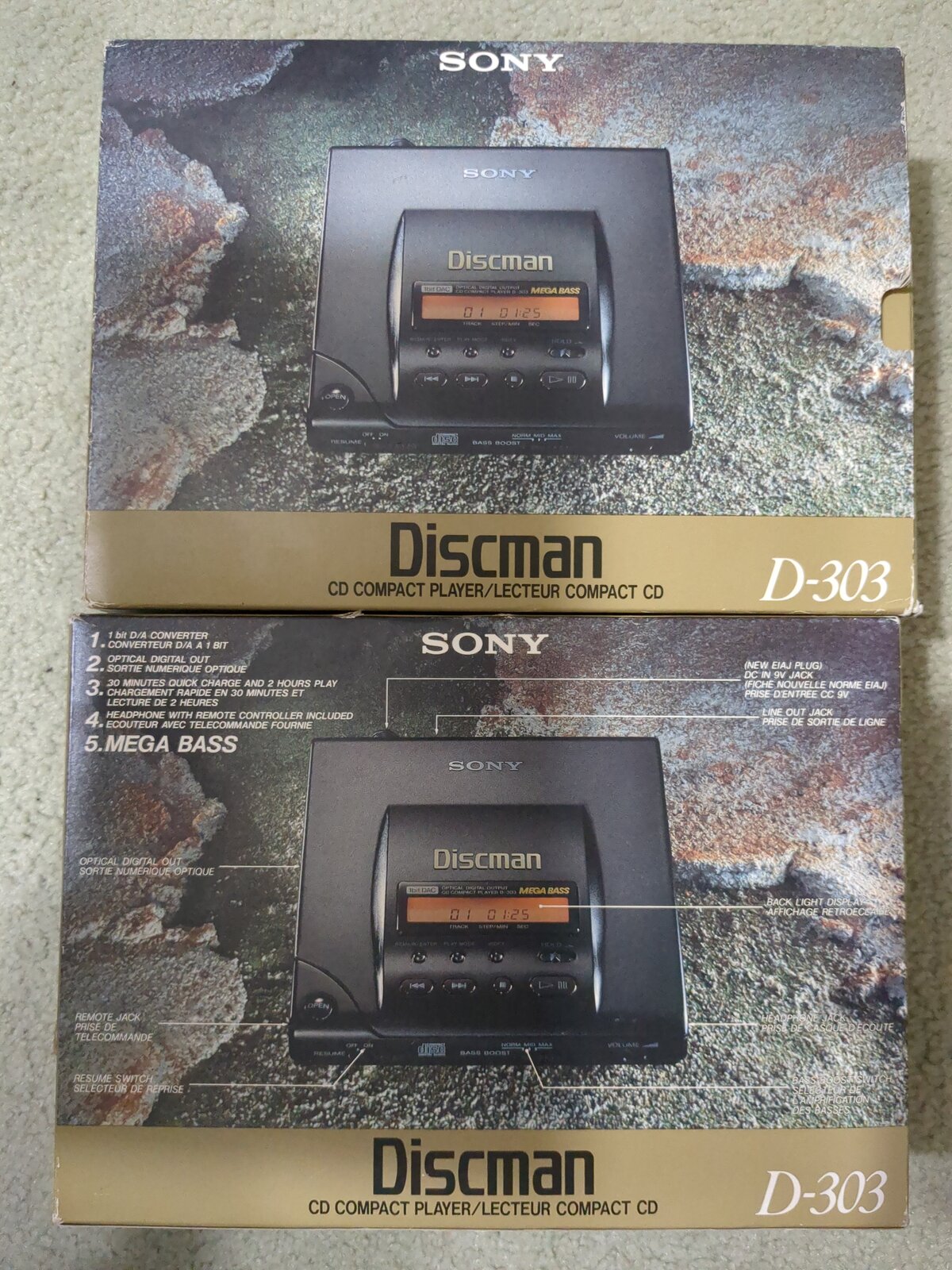

    In this discussion for the best?
  14. Jorge
    1,794
    My personal opinion - it is the best Discman with 1-bit DAC. Boxed units sell for crazy $$ to those who still believe that 1-bit DACs is the best thing that happened to R-2R multibit DACs. Proves, once and for all, that we all hear differently and listen to different things!

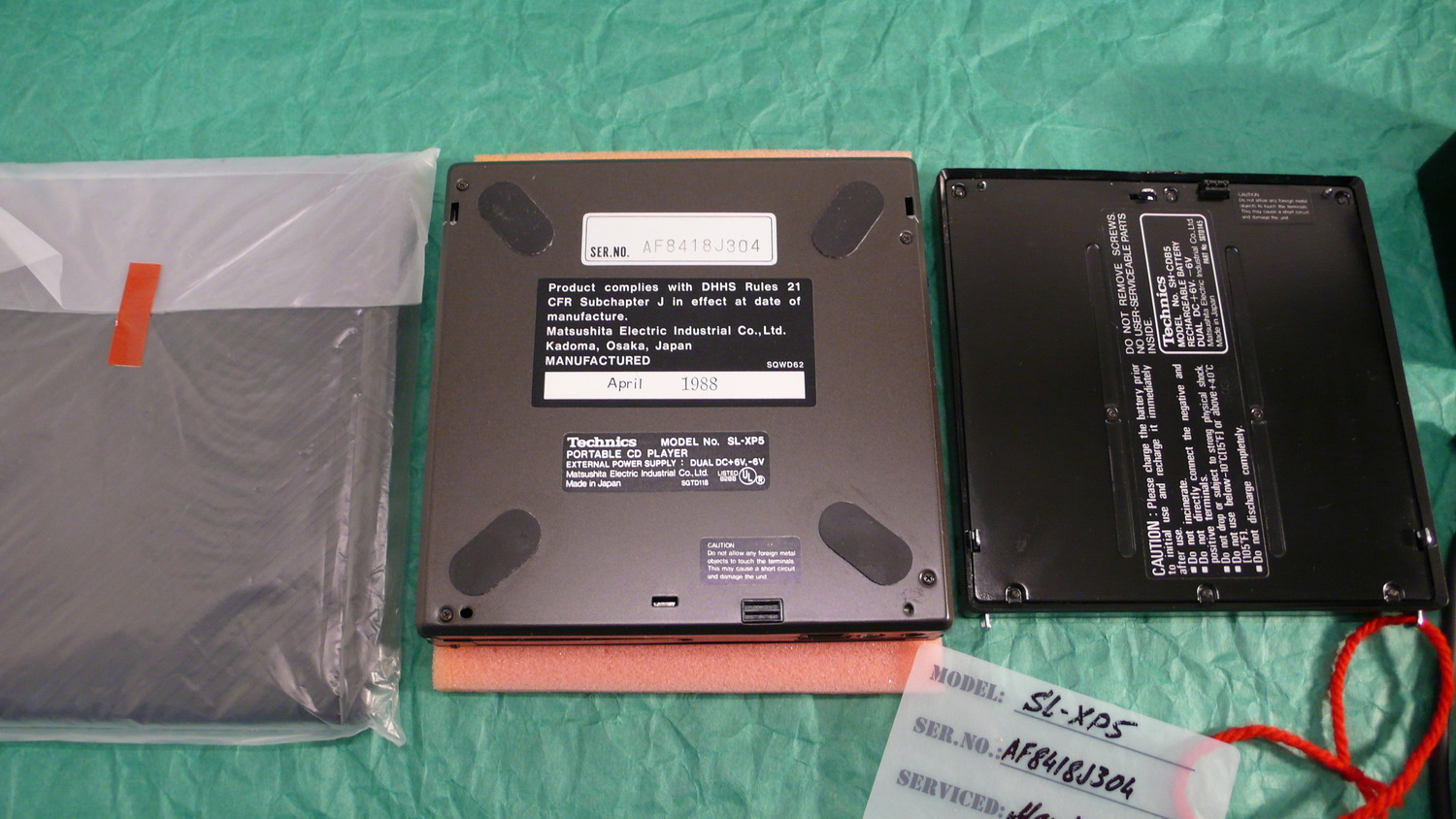

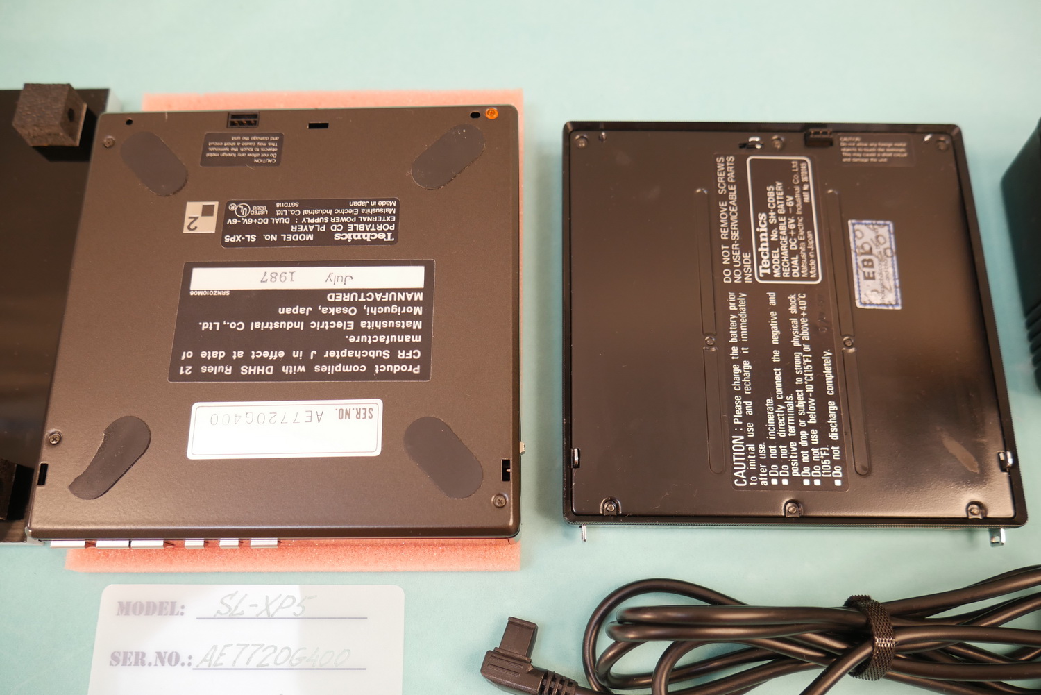

    Thanks Jorge. That doesn't look too difficult. However the problem I have found is that I can't separate the battery from the player. The unlock switch seems to work but the battery seems to be stuck to the player chassis. I don't want to use force so any suggestions.
  17. Jorge
    1,794
    happens often, Very Often!! :( Rubber pad(s) from the Discman fuse with the pained battery plate. Brute force won't work, and you have to separate them with minimal damage to the pads.
    these are the pads, oval shape and as you can see I managed to separate battery without any damage. Although you can see discoloration to the battery paint
    Another SL-XP5, here one of the pads got torn, its piece is 'welded' onto the battery:
    and yet another SL-XP5, here all four pads fused to the battery very badly and had to be cut off:
    To separate Discman from the battery I use old Credit Card with edge cut at an angle as a chisel. Evidently, point the tip of the 'chisel' towards the battery, you do not want to separate pad from the Discman.
    As always, you can use something like these Cell Phone Screen opening Tool
