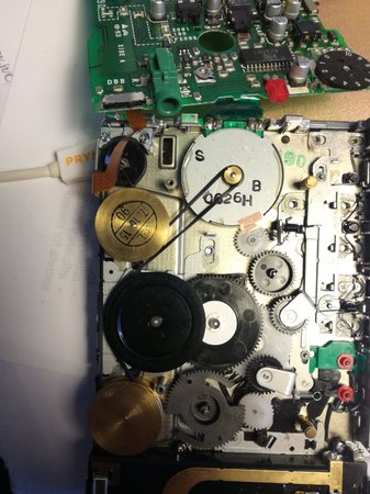

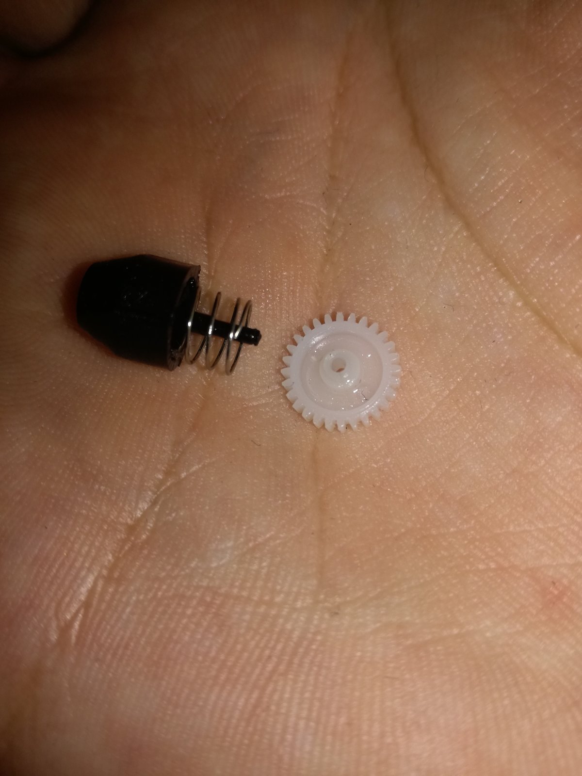

    You guessed it. The spring mounted gear on the other side flew off. Thankfully, I found it. I have no idea how to put it back without putting the "S" like gear under tension. It's the white gear in the picture below.
    Does anyone know how to fix it?

    Repairing this type of mechanical can be a nightmare.
    You should dismount even the clutch, but be careful, mostly the small gear on the clutch is broken, also not easy to fix.
    Have a look below this S-like thing, there is a very small spacer, also often broken.
    To avoid that this Gear again get off the axle use some glue, also on the same Gear on the other direction.
    I stopped looking for WM with this mechanism because it’s not very reliable and as mentioned, hard to fix.
    If the clutch is still good you should be happy and give it a try.

    The problem with the falling spool is very common with a lot of Toshiba "Walky" units. All Toshiba walkman with FF and REW mechanism installed on their spools have these annoying problem.
    What model is this walkman? I tried to zoom on your picture to see the cracked gear but couldn't find it

    I don't think the gear is cracked. It's a wm-190.

    Also by clutch do you mean the black thing with the wiggly ss shaped thing that pushes on a metal hinge? That thing looks unbroken but off-center from the center of where the white gear fits. I can push the white gear in place through the gap of s gear with a bit of pressure.

    On this S like part is a small spacer, the white Gear is mostly ok. So remove the big wheel from the belt and the clutch and you will see what I mean.
    When the Gear falls from the axle and this spacer is broken the reassembly of the Gear is difficult.

    Alright followed through with the whole document. My clutch gear was broken. But now it's fixed. I'll need to purchase new belts for this walkman, hopefully I won't have to change the capacitors, through hole soldering is within my realm of competence, but SMD? No way.

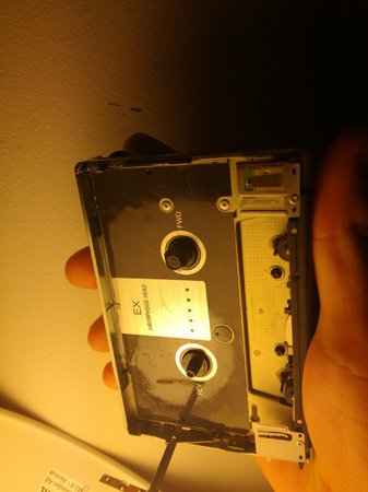

    Alright After lots of testing, i can confirm the wm-190 is more trouble then its worth. using my caliper It seems that the distance between the 2 screws for mounting the head on the aiwa and sony head are extremely close. this seems doable for sure.
    For fun I also measured the screw mounting hole distance of the ex head and a WM-DD head. The distance is visible, the DD has a larger screw mounting hole distance for sure.
