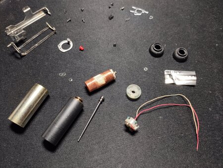

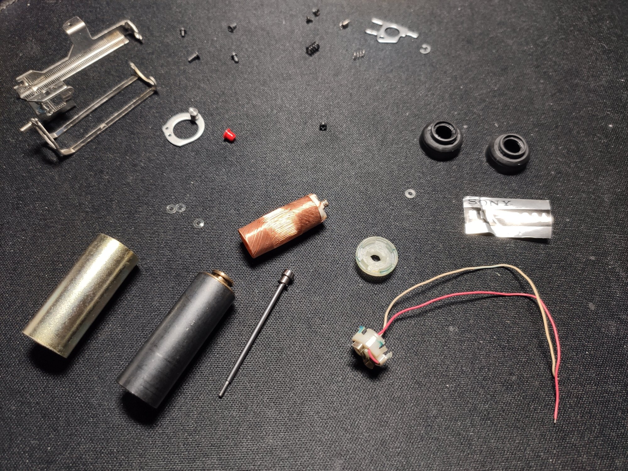

  3. Valentin
    1,999
    The very thin white washers I think 3 are on the top and 3 on the bottom. Then there are 2 thicker ones, one on top one on bottom.
    Main idea is when you look at the interface between the pulley and bushing, you shouldn't see a stack of washers.
    See the 2 attached pictures, on mine you can clearly see the 3 washers and another 3 which are put on top of another.
    Also in your own previous picture, it looks the same: 2 of the washers are stuck together hence why it looks like there are only 2.
    Note the DD motor in my picture also has a C clip near the spindle, the MNF1600B doesn't have that.

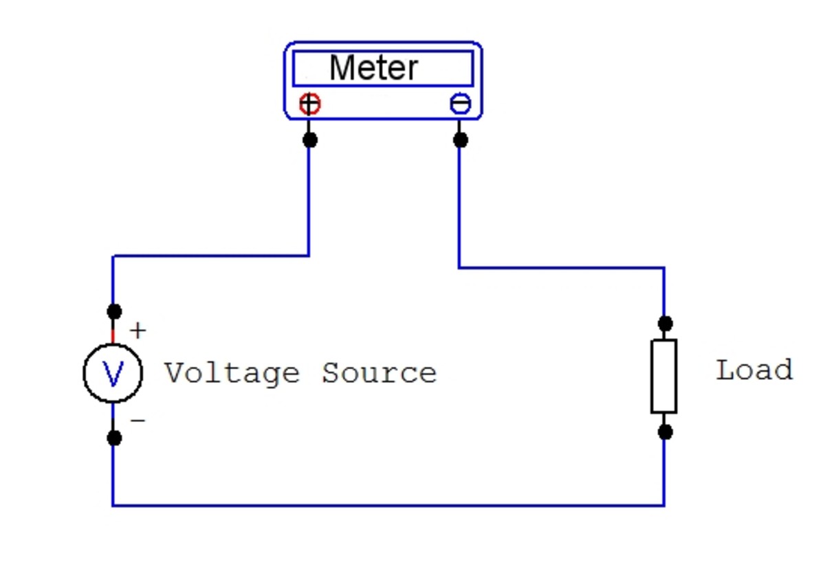

    Valentin, you have once again kept this project on track and moving forward, for this I am very grateful. I rotated the back plate and the motor sprang to life, all is looking good. So it appears that the last step is making the adjustment to the current consumption. In an earlier post you said "One needs to power them using a bench power supply (1.5V) or measure with a multimeter and observe the current consumption. Then rotate the back plate with brushes (while the motor is running) until the consumption gets to a minimum (it should be around 10-20mA)." It would be helpful if you could add a little more clarity to how I proceed with this step. I may have access to a power supply, and I do have a multi-meter, so far I have just been using a single AA battery when testing. It is not clear to me where to measure when I rotate the back plate.
    Thanks!
  8. Valentin
    1,999
    Glad to hear you got to the last step !
    For current measurement, you need to put the multimeter in series with the motor. See picture attached, load in this case is the motor itself.
    Note you will need to move the positive lead of the multimeter to the mA jack for current measurement.
    Given you use a AA battery as a power source, it would be useful to solder some wires to the battery terminals.
    If you have an adjustable power supply with current reading, it would be easier to power the motor directly from the power supply and read the consumption there.
    Depending on the supply you have, you may only have 2 digits after the decimal place, so you'll only be able to read in increments of 10mA. But it should be enough to do the adjustment.
    Alternatively, you can put the multimeter in series with the power supply for more accuracy.
