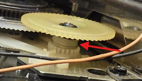

    We have been working and have almost everything working except for the fast forward the lower gear is not catching onto the main gear any thoughts help ? 20250708_201454.jpg

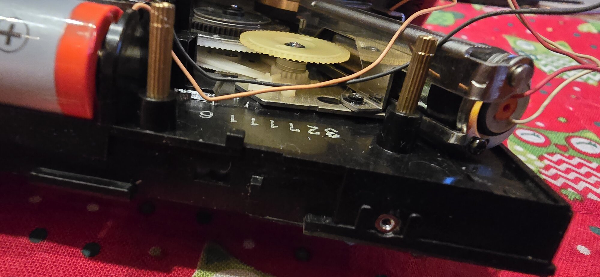

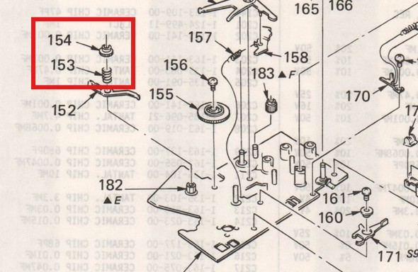

    The spring should be installed under the FF gear.
    Emiel, Medic395 and Valentin like this.

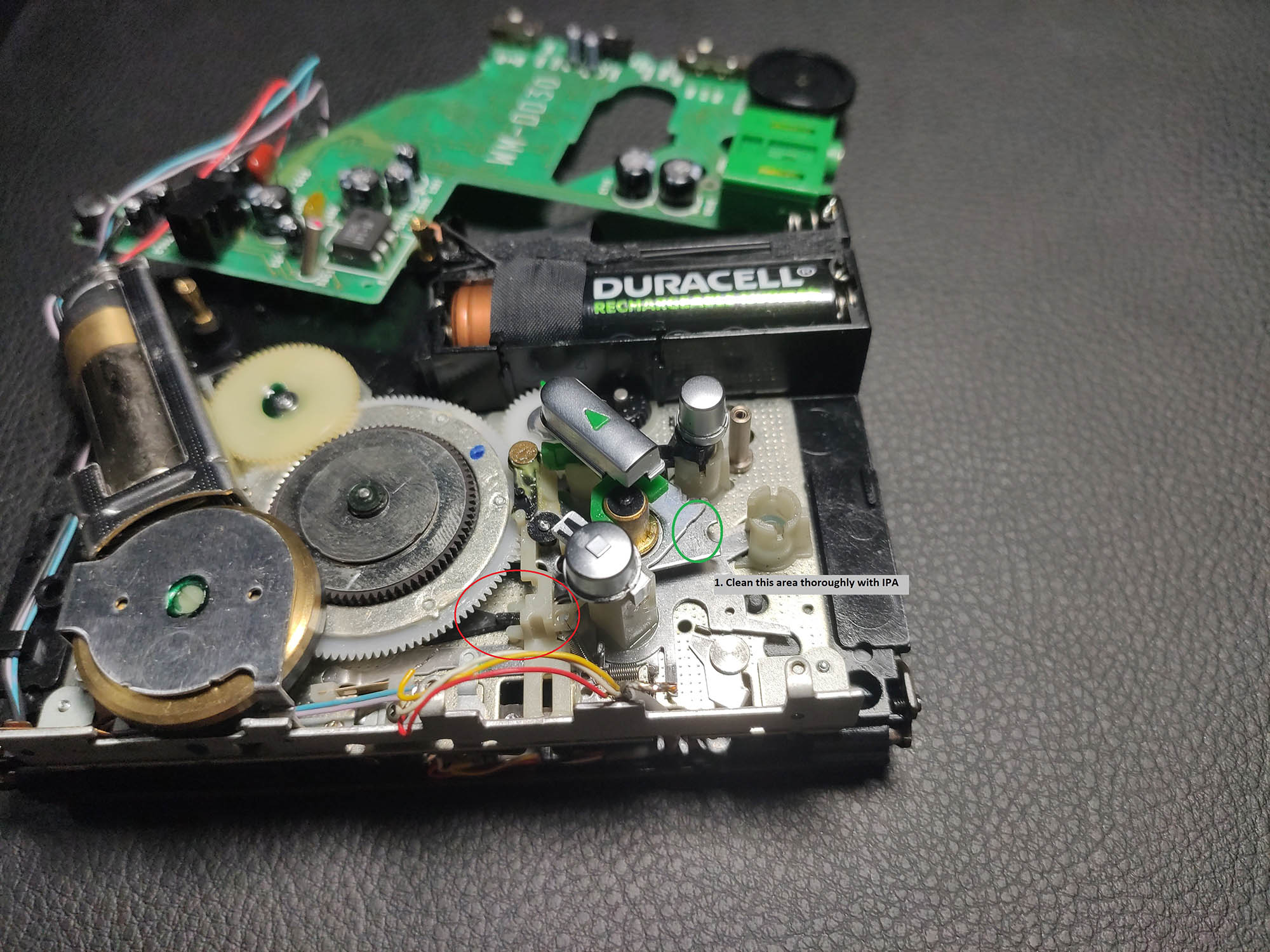

    Thank you, we have that in the right place now, ty . Now, to the auto reverse which is making noise and not staying engaged . My step son purchased this unit as a repair unit we've replaced all the gears and tape counter belt which I was surprised how deteriorated the belt was it was a paste .lol but it does work otherwise and plays cassettes now.
  4. Valentin
    1,956
    In regard to auto-stop making noise, double check the black lever is installed inside the plastic slider as shown in picture attached. Ignore the green marking, pic is from a tutorial.
