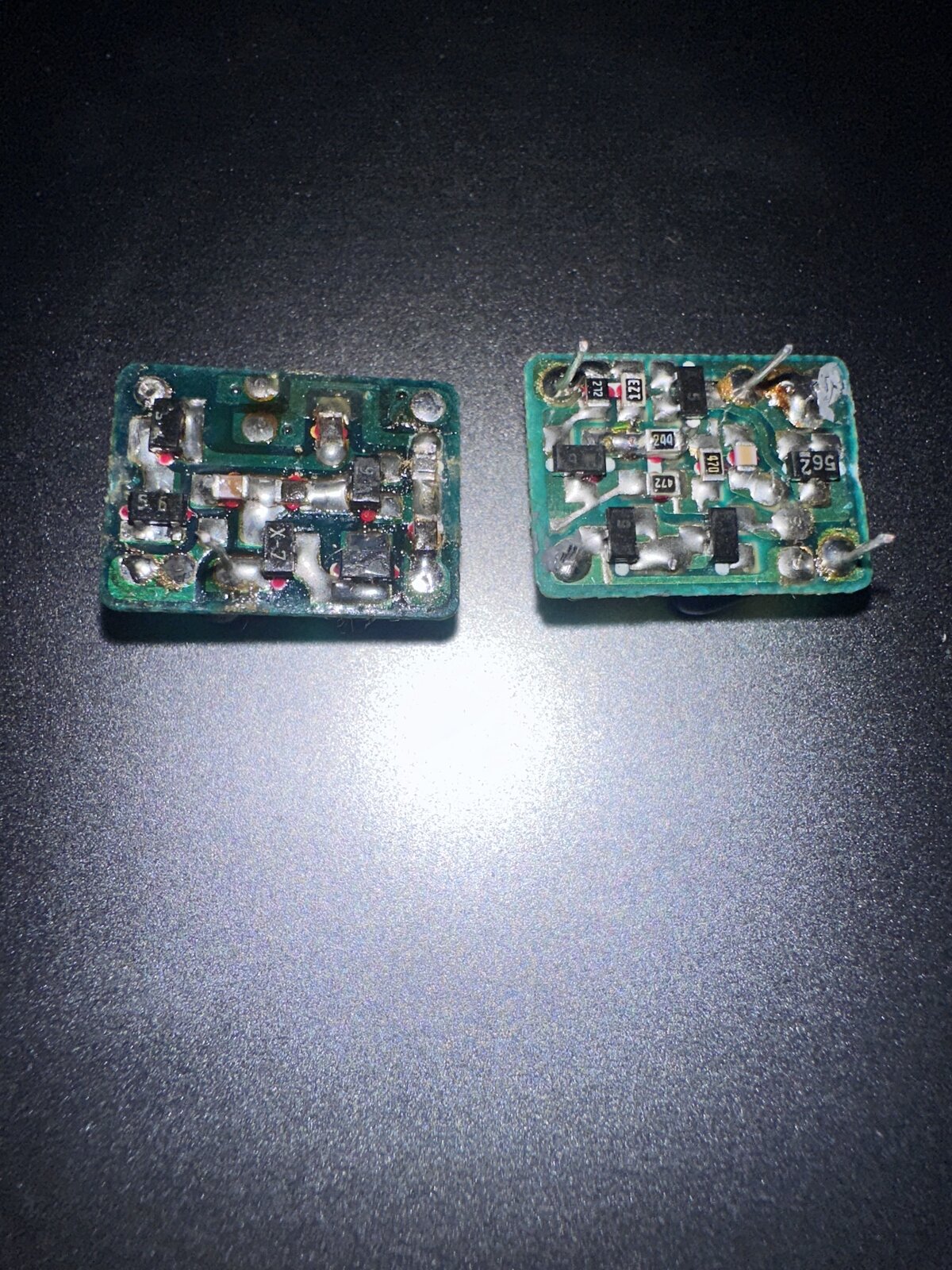

    I've repaired several players but I've never worked on a WM-D6/D6C until now. I have a D6C and D6 I want to work on and was looking for some assistance. Really appreciate any help.
    Before testing players I checked the battery holder was not giving more than 6v. Tested both players with a 3.5mm to cassette adapter and they have no audio. Also when stopped the motor continues running on both. I checked the DC-DC convertor and they both have no 11v output.
    I unsoldered both convertors and opened the metal shielding to find burnt components. On the D6C the tantalum cap is burnt. On the D6 it's the inductor that's burnt.
    Questions:
    • Since the DC-DC convertors are fried will there be other chips that are also fried?
    • If I replace the burnt components on the DC-DC is there a chance the player will work?
    • I found the DC-DC repair guide. I will replace the tantalums, inductors, and the transistor. On the guide they show which transistor to replace but the chip I have from the D6 is slightly different. Should I replace one of the transistors on that one as well? If yes which one and what is the value? (I attached a picture of both chips. D6 on the left and D6C on the right) IMG_9883.jpeg
    Thanks!
  2. Valentin
    1,956
    If you want to be sure, check the continuity of the transformer coils with a multimeter. It can go open-circuit, although not common.
    Apart from the input tantalum, input inductor and switching transistor there's nothing else that gets damaged.
    So best course of action is proceed in replacing those components.
    febrice likes this.
